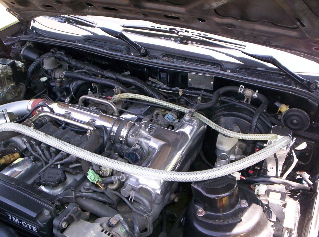

here is the way i rooted mine notice the carb fule filter it made of glass and stuff full of white breath filter cloth
it's on the turbo side click on it make it bigger pic
feel free to look at the rest of the pic's as well
