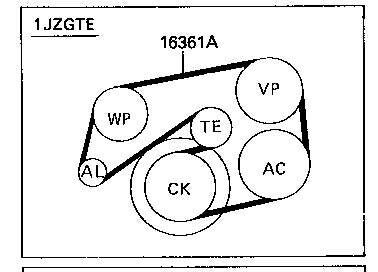

What would be best solution? Alternator relocate? Second idler pulley? Drink a lot of beer?
garagefujimoto Local Tire Destroyer May 27, 2005 997 0 0 45 Calgary, Alberta, Canada Mar 12, 2012 #1 What would be best solution? Alternator relocate? Second idler pulley? Drink a lot of beer? Attachments 1JZ_Serpentine_Belt.jpg 15.3 KB · Views: 1
IBoughtASupra New Member Mar 10, 2009 4,455 0 0 Queens, NY Mar 12, 2012 #2 JZ link in my signature has the info you need.
hvyman Dang Dude! No Way Man. Staff member Apr 17, 2007 12,568 2 38 Fullerton,CA Mar 12, 2012 #3 A small idler pulley where the ps pump would be.
garagefujimoto Local Tire Destroyer May 27, 2005 997 0 0 45 Calgary, Alberta, Canada Mar 12, 2012 #4 IBoughtASupra;1815625 said: JZ link in my signature has the info you need. Click to expand... Looks like I was thinking the same as you. Put the 36100 ribbed pulley on the tensioner and make a circle routing of the belt and be done with it?

NecroCyde Lurk R Apr 5, 2005 221 0 0 41 Calgary/Brooks, Alberta Canada Mar 13, 2012 #5 Have you seen this? http://store.driftmotion.com/static/i-1jz2jzserpentinetensionerpulleybeltnoacorps.php Includes both pulley and belt. Few pics to give u an idea.
