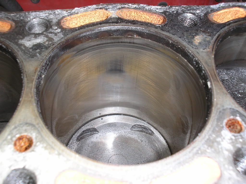

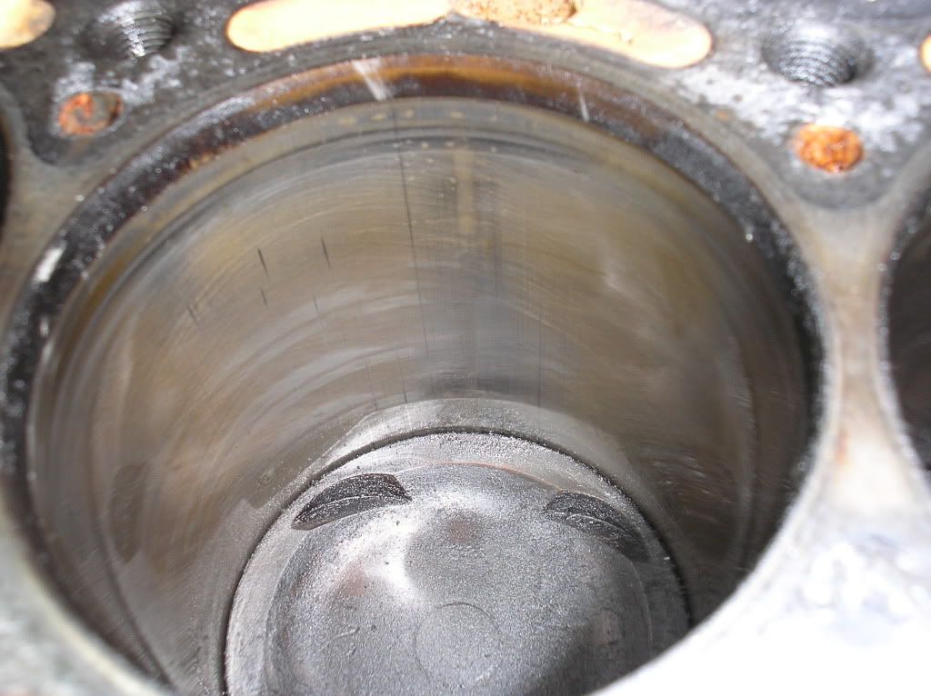

Thanks for all the responses, it seems cars with my symptoms were generally in the very early stages of blowing the Head Gasket. I did decide to pull the head after testing everything else in the cooling system. After verifying the correct operation of all components it was clear the water loss and loss of coolant pressure when the car is just coming off the track could only have been coming from the head gasket. When it came time to pull the head I was expecting some loose head bolts, but there were non. I was also expecting to see some damage to the firing rings but there was also no damage there. There were a couple areas away from the cylinder that didn't look perfect so I am guessing under the stress of the track I was forming a small leak and my cars symptoms confirm this.
Right before the head came off I did check compression, it was like usual 175 across every cylinder + - about 2 lbs. I have tested the compression 4 times on this motor and it has always been within just a few psi for all cylinders.

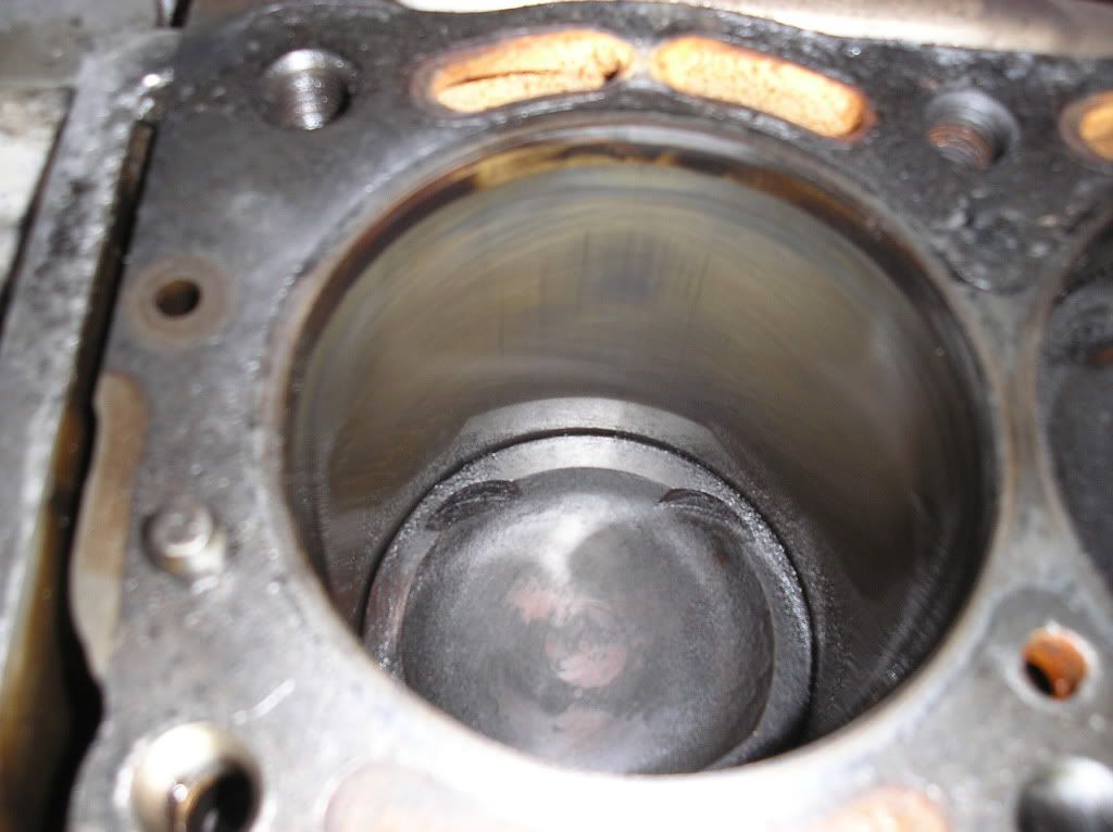

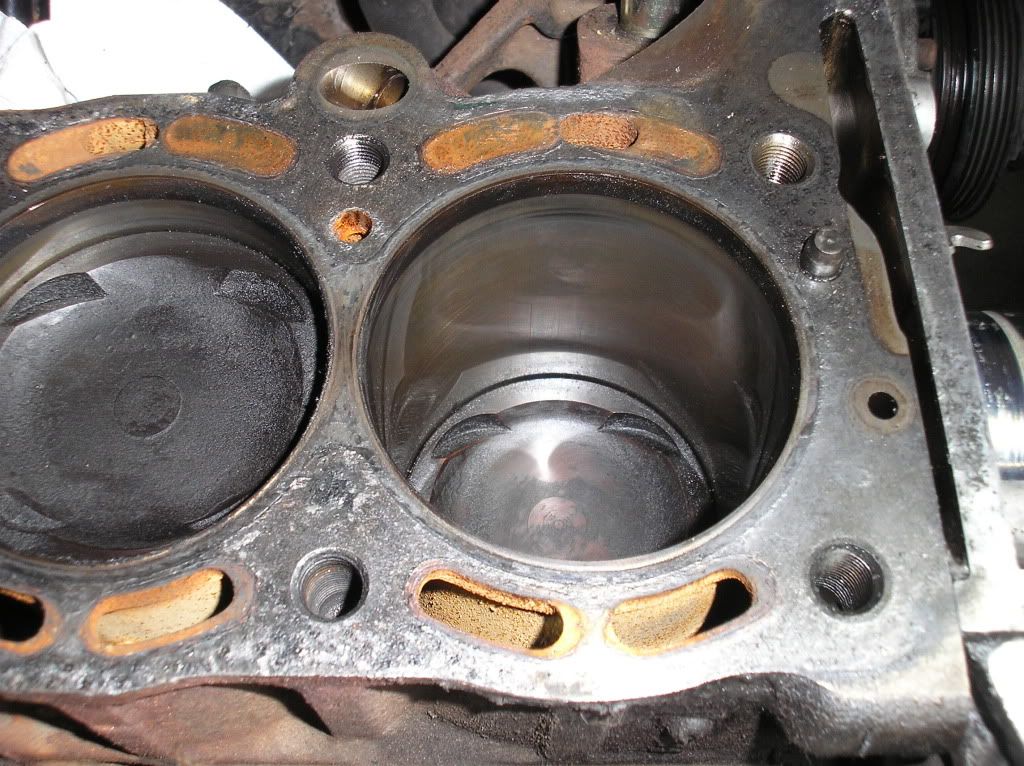

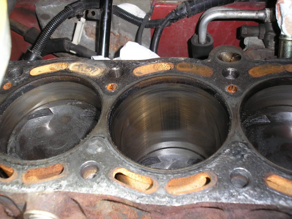

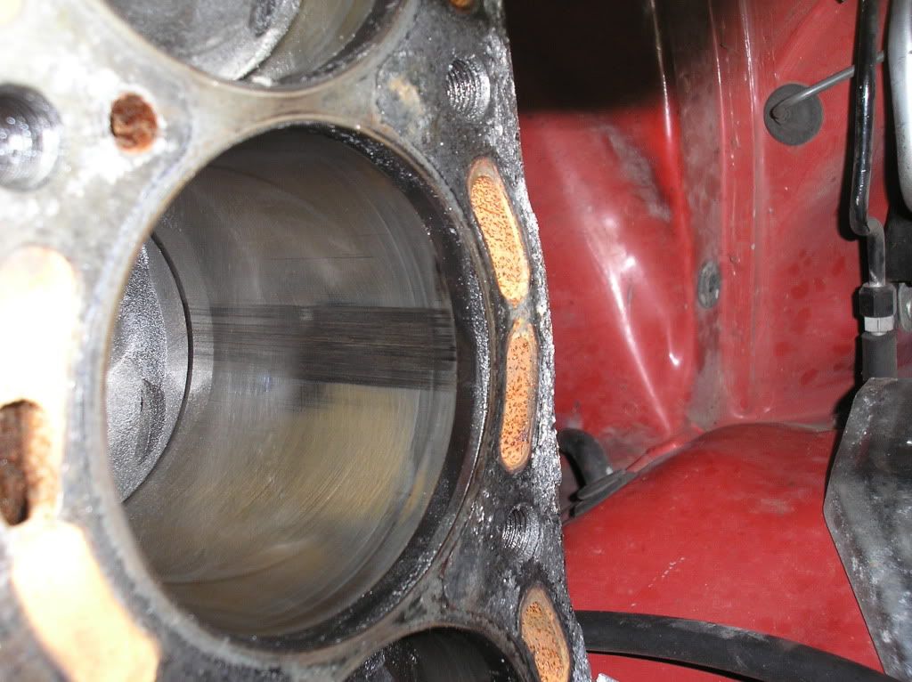

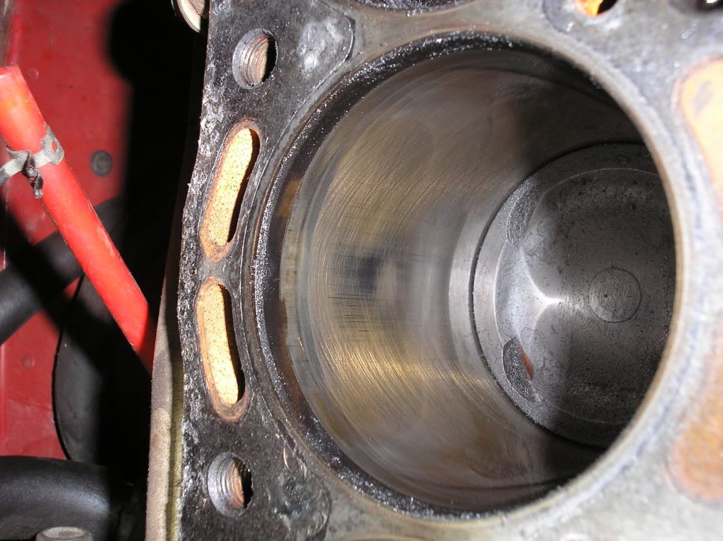

HOWEVER, after pulling the head I noticed that I had some scoring on my cylinder bores, in fact 5 and 6 had about 1" wide scoring perpendicular to the wrist pin location on the piston. The scoring is at least partially started in near the same locations (perpendicular to wrist pins and through the entire length of the bore) in each cylinder and it seems like it is on both the intake and exhaust side (which side is worse depends on cylinder). I can feel the scoring but my nail does not catch on it. I can verify that the cross hatching is gone in certain locations of the cylinder wall. Right now i am thinking its time to pull the block and freshen it up as well, however I am wondering what others think about it. Hard to believe what I am seeing considering the car has always had such great, even compression since I have owned it.
I will take some good macro pictures of the cylinders today and get them posted up in here. Any advice is appreciated, calling on IJ :)

Stock? I really don't know, as far as I know I bought the car with 80k miles, head gasket replaced, bottom end never touched.

Here we go, here is a link to more
http://s327.photobucket.com/albums/k463/supradjza80/
6 drivers side
5 passenger side
The rest

It doesn't look that bad.
Based on how well the car ran/the compression test conclusions I think it would be fine to clean the block up really good, mil the head go OEM HG with ARP studs.
What are your plans for the car? nothing too crazy right Dave? lol

Right, my plans are nothing to crazy for this car since I am looking at mk4's to ADD to the garage :). But If people thought it was worth it to pull it right now and have the block and head done, I thought I would just do it. Waiting to hear what Mr. Grumpy has to say about it:naughty:
64
Damn....
Come on guys "doesn't look that bad" WTF are you smoking... :nono:
Dave: My educated "guess" after trashing my 7M in much the same way is it's a combination of lean and high AIT that's ran the cylinder temps high enough to close a couple of the ring end gaps :(

hmm, my wideband has never shown anything above 11 under boost, and based on the fact that at least all cylinders are beginning similar wear marks it looks like they would all be suffering similar fates. Well I will pull ii out and see what we have. Based on the head gasket firing rings having no damage I thought it was unlikely that detonation was a cause.
IJ, do you recommend ring end gaps which are larger than the factory manual suggests? Wouldn't you expect low compression on the offending cylinders?
64
I do the old school 4 thou per inch of bore top and 5 per inch 2nd and if I'm running the engine hard I add another 4 thou to the total and so far so good.
You appear to have caught it right at the start and it doesn't look too bad as far as closed gap damage goes so the comp figures would probably be okish, mine was a real hard pull to 8000 and when I pulled it down the Plug ground was gone and the ring was about half as wide as when it went in and the cylinder was trashed totally :( (brand new block)
Do you have any way to log AIT's?
