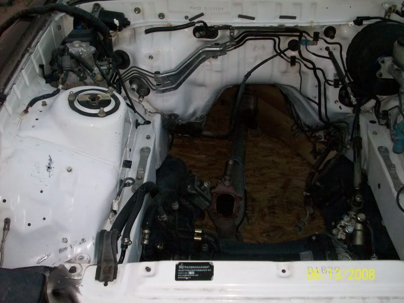

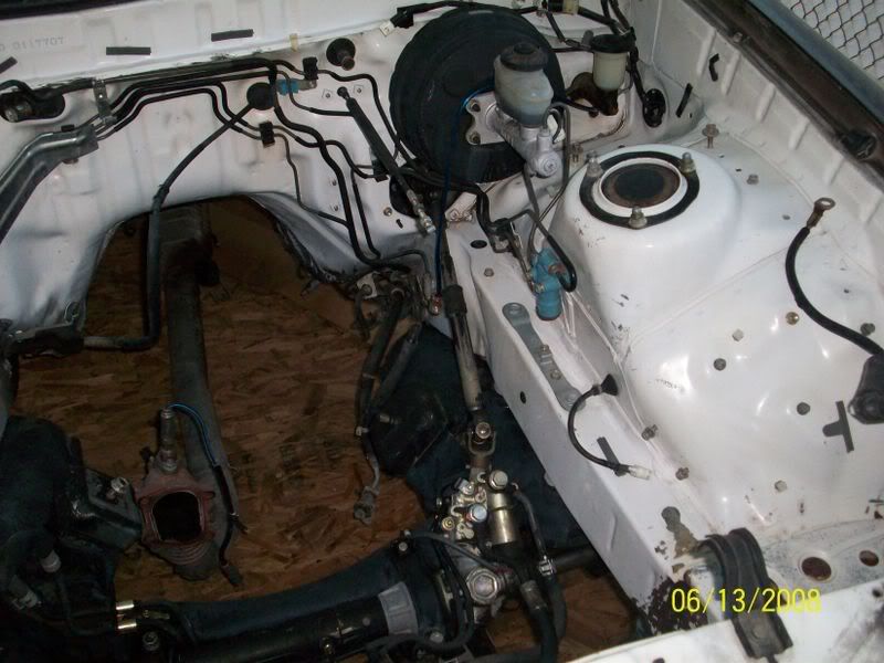

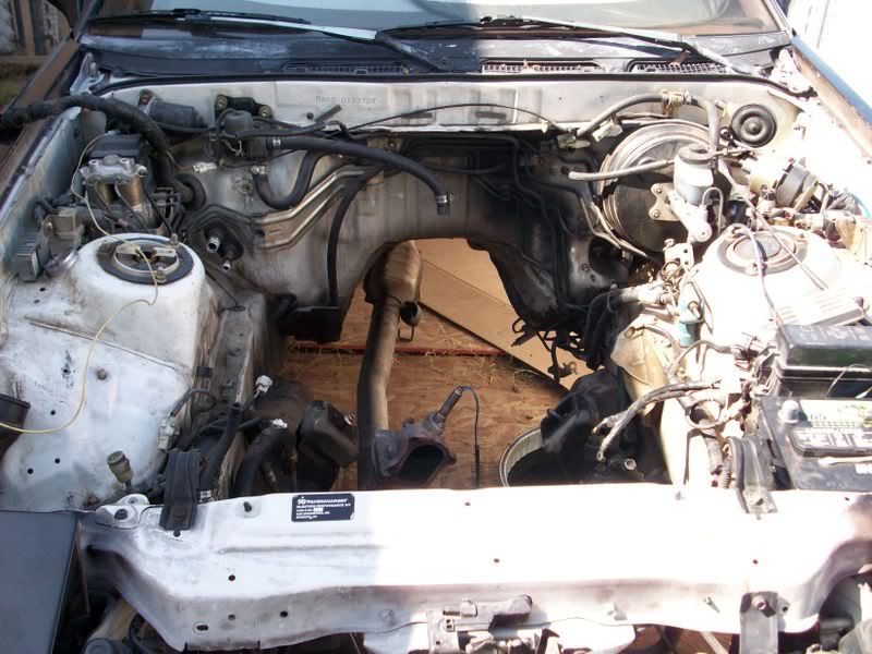

Now last weekend i spent a good deal of time of preparing the engine bay so that i can pull the engine soon.
Here's how it went down.
disconnected the wire harness, took out the radiator, took off the intake manifold (top half), disconnected the turbo from the exhaust and intercooler, pulled the alternator off and disconnected the fuel lines from the fuel rail. I may have missed somethings but all i got to disconnect is the power steering and oil lines. Luckily the AC was missing (gives an excuse to use the targa :icon_razz)
Here's some pics
Heres the wire harness disconnected
Here's it without the intake manifold

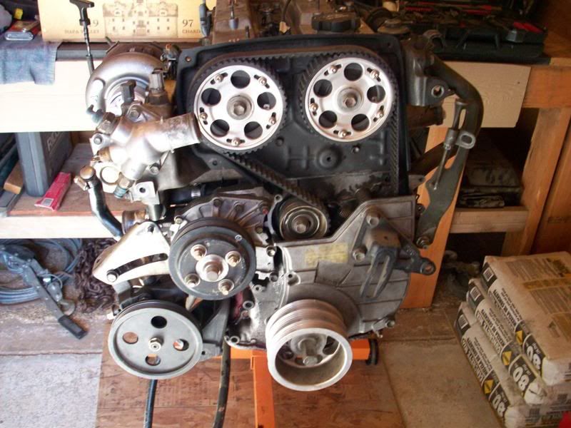

Couple days ago I made a little more progress under the hood and got everything disconnected from the engine so that it is ready to pull. Also took out all the A/C components since the car didn't have the A/C on the engine. Call me crazy but I'm not to worried about the A/C it doesn't bother me not having it, and it will give more air to the radiator with the A/C core out.

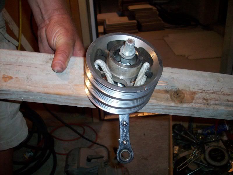

gurley0916;1031689 said:
i didnt put it on whats wrong with it?
It does not have a rubber dampening in it, it is not balanced with the crankshaft and will shake the crank so bad it will wipe out the bearings. You are better off with the stock pully.
I bet you thats why it developed rod knock! Thanks guys i will remember to change that out.

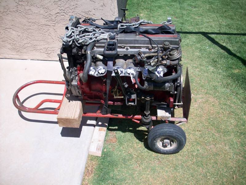

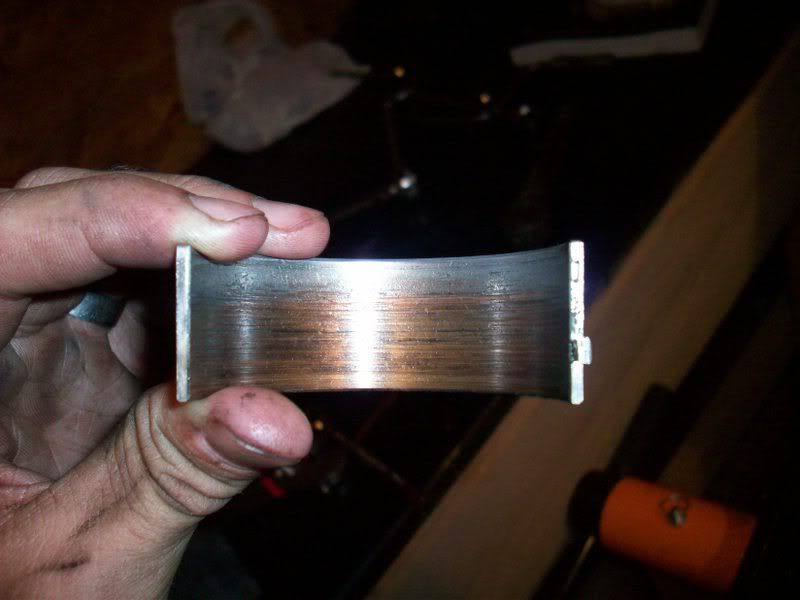

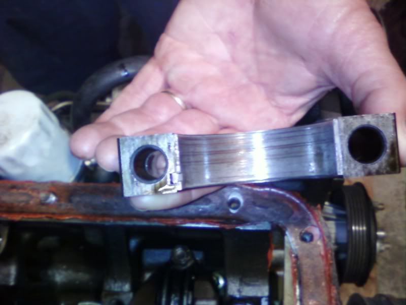

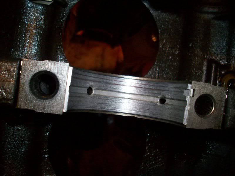

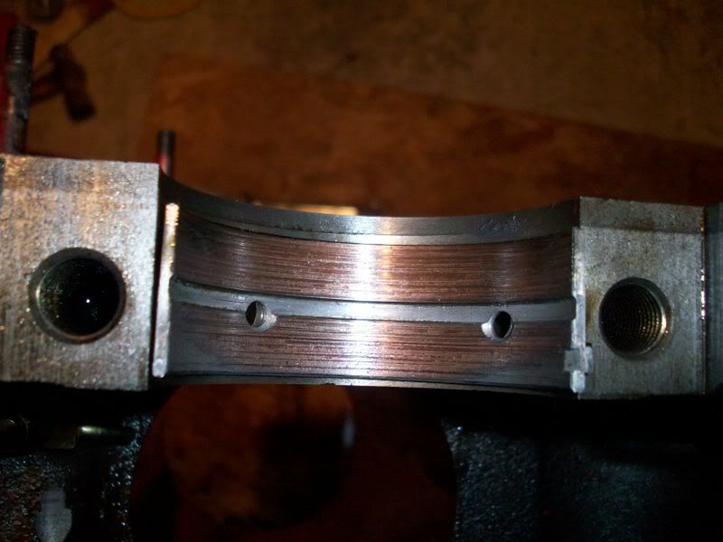

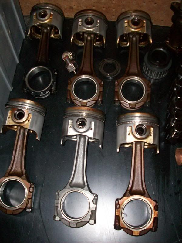

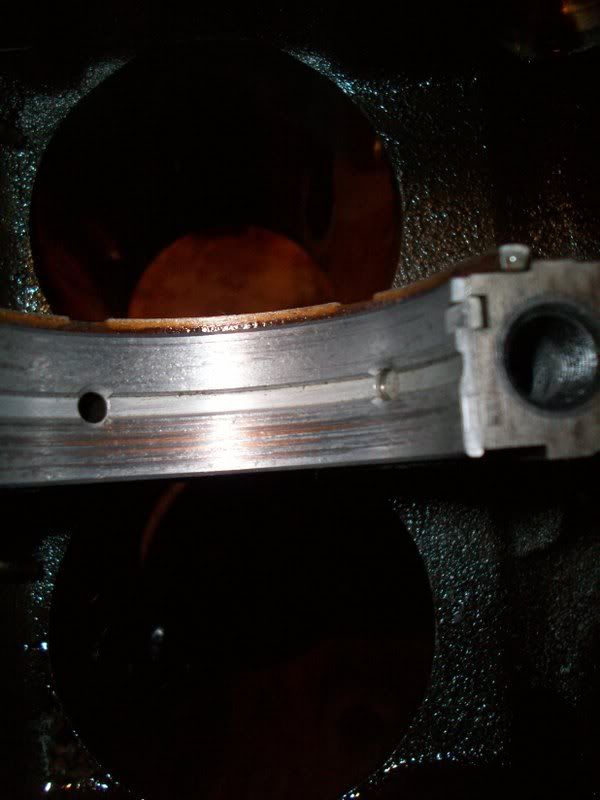

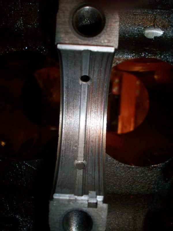

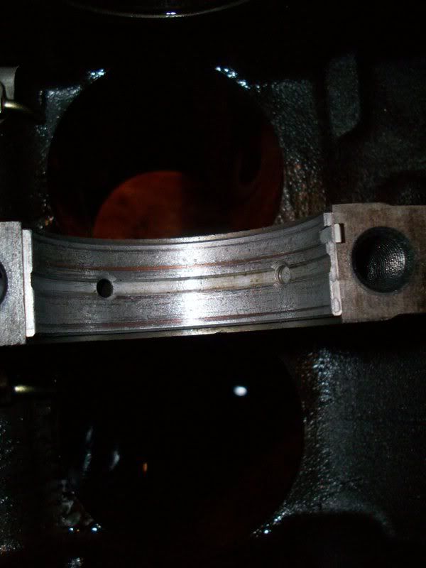

Yesterday i pulled the engine and go to take a look inside, well as we pulled off the oil pan i the first thing i was greeted to was bearing material all over the oil pan filter. after cleaning that off i looked to see what rod it was and it was the first rod and both sides of the bearing were missing. After that i checked all the other rods and they had there bearing but they felt like sand paper so im guessing they are acid etched maybe because the guy didnt get all the antifreeze out and it became that acid with the oil. Also there was a replaced rod so im guessing that got bent at one time or something, and looking at the first rod it is jet black and the main bearing caps look pretty dark so im guessing the engine might have been over heated. Anyways i did some thinking and im just going to save money and try to find another engine cause id rather have something sound then taking a risk with it. Ill probably save up and try to get one from jarco or go see how the engine is in my neighbors car. Hers was a JDM import and she put it in then totaled the car. (i dont know where it got hit so that will be the deciding factor). Any ways these are my plans and heres a few picks that i took, nothing special.
Mode of transportation across the yard lol real redneck i know
heres a pretty picture of my main bearing pretty nice huh :3d_frown:

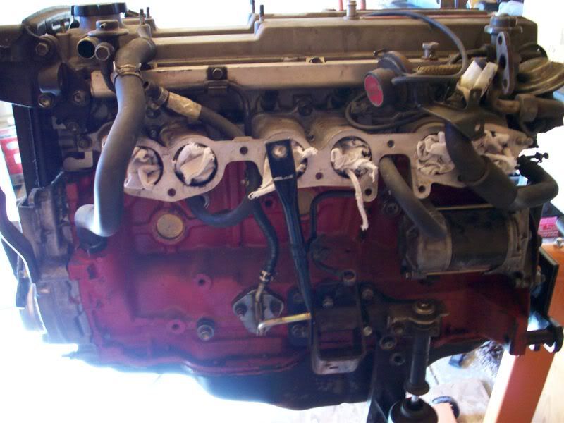

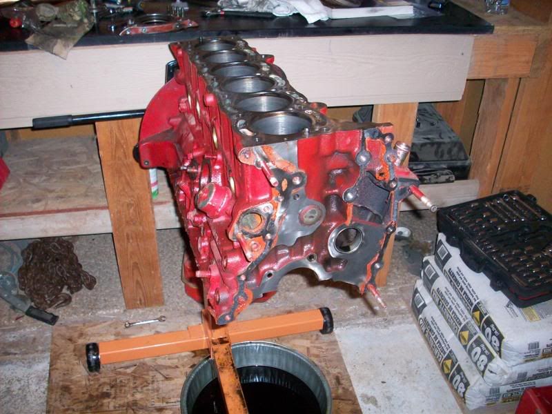

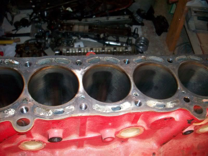

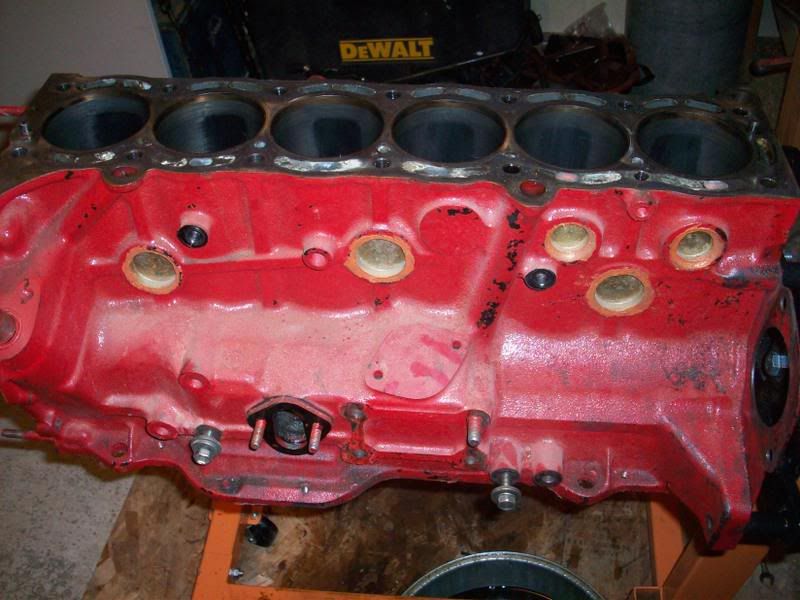

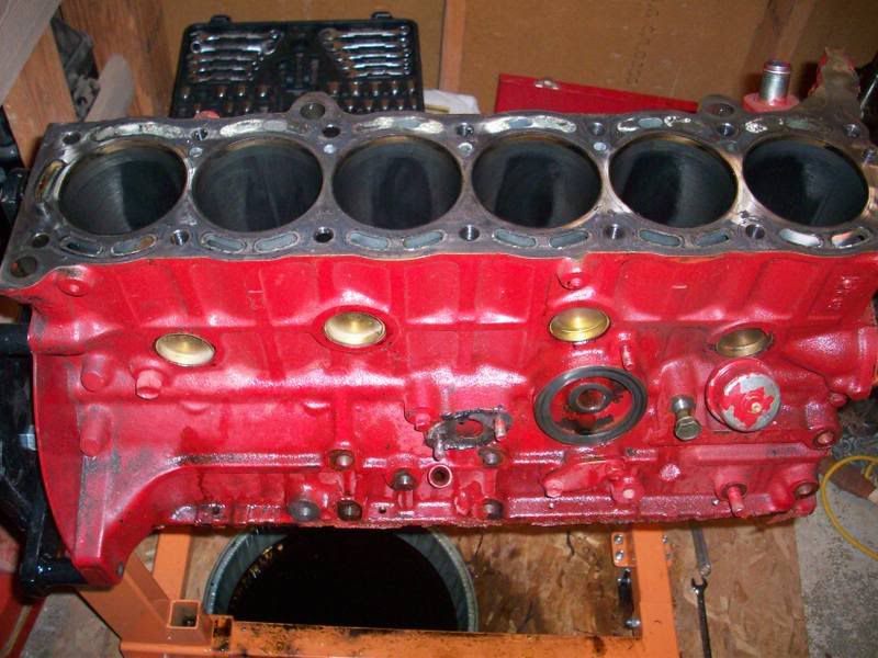

well guys i started to strip down the motor today im just going to put the pics i have along with little thoughts next to then which will highlight the tear down.

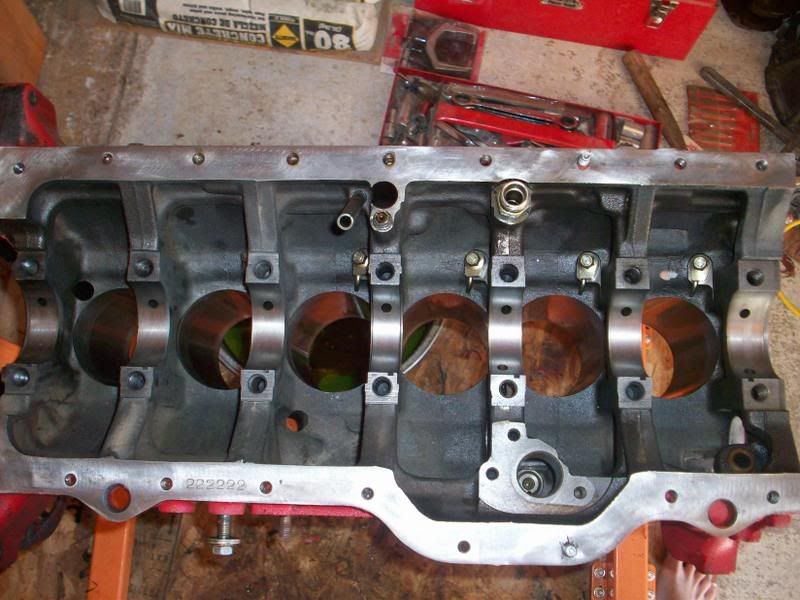

k here is the block with everything off the out side:
next i took out the internals
MMMMMMmmmmm look at that first main bearing lol.
heres the other mains
upper left is the first rod that had no bearing looks a little cooked id say.

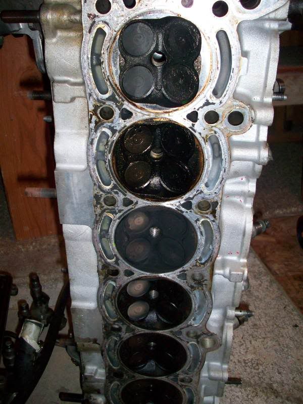

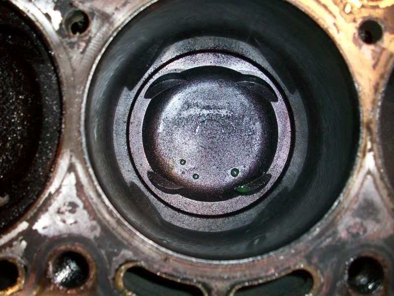

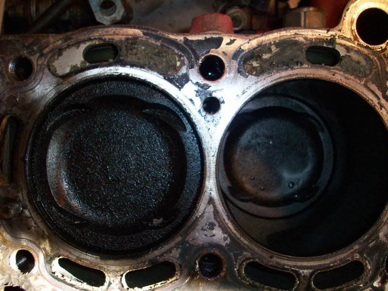

heres the bottom of the head got some oil in some of the cylinders when it was running
home made crank shaft pulley puller lol

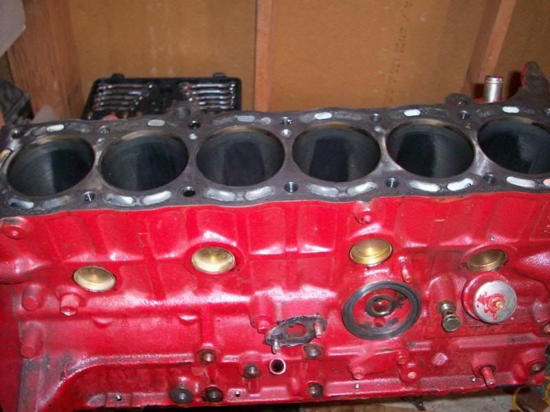

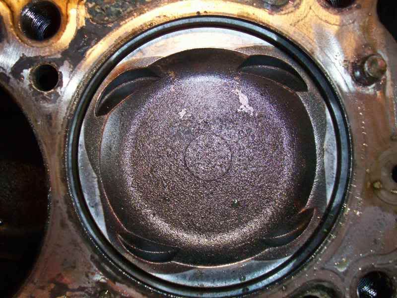

here are some of the cylinder tops:

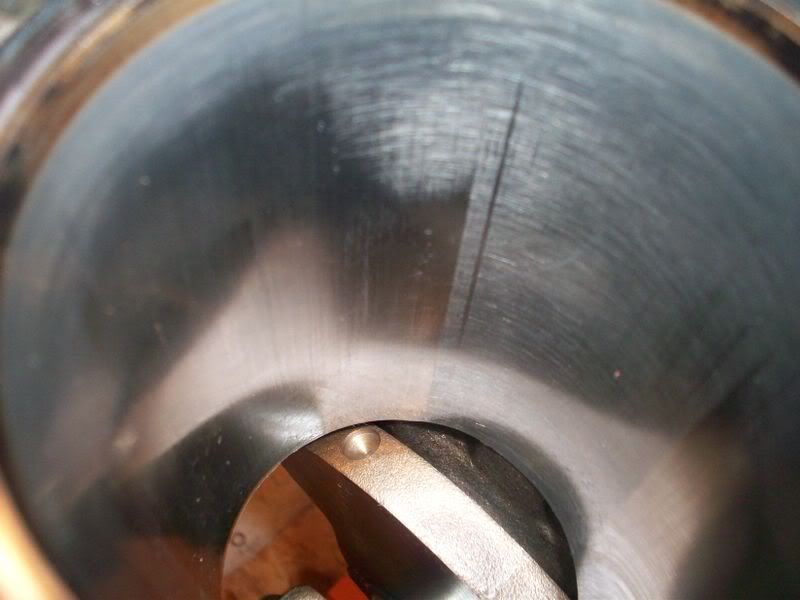

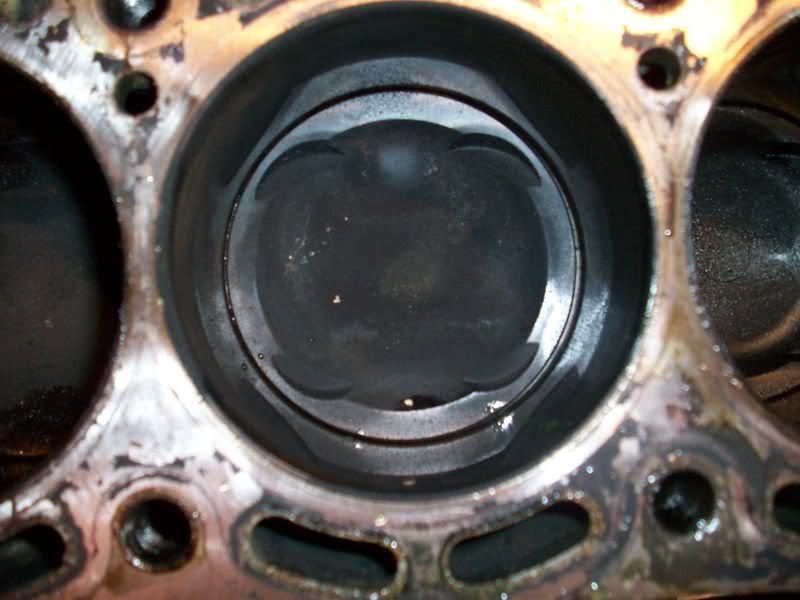

is this bad how the pistons rubbed on the wall it has marks on both sides does it mean it wasnt bored right?
top left rod was the one without the bearing i say it got a little hot on the crank
and heres without the crank in the bottom end

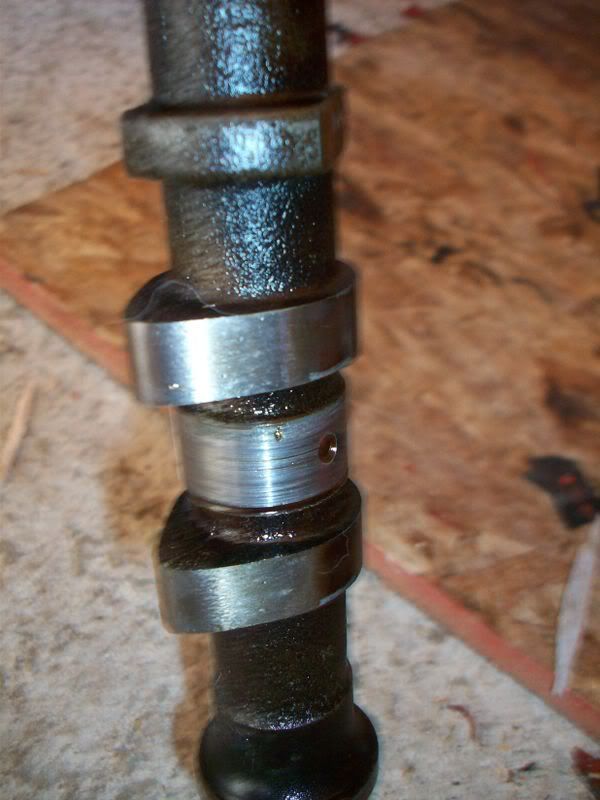

k guys im thinking about taking it to a machinist and seeing if the block is good or not. if it is i will get it hot tanked then possible rebored. i will then plan on getting new rods and possible pistons if they are bad. so i think i will just spend the money and get this engine good for some high horse power numbers so that it will be sound. the water pump is new and the oil pump looks good. i will have to get new cams as they are chewed up a little. i talked to my dad and he will give me more time if i keep working on the car and the engine. i just have to keep working on it and not let it sit. so now i got to get the block checked then do some shopping once a get the cash.

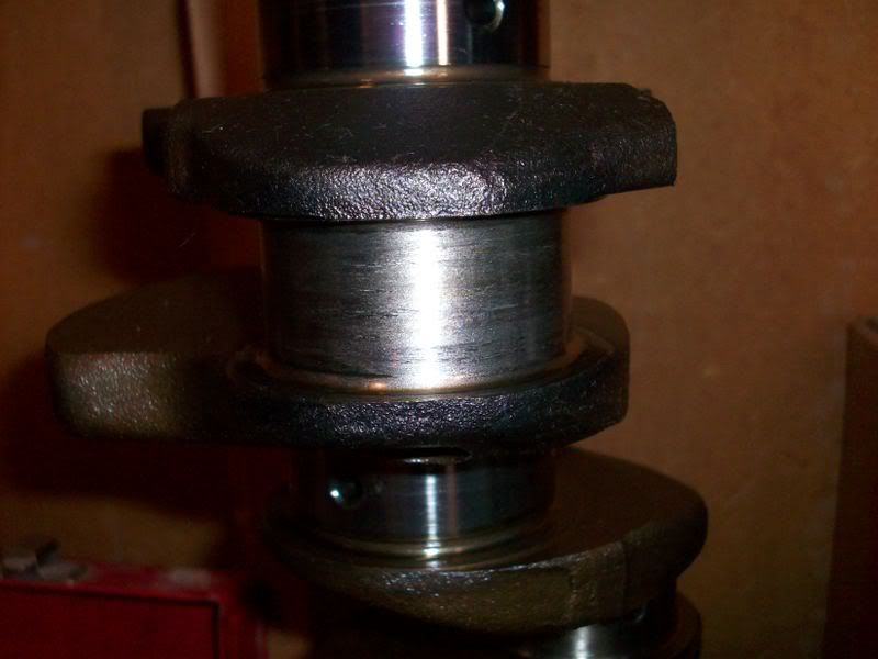

oh here are some pics after it being clean and the scratches on the crank and cams
enjoy u picture a'holics :biglaugh:

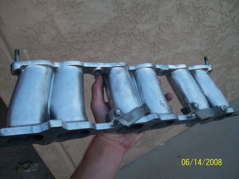

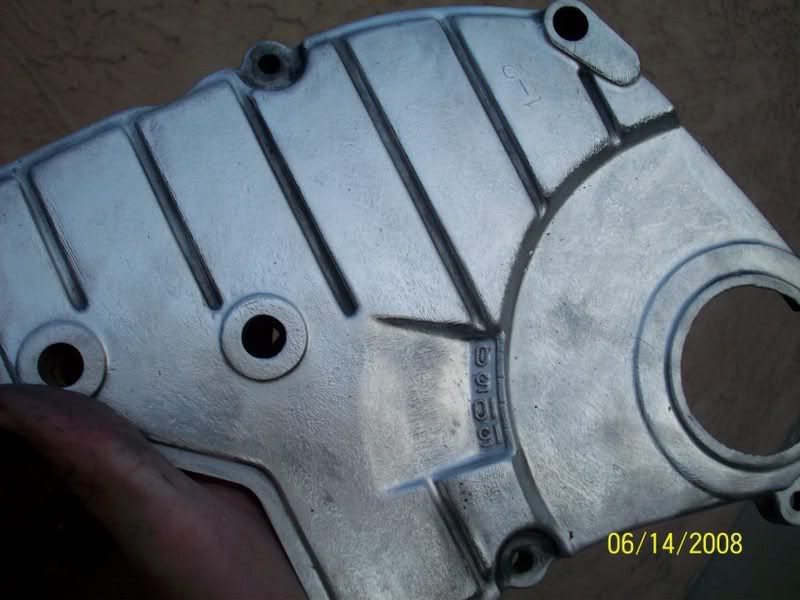

Last week I was cleaning up some parts and I let them soak in a container of super clean. Well that was a bad idea the super clean is not suppose it in contact with aluminum so it discolored all the parts that i had in there. So I was debating what to do about some of the pieces that were going to be in visible site. Well I found a wire brush bit so I stuck it on our power drill and gave that a whirl.
Heres the results of a few places and Im working on some other pieces. Still need to touch up the runners. Give me some in put.

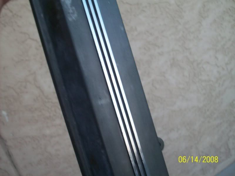

Also I had a polishing kit for the dremel so i took that to the cam covers. Im thinkin about painting them a gloss black with the stripes staying silver.
The color of the cam cover is what the other pieces looked like before I brushed them
