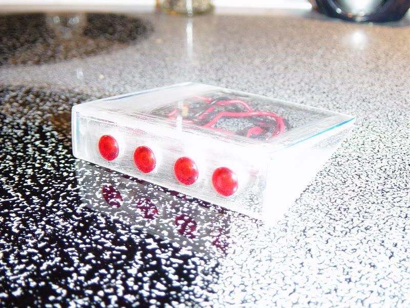

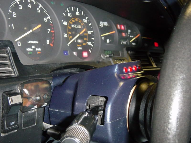

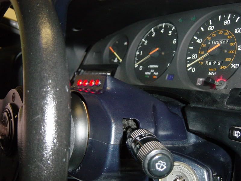

Ok, so a few weeks ago I bought one of those auto shift controllers from awshifting.com. I was a little skeptical at first...but now that Ive got it fully installed it works great with very little delay if none at all. Wiring was really easy...none of it took that long hooks up in the ECT ECU area. I ended up paying around $150 for everything I used to install it: the controller, 4 LEDs to show you what gear your in, 2 on/off switches..one to turn on the controller from normal auto to manual, the other for the torque converter lock, and 2 momentary switches for upshift and downshift. Here are some pics of how everything looks that Im done....(I know everythings dusty, I put armor all on a few days ago and now dust is sticking to it)
started with plexi-glass and epoxy for the led's

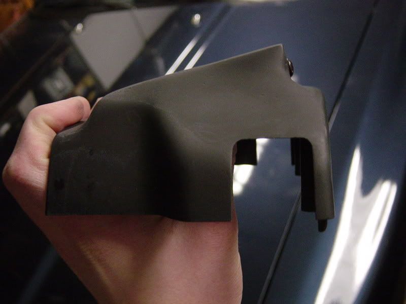

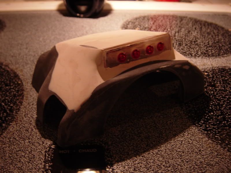

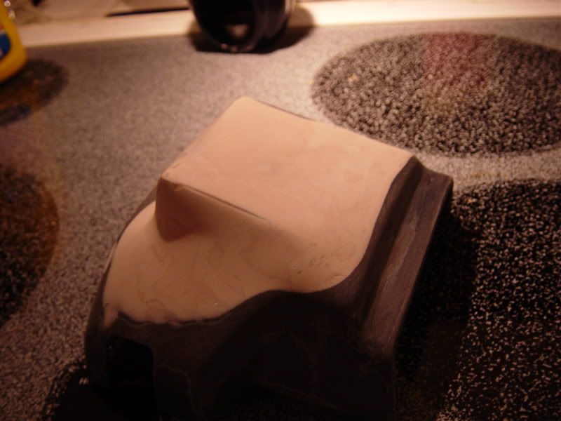

then bondo'd it to the steeringwheel shroud

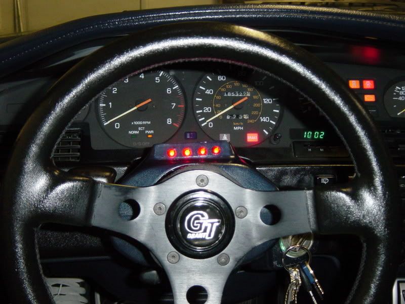

Finished

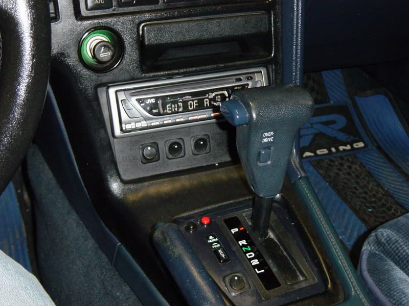

Made a panel under the radio deck to put the switches, and mounted the shift buttons where I would reach them easy
what do you guys think?

So you put your car in D and shif by just pushing the red and black buttons?
BTW nice job with the install...

thanks:icon_bigg , yea you just put it in D and use the buttons to shift you can also turn it off and just drive it like a normal auto. when its in "manual" you can still put it in Reverse or park like normal the only thing the controller is doing is over riding the ECU decision to shift and lets you do it.

No it doesn't, Its basicly like a stick...you wouldnt want to downshift in a low gear at highway speeds

he had the paddles, but I didnt want to spend that much money..plus where I mounted to buttons its where my arm normally lays anyways when Im driving so its right beneath my fingers, but I would rather have the paddles if money wasnt a factor

i woulda put the buttons on the steering wheel so i could use my thumbs to push the buttons, next best thing to paddles....... nice install tho

thanks jdub,:icon_bigg yes it just turns it into a manual shift, and you can turn it back into a normal auto by fliping the switch on and off. you can also control the torque conveter with the flip of a switch.
