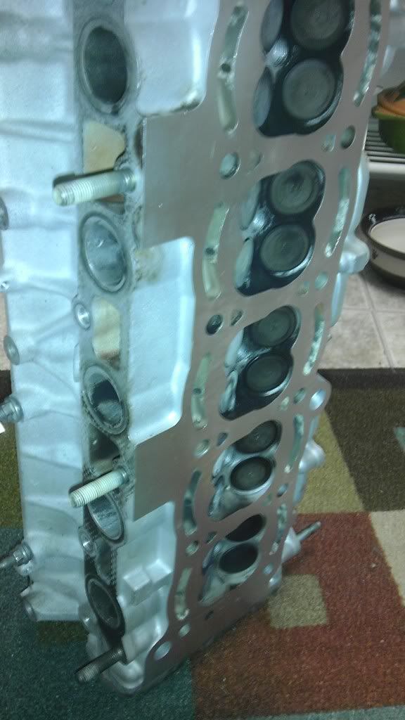

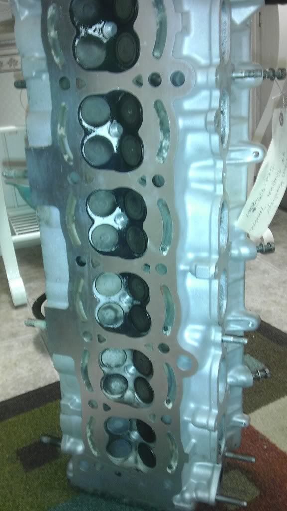

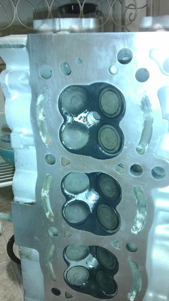

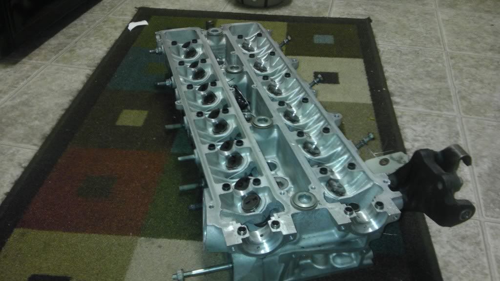

So i got my Head back today and this is what i was told.
Head was warped pretty good and that he had to go under the min to get it flat.
He Said the min was 4.560 i assume that's Inches
He measured my head in front of me at 4.545
Should i worry about it ? I've read some other threads about this and some say just don't run massive boost on it. My question is what's massive ?
I plan on running the car on 18psi with a CT26 60-1 using a composite head gasket.
This is just until my other motor is done being built So i want be running this for years or anything like that maybe 8months.

So the head was warped and they just machined it flat instead of straightening it first?
Might be an idea to bolt it on a block put some cams in and see if they still turn... man some pros need a kick in the Nads....
A "shim" will need the same block prep as a MHG unless you put it on top of the gasket under the head... (never seen it done that way)
Unsure how he went about getting it straight. really didn't go into it. he just said that he had to go under the min to get it flat. he also said to him it was not a big deal but that i could use a Shim to get it back to where i wanted.
So being the it is .015in or 0.318mm under i should be okay with just a felpro right?
Will this change the compression ?
