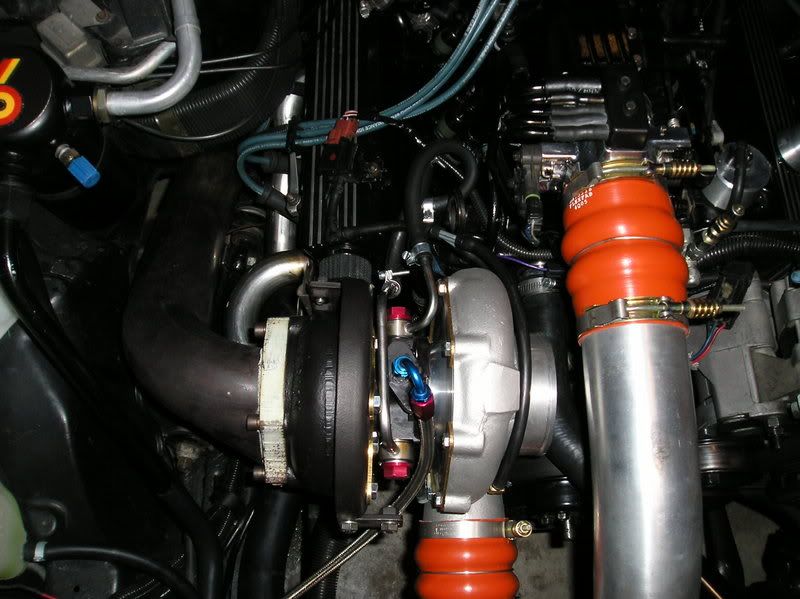

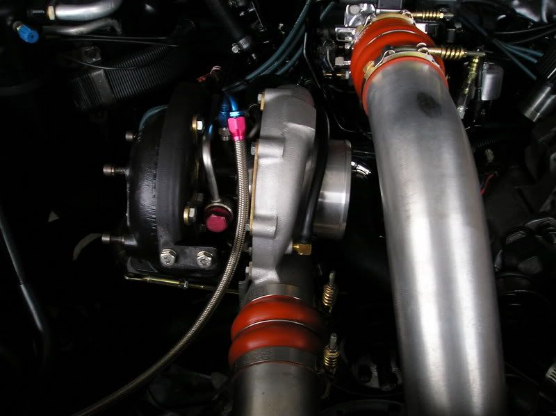

Haven't seen one of those for the 7m. The fellow whom may of owned it possibly had a GNX before the supe and kept his turbo..
Just got very familiar with the engine bay of one of those this last month helping a friend put his back together! So when I saw that flange I was like oh look GNX turbo flange strange but they do make some badass bolt on turbo's for that car. Could possibly be useful one day or can sell it for 250-300 for someone familiar with those and wanting to use their turbos.
Justin727
T-virus infected
TY sir,
From what i've seen I suspect that hot side to be small as it is for the GNX. I have not really looked into them myself. But his turbo is a 61 with that flanged hotside that looks small.
Hit's in really good on his car. Would be curious to see how they'll hit on the 7M. I say keep it and use it one day

figgie;1407307 said:
Why would you think that since the GN was a 3.8L V6? If anything it will be bigger than ours.
reread what I wrote my good friend. From what i've seen, not that I know. My buddy has a 61 on his GNX right now outside in the parking lot. From the front it looks like my turbo but the hotside is alot smaller then mine as far an deminsions go.
As far as wheel size I do not know. But looking at it compared to my hot side the physical size of the hotside looks smaller. This is a 67. The 61 he has, has a small exhaust wheel in it. But seeing this one with such a larger wheel in the hotside doesn't mean it can't be as big just the housing is "slimmer" sorry I should have made myself a little more clearer. I'm not a GNX buff although I will be doing some studying on them now that they've got me interested in the car.
The one pictures like I said is larger with an internal wg. His is external and the wheel is alot smaller. I should have grabbed pics sorry sir these are off a GNX forum.:icon_razz
