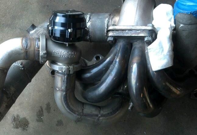

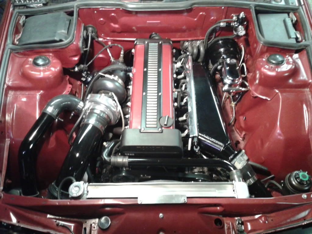

I have a drewgo and also had to raise my turbo by stacking a welded flange to clear a large compressor (had to cut up the compressor outlet as well), and the position of the wastegate itself might be ok, but the position of the actual to-wastegate pipe off a single exhaust runner creates some uncontrollable boost issues. So it's not all gravy in drewgo land either.
It actually held boost well on my 6376H with stock cams, once I swapped out the cams for 272s and increased flow it was all over. Wastegate has been tested. Im thinking about adding a second wastegate maybe off an opposite runner and run two Tial 38s, should be easier than cutting the current situation up and moving the pipe to somewhere near the collector (like these manifolds in this thread are) with a bigger wastegate.
