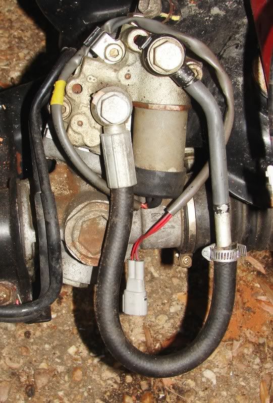

I also acquired this hose on a parts car that I once had. I'd let it go for $25 shipped
