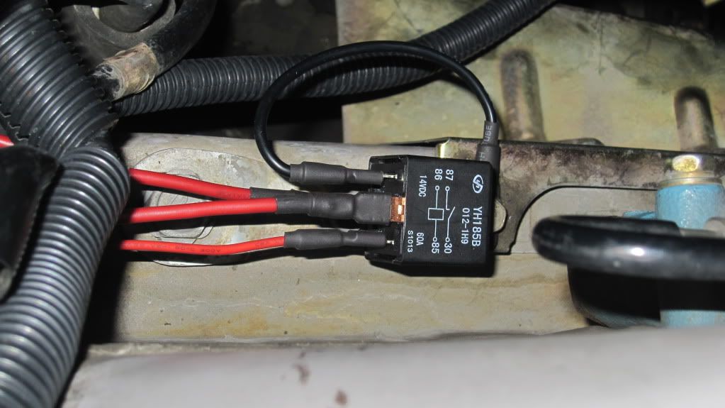

If you do it correct I don't see any problem however clutch fans do the job. You have to choose the correct fan, correct gauge wiring, correct relays, ect... I am into electronics so I know how to do electrical work professional and proper. I have mine hooked up with 10 gauge wire, a 60 amp relay triggered by the ignition relay, and Using a Ford Taurus fan on high speed which keeps the temps at 175F in this 40-50 degree weather and 195 in the 115 degree heat during the summer..
The ford taurus fan on low speed is sufficient for the winter and high during city driving in the summer.. I have been using this same setup for 6 months without one overheating problem with the wiring or relay.. As long as its rated to take it, it will be fine. The tuarus fan covers the whole radiator and fits perfect like it was made to be! I got mine at the junk yard for 25.00

Using an unsealed relay like that in the engine bay will result in this:
Unless, of course, you don't drive in the rain.
