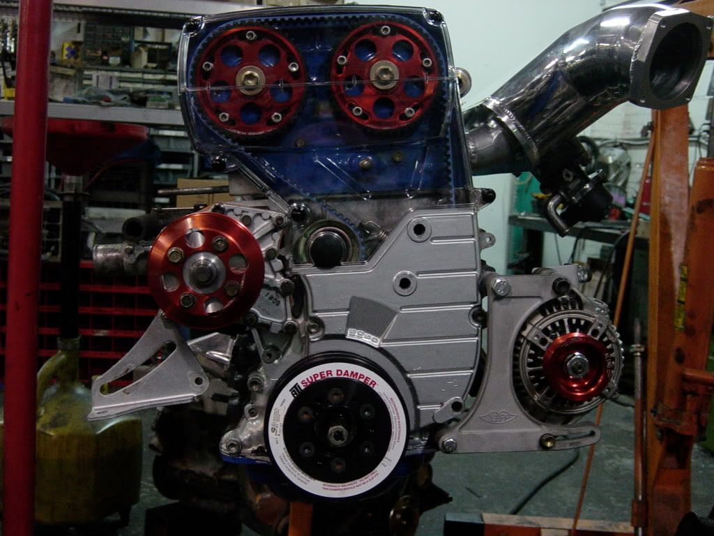

Is this the one you're asking about or is it a drop down bracket?
This one I have fit fine.

Can't remember the belt size. It would be different when using the ATI damper instead of the OEM damper for the same set up.
Supra Sport sells the the cast alum. for $85, Wes Beech sells the billet alum. for $90.
