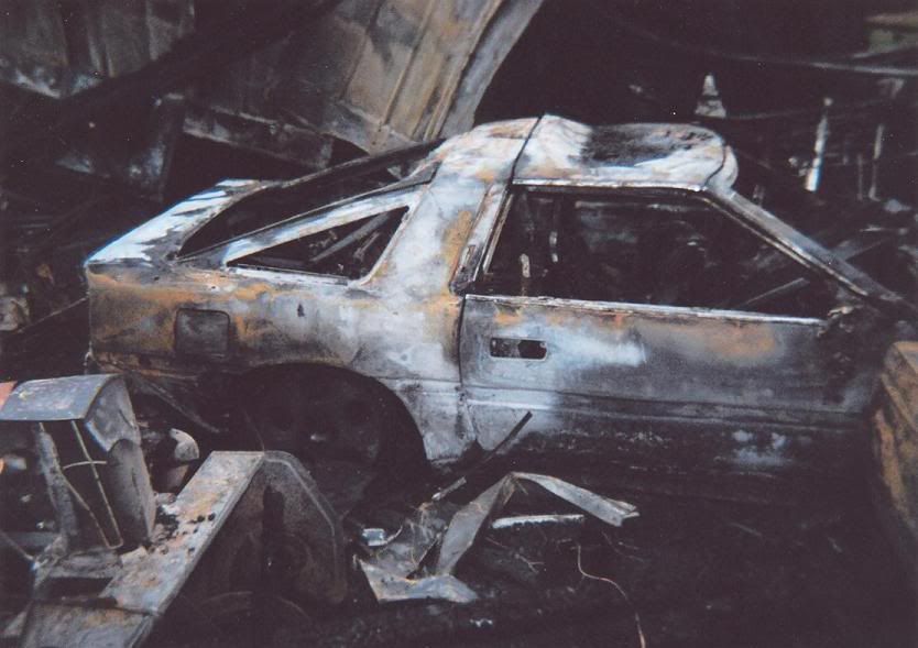

tell yourself that your lucky, and that it didn't end up like my 89 2 years ago
(sorry for the thread jacking)
