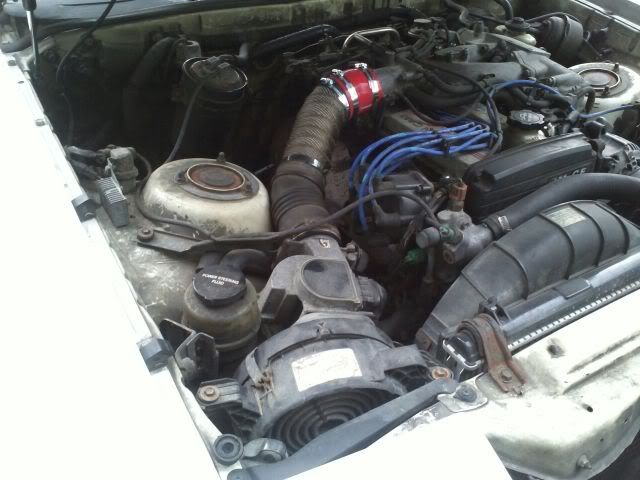

The stock 7m air box may be drawing cool air, but as soon as it passes through the giant heat-soaking intake resonator, it heats up the air inside. However, at WOT where IAT's matter most, the air is passing through very quickly and the heat transfer to the air passing through is reduced. I understand that. There is still heat transfer taking place though.
What I ended up doing was replacing the intake resonator and the rubber bend right before the throttle body with an aluminum pipe with a much more gentle bend. I heat wrapped the pipe and have felt, first-hand, that the intake pipe stays much cooler. With the stock intake piping/resonator, I couldn't even touch it without being burned after a normal drive, where as now I can put my hand on the under side of the pipe facing the exhaust manifold and it's merely warm at most after a spirited drive.
I also replaced the stock filter with an oem replacement from K&N in the stock air box. I cut the front portion of the air box out, mainly so I could hear the intake (was just too quiet for me with the stock setup :p ), but I did so in a way that it retains it's function as a heat shield from the rest of the engine bay and still draws the cool air entering the grille/front bumper. The picture below is before I had replaced the stock air filter (which was quite dirty and needed to be replaced anyways).
This combination I found improved throttle response and performance throughout the rpm range (nothing crazy, but was noticeable) and even cured several issues my engine had with rough warm/hot-idle and warm/hot-starts. It now starts and idles perfectly.
I attribute the improvements mainly to lower air intake temps (from the heat wrap) and the less restrictive bend just before the throttle body.
No I don't think the engineers who develop stock intakes are idiots. But they do have to design components to certain specifications and parameters (designed for ease of manufacturing and must keep the intake noise quiet etc...). They did a good job with the stock setup as it is a true cold air intake. But it still suffers heat soak with the intake piping running right over the hot exhaust side. It's not perfect and there is always room for improvement (to a point).
Just my 2 cents. :)
