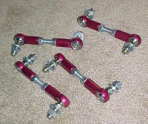

I had the parts laying around here for a few weeks, but my passenger side endlink finally popped, and was louder than hell. So I finally went to a hardware store, bought some threaded rod, and put them together. The loud clacking sound is gone and the steering has gained a lot of response :D Unfortunately I am not able to put the rears on yeat because I need to reinforce the mounting tabs back there, and I have no welder...

Aren't the parts for these type of assemblies dirt cheap and fairly accessable? For some reason I remember a friend throwing together a set of rear adjustable toe-links for his AW11 for next to nothing and wasn't steeply 'mechanically inclined'. I am :nuts: so I could be way off base.

You are correct. I did mine with nice spherical rod ends that were 7.81 each. 8 were needed, and I also needed some threaded rod, jam nuts, washers, and nylock nuts. All together it was under 75$.

I don't see how I am being cheap by making my own endlinks, I used Teflon coated steel rod ends, so to be honest with you, yours will wear out before mine. I got my parts from www.aedmotorsport.com by the way. So don't go running your mouth before asking.

Same source as me, they are a great resource. However I use the race series heims, they run 2.5+ times more than yours. Stuff as important as suspension linkage, I don't cheap out.
Different routes for different folks I suppose. I make very little on money on these.
I'm going to go ahead and make three full sets. My wallet right now doesn't allow for ordering more supplies than that. If you want a full set, shoot me a PM.
