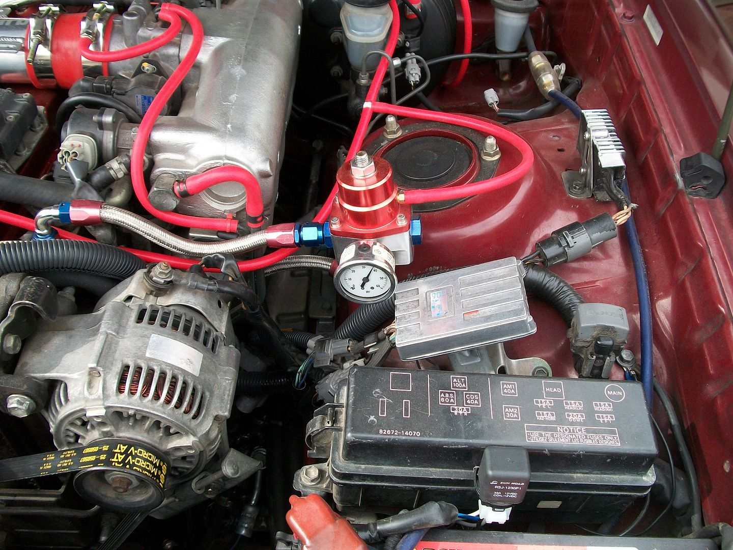

Best pic I have. As AM3 mentioned, one line goes to the front of the rail where your stock PR is now and the other comes out and connects to your return line to the gas tank. Obviously, without a gauge an AFPR is useless...how else do you plan to tell how much pressure you are adjusting for?
And, before I get flamed, no my AFPR vacuum is not T'ed any longer -- it has dedicated manifold vacuum now. :naughty:

^^^^ hey I noticed that on top of your alternater you do not have the plastic cover over the power wire.
Be warned that many Mk3s have burned to the ground this way.
Good Catch. Habanero is right and plus you have the braided line right next to it as well. Get a OEM or aftermarket one, they are cheap and I believe autozone should have a generic one that could work.
Hotwheelsjr
May 22, 2011
146
Surprise AZ
Lately, I've been wishing the sumbitch WOULD burn to the ground...it's insured by Hagerty.
Seriously, though, I haven't given it a second thought. There's nothing flopping around that would short it out and the braided fuel line "near" it is tight and has no chance of movement. I will certainly look into covering it up, though. THANKS!

It's not necessarily that the hose will "flop onto it" -- I know that my own aeromotive AFPR kit hose is too tight to move easily, but if anything else conductive is in the area, it's a nice place to get a high power arc across to, and just to make things more exciting, it's also a high pressure fuel source. This is not a combination that is particularly prudent.
