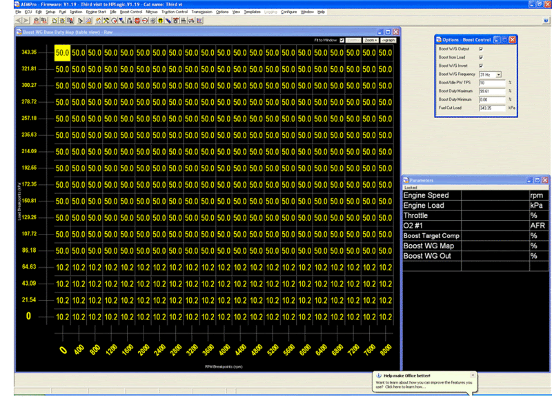

survyor2
Jun 19, 2005
171
49
West Palm Beach, Florida, United States
In the past I did my own tuning using a SAFC2 and AVC-R boost controller. Very easy to learn and use.
Got my AEM EMS 30-1130 a few weeks ago. Tuned at HPlogic for 18psi pump gas. I was still using the AVC-R for boost.
Last week AVC-R that I've been running for 10 years dies. Now I want AEM EMS to controll my boost.
I installed the MAC solenoid valve (exactly the same as the AEM solenoid) and ran the vacuum lines and verified they are correct. MAC valve is wired to PW2 (avail boost control) and HS#2 (avail +12v switched, 4.5A max). Correct so far?
All I want to do is set the boost exactly what the AVC-R was set at, 18psi. I read the follow link on tuning for boost:
http://forum.aempower.com/forum/index.php/topic,994.0.html
Now I'm lost. Can anyone help me through this. This link confuses the crap out of me.
Here are the options I have currently set up:
Boost W/G Output = check
Boost from Load = check
Boost W/G Invert = check
Boost W/G Frequency = 31Hz
Boost/Idle PW TPS = 10%
Boost Duty Maximum = 99.61%
Boost Duty Minimum = 0.00%
Fuel Cut Load = 343.35 kPa

be sure the hs#2 is set to turn on at 1000 rpm or whatever, and the other parameters are set so it will get power. you can just wire it to any switched 12v and not to the aem.
you can send me your map and i will set up the numbers. too much to post. also set map filter to 6 teeth. it is in setup/sensors/manifold presure sensor/ options map sensor. this will stabalize the map sensor reading so the selanoid can be reliably controlled.
my email is halsupamk3@bellsouth.net
i will send you my phone number so we can get this done correctly.
Hal,
Thanks for the respond. I sent you an email. Let me know if you got it. I had trouble with the email address you gave me. Thanks, Dennis
Halsupramk3
Apr 4, 2005
444
Mississippi
i corrected the email address.
I believe the HS#2 are +12v sources that you turn on in the options/ configure outputs hs#2. it would provide 12v to the selanoid. DO not run 12v into this pin. at least i think that is correct as i have not used hs pins yet. the LS are switched ground that you would use to trip a relay etc with a ground connection from this pin in the aem.
you can not tune the boost selanoid with the P+I option on. you have to have info for what wg duty % provides what boost and calc the numbers to input there.
please email/provide what engine mods you have. what injectors, size turbo, what wastegate type and size, oem throttle body? , CR etc.
i highly suggest you use boost comp instead of a load map. boost comp is easy and works great. do you have any logs to send me?
