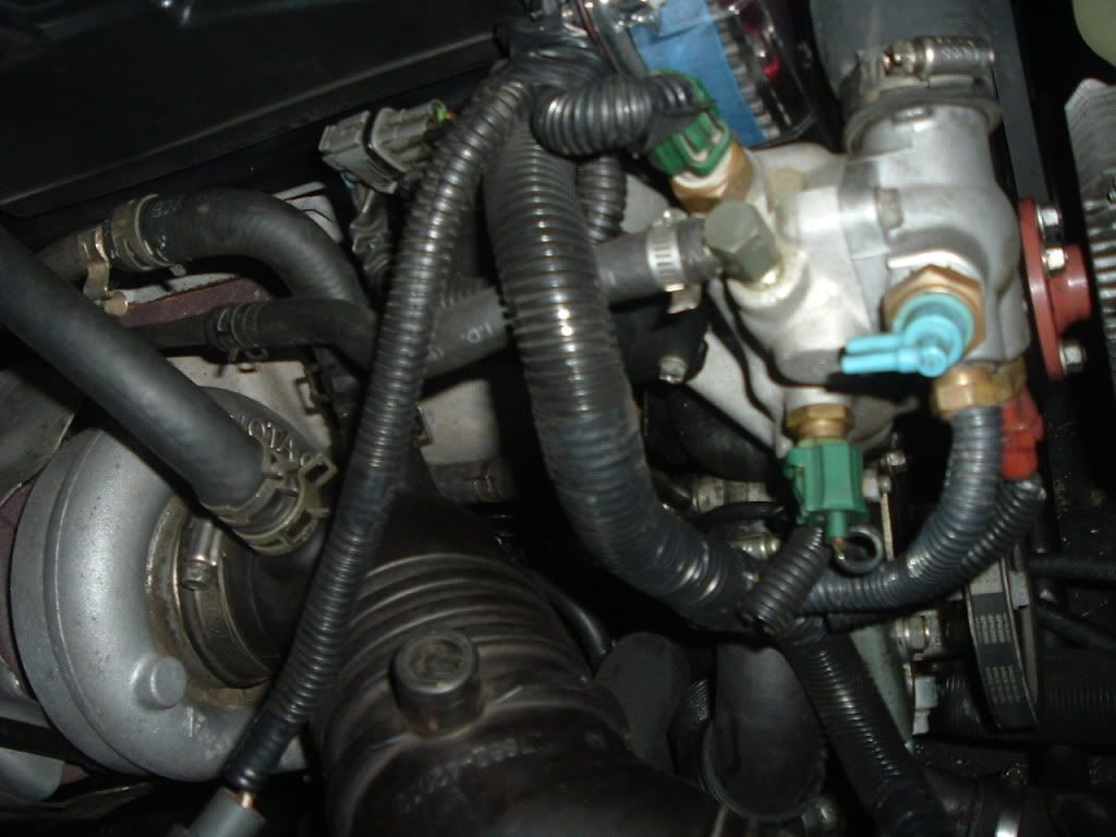

Or on how just one hose hose up to it with the small vacuum hose on the bottom is hooked up? All I have is this pic of my old set up with the BOV port blocked , Im still running a hose for the IAC and PCV system along with the PS vac hose :dunno:
Pretty simple, there is 3 holes in the accordion hose and the other hoses hook up to it. Also look in the TSRM for complete OEM set up.

I was referring to a pic of someone's setup that has the hose removed and all the filters and rerouted stuff. I know how the stock hoses go. I have the BPV hose blocked off too.
