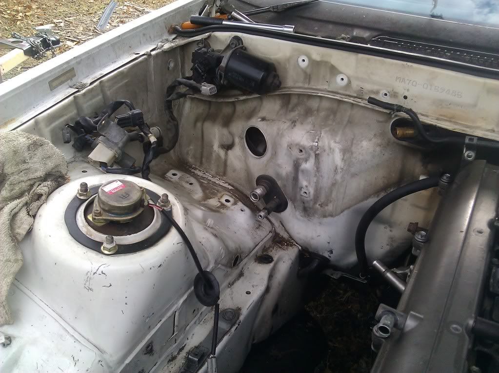

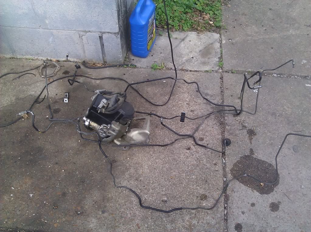

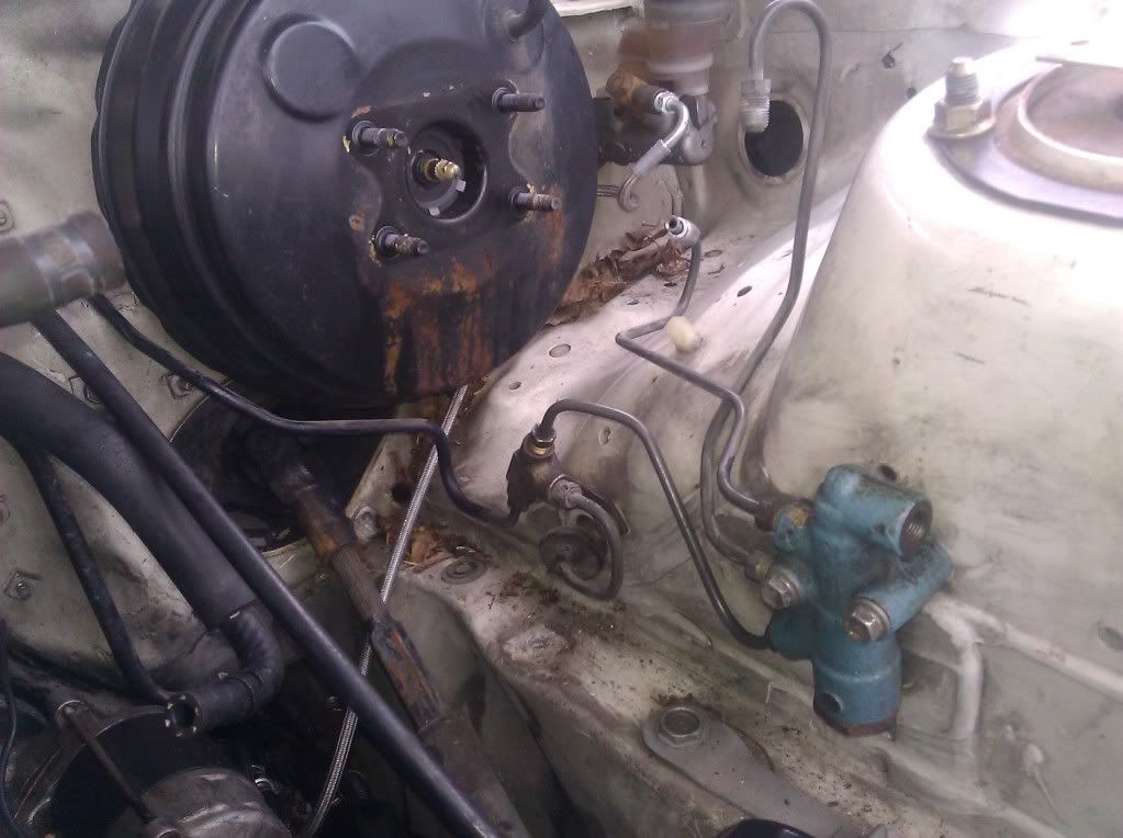

here a few picture i did to mine
when i remove it
here the none abs prop valve with all the hard line,,,,
try looking for a none abs from a junk yard,cuz toyota dont make the hard line anymore
