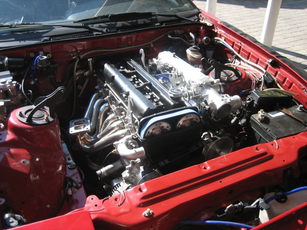

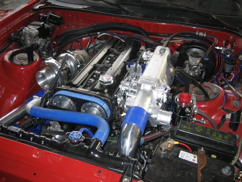

Finally got the harness extended.. Now I just need to wire up the MA7 connectors. I can just cut out every connector related to the twin turbo system right? No use for that now? :D

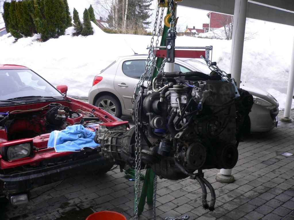

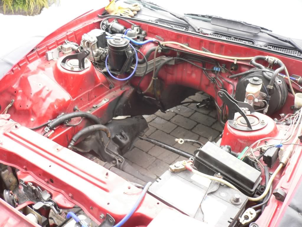

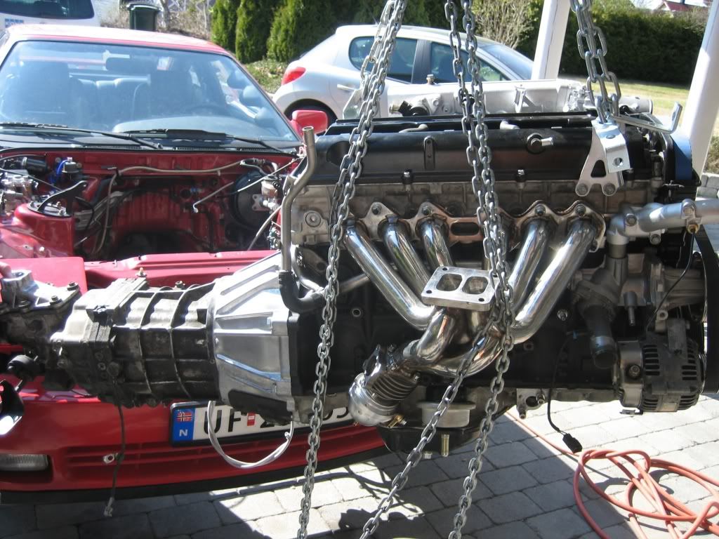

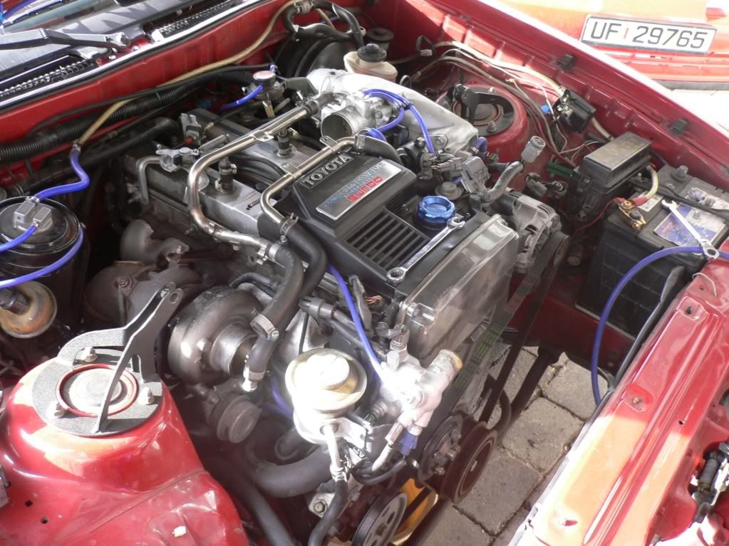

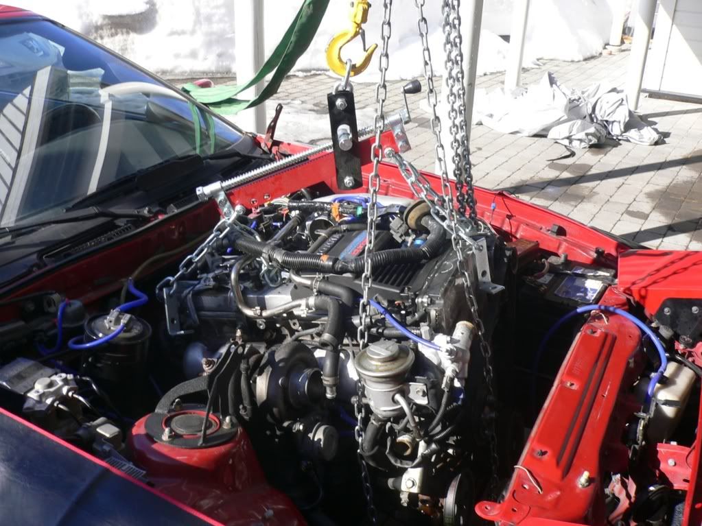

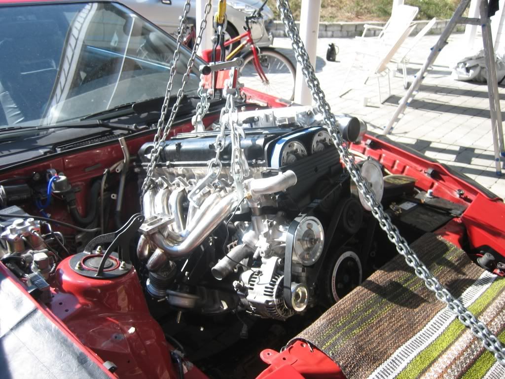

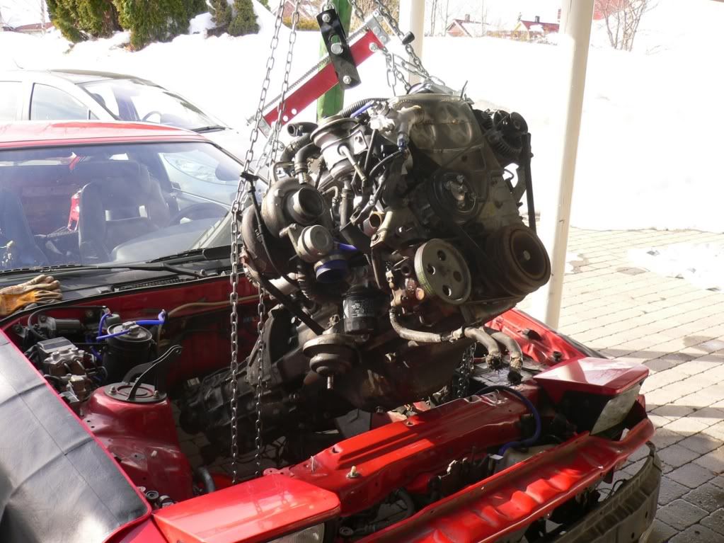

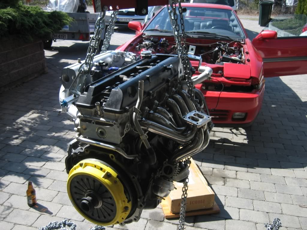

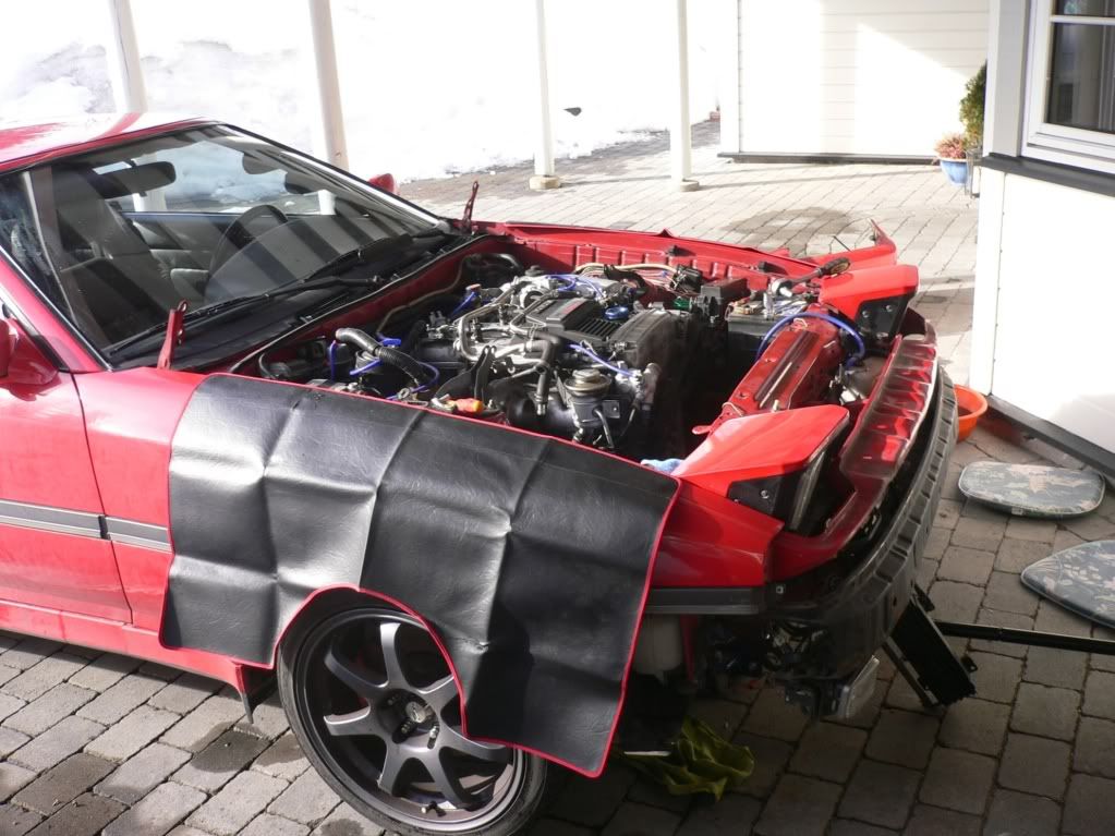

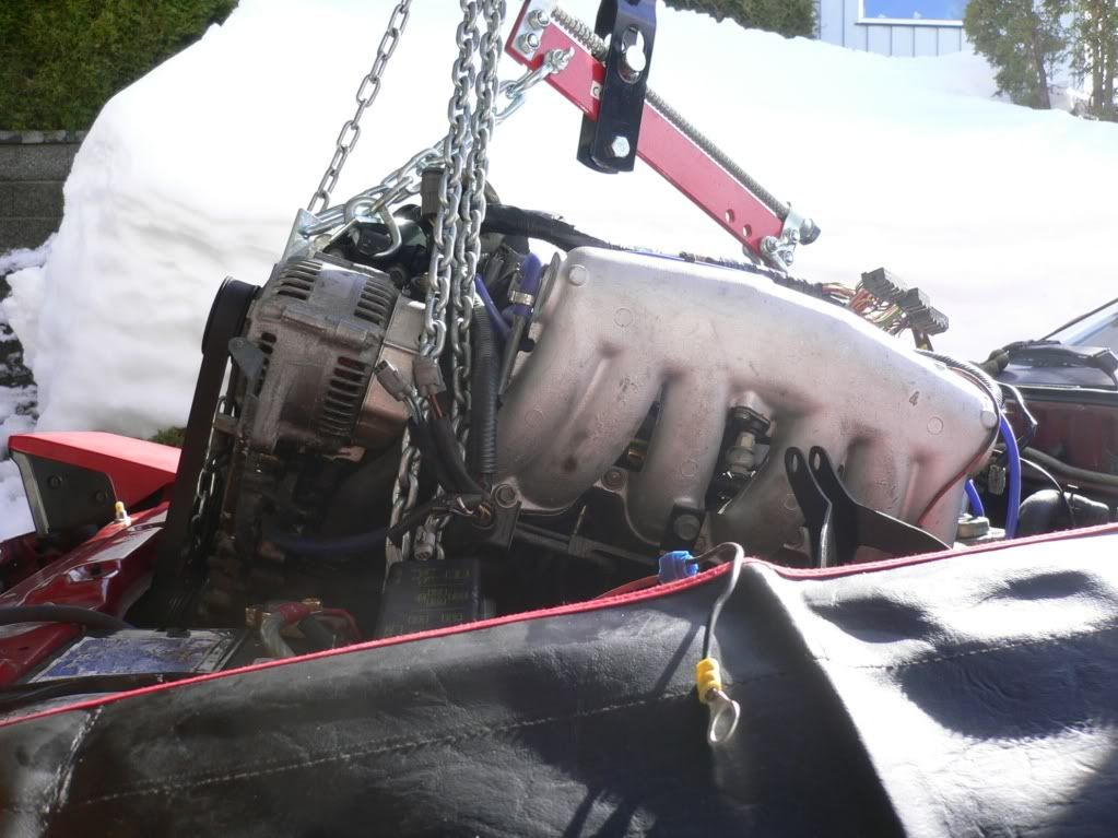

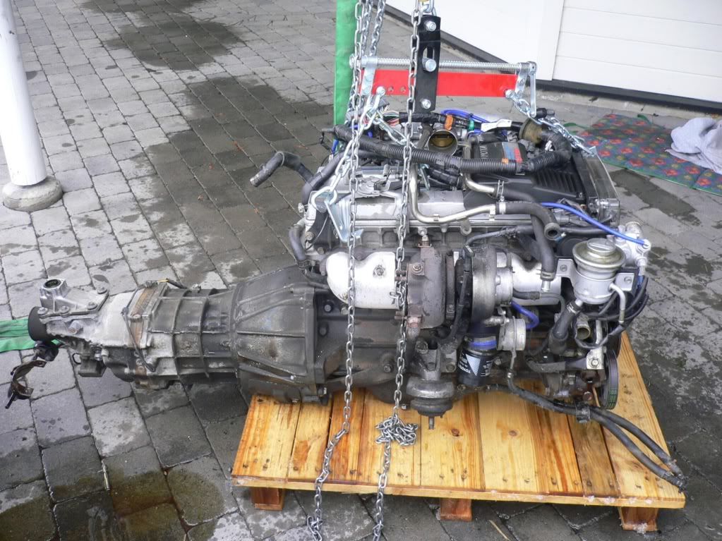

Finally a real update :naughty: the 7M-GTE is out. I had to wait for warmer temperature.. So the old engine is out and ready to be sent to storage. Maybe I will put it in a ma61 next year or something. I got a package here the other day from Driftmotion. Clutch, bellhousing, flywheel and some other goodies. I will be working a lot to get the car ready in the easter holiday. so more updates will come in two weeks. :icon_bigg

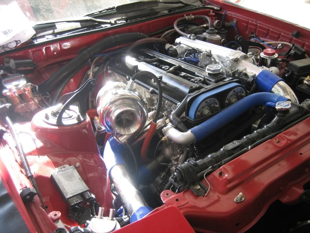

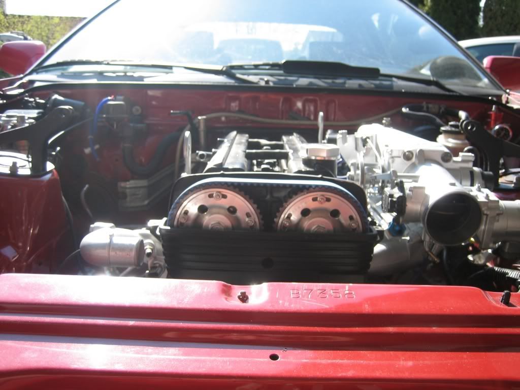

Time for updates.
I have been driving the car a little now, and suddenly it didnt want to stay running. The engine did not like the FIC very much... :p

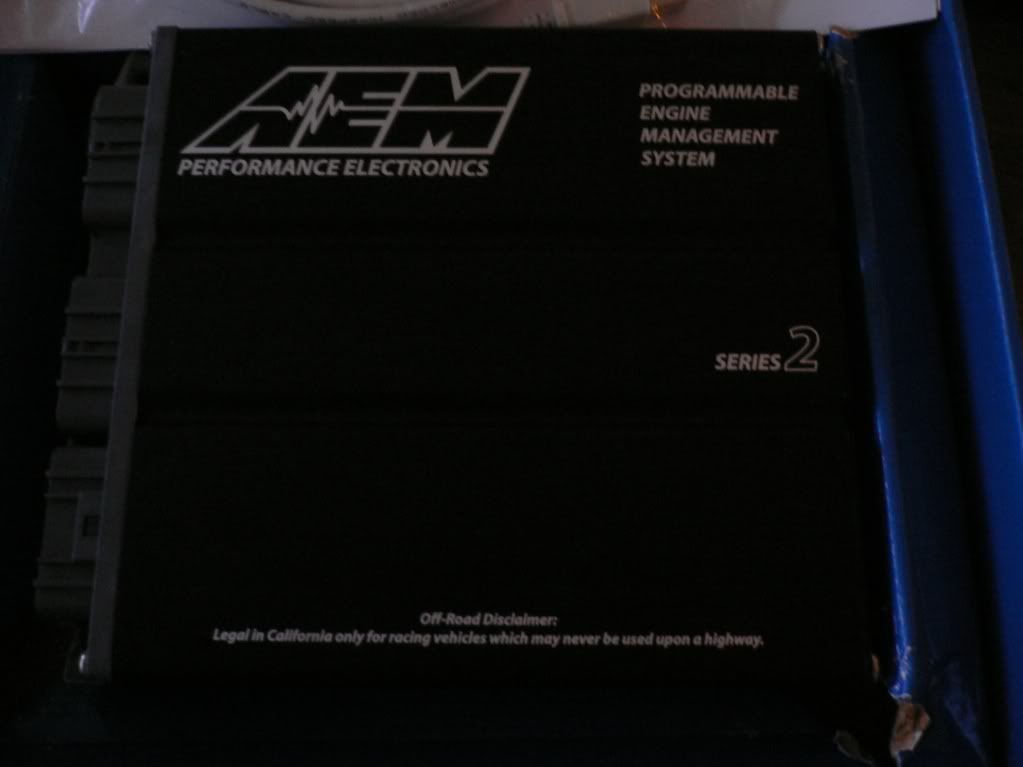

So I got this in the mail today, and the car will be mapped on the 17th of July.
Cant wait to se numbers. :icon_bigg

With the driftmotion bellhousing does any modification need to be done for trans mount or its shifter placement? Also, how does the engine bolt to the car vs. stock mounts?
90Supra-gte
Excited
Feb 9, 2007
Norway
With the BIC engine mounts, everything is bolt on. :) I had no fitment issues at all. No modification is need unless your still using stock turbos. But in some cases you wont even have troubles with the turbos.
