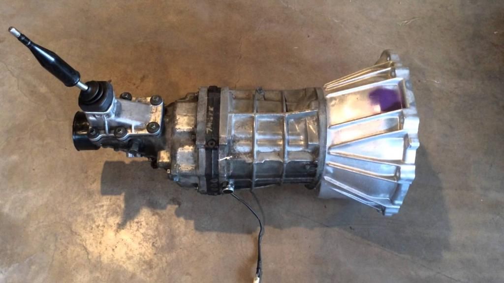

Check this out?
Yes, it is a 5speed stock R154 transmission in the picture, with just a 1JZ bellhousing since I run a 2JZ, but I am going to upgraded the R to a bulletproof gearbox
at the same level as the V160 getrag 6speed manual transmission. Just got a spare one, and it will be my next project to make it handle 1000hp safely!
That's why I named it , the V154 ;-)
What I got in mind to achieve that goal after many years of search and experience is :
-Multi disc clutch kit. It should be triple or quad disk,and pull type. No conversion kits for push to pull type should be used.
-The best short shifter with rubber dampener for the R154 trans.
-Performance transmission mount. Not solid one,and should be matted with motor mounts also.
-MC upgraded kit , plus the Driftmotion 3-4 and 5-reverse shift forks.
-Toyota oem rebuilt kit with new bearings and seals
-Redline MT lubricant
# and maybe take the transmission at the end to a cryogenic procedure , to increase the metal strength of the gearbox...
Let me know about your thoughts on this guys...
Anything that I missed to add ? Or any idea about going the R transmission to the highest level of performance.

Quin;2002550 said:
Thrust washer. Run a quality shifter. Still probably break. Lol
A billet performance thrust washer is included in the MC kit for the 1st gear.
Quality is first thing that I have in mind when I buy parts for the Supra ;-)
I don't think it will brake at 1000 hp after those upgrades.
Now I run a 24 year old stock R154 transmission and I boost 720hp without any issue.
Though I don't take it to the dragstrip or doing crazy dig races, nor I ever run slick tires.
But I do have the best short shifter...the S3 v.2 short shifter with a TRD knob, and TRD trans mount along with TRD engine mounts ;-)
I don't even run the Redine 75-90 MT oil, which I will with my new rebuilt transmission.

Problems with high-hp R154's:
Shredding gear teeth off of the input shaft and counter shaft.
Breaking Synchro sleeves
Shredding 2nd, 3rd gear teeth.
Most of that happens at 700+hp/tq, from the research I've done.
I've personally broken the sleeve for 3-4, and the 3-4 shift fork on another R154. *knock on wood* I haven't broken gears or teeth.
PAR engineering makes a straight-cut, dog engagement gearset for the R154, but its 4500 bucks- something not many would be willing to jump into (particularly with a JZ, where the V160 isn't that much more)

Good info.... It's nice and important to know what can brake at what HP level.
I think also, that very important is to keep the weight of big powered mk3 Supras down , to relief the load on the transmission and in general the moving parts!
Why?
Also, if you can find one, C's short shifter was IMHO the best made.

Exactly... The R154 as a transmission was first introduced in 1987 on our Supra turbo model, and ended in 2004 when the last Soarer model.
As a transmission it was also used in four other models like Toyota Chaser, Toyota Mark II, Toyota Cresta, Toyota Soarer. Japan market only.
The first three mentioned share alot and look similar. The Soarer is different and shares some Supra parts...
From 1987 till 1996, the internals are the same (bearings,syncronisers,etc), from 96' till 2004' Toyota made changes to the internals and to
the 1st and 3rd gear,which were a little shorter gears than it's predecessor. Rumors say the late version is a little stronger in holding HP/torque rating.

Poodles;2002864 said:
Why?
Extra parts,weight,plumping...no reason. And I have a friend with a 900 mk4 with a triple OS Giken and the pull to push convertion kit
and he said it does slow a little bit the change of gears.
