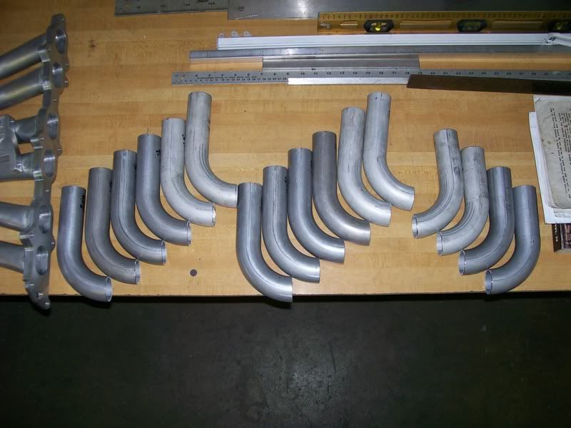

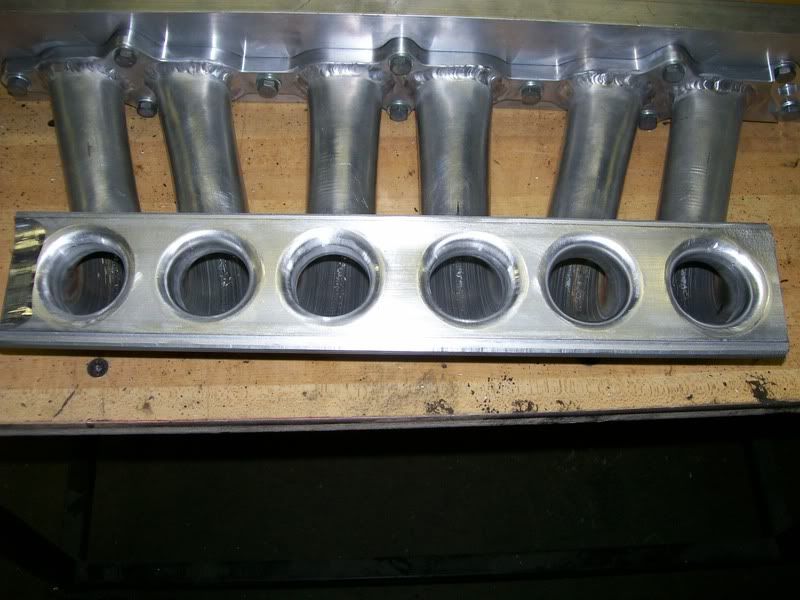

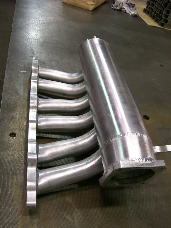

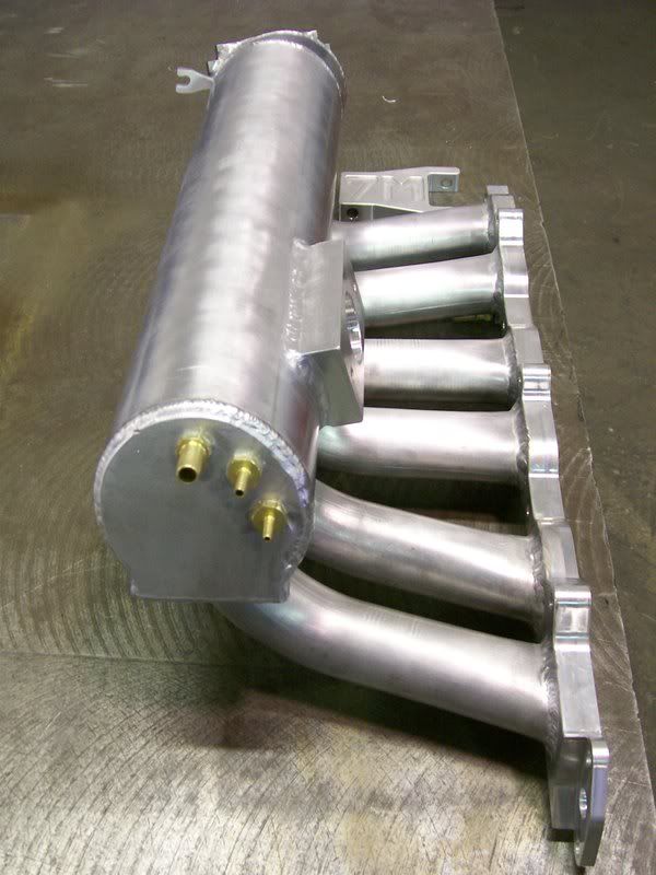

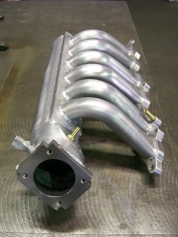

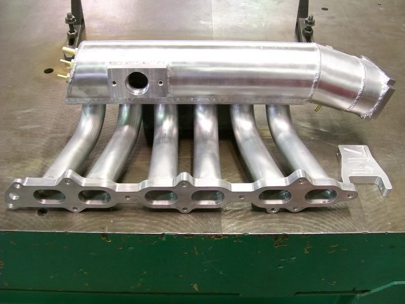

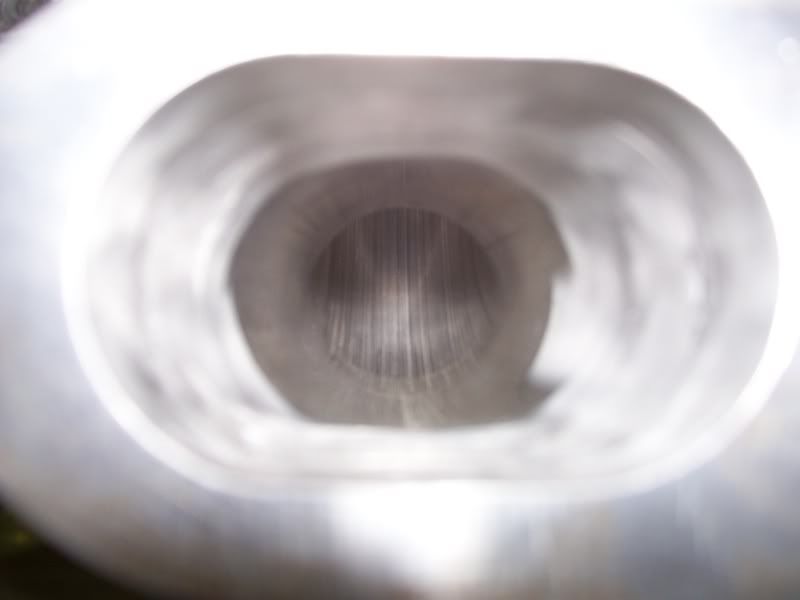

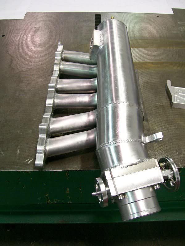

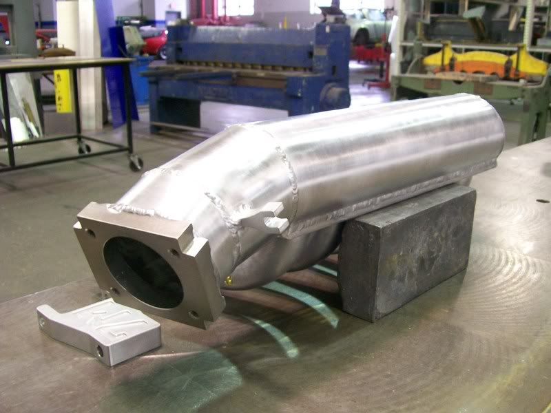

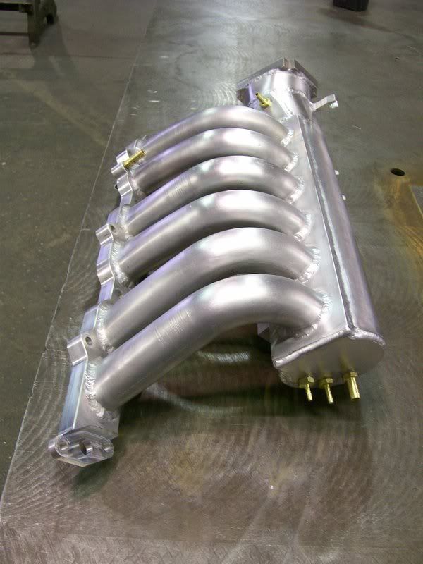

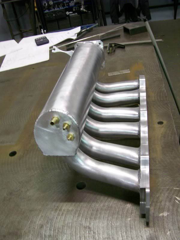

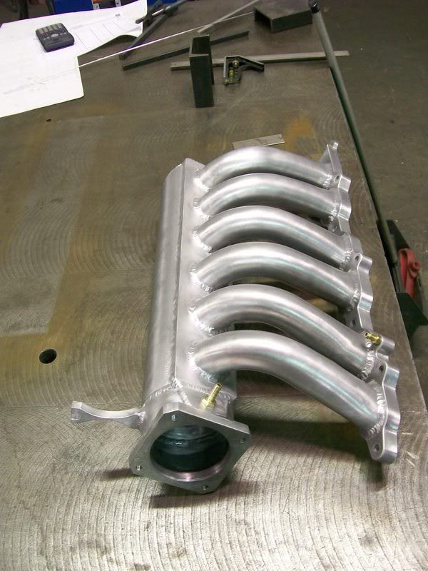

Well I have had the drawings and designs in the works for a long time and finally spent the money to have the parts machined to build a true fully custom long runner manifold.
Features:
-Manifold is fully custom from the head flange up
-CNC cut head flange
-1.75" mandrel bent runners
-near perfect ports
-near perftectly smooth runners
-NO core!
It is my standard long runner housing design and has basically the same angles and runner lengths as the stock manifold. And for those who are curious the runner volume difference is under .05 cubic inches. The manifold will sit exactly as my normal long runner manifolds do.
So let me know what you guys think!:
Porting:
(also you can see the warp plate I had machined to ensure the head flange would not warp!)
Thanks for looking,
Seth
I.....LOVE.......IT......:love:

IJ and Sethron - have either of you attempted to match calculated intake runner harmonics with dyno charts?

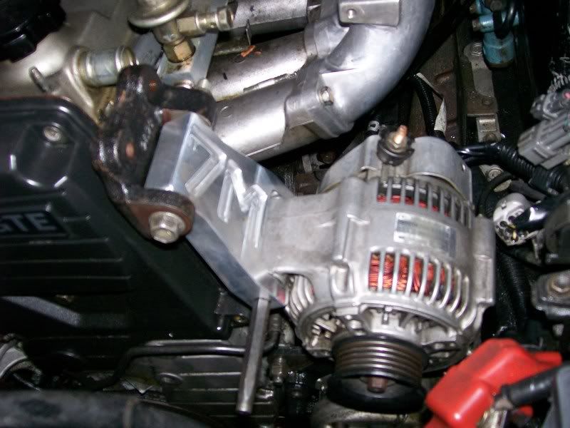

Hey Seth how much are these going for and will you sell just the alt bracket . I hate the way the oil line is pinched by the alt.
Matt, I have a bracket you can have...it's one of the older versions that I don't make anymore

Hey Seth, does your long runner require the alternator to drop down to where the ac compressor would normally sit?
