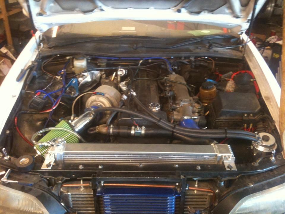

Running a S200SX myself actually, and i'm very satisfied with the spool and response. Very similar to stock twins, but with a lot more power at 4500+ rpms.
But I unwisely choose the 51mm, not the 56mm. The 51mm "falls off" at only 47lbs/min, so i'm limited to ~400whp
Mine is with a .75 A/R T3 Twinscroll footprint from AGP-Turbo, but response is quite good though....even on stock ECU i'm on 10 PSI at 3000RPM's and 13 psi at 3300. Positive pressures are seen around 2000 (Spool has started), and absolute no problems so far.
Thumbs up for the S-series!
