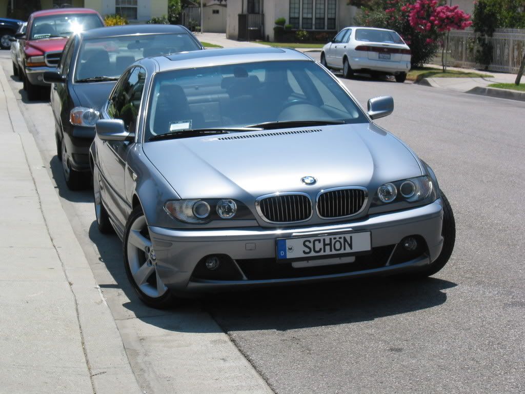

johnathan1;1206314 said:
I've never driven an E36, but I drive my mother's E46 more often than she does, and I can say that the handling is utterly superb. Especially with the sport package. Not a whole lot of power tho... :(
[thumb]http://img.photobucket.com/albums/v286/johnathan1/IMG_4368.jpg[/thumb]
Right on. E46's are nice cars, too. A bit heavy for my taste, but not as heavy as the e9x! That's a nice car your mom's got! :)
