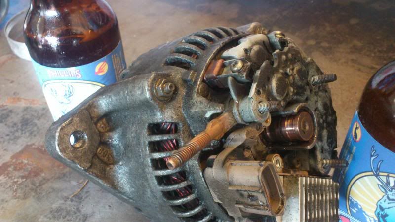

Well truck has new dd shoes and a new alternator

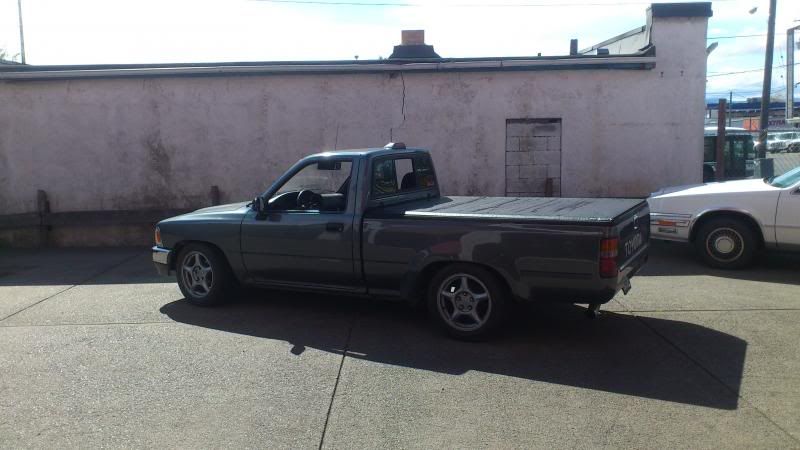

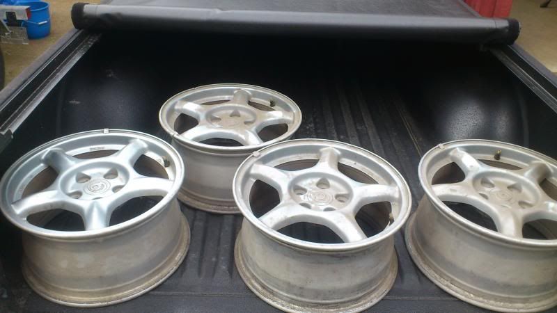

3rd gen rx7 wheels 225 50 r16 much better then my ****ty 14's
used up tell the slip ring was just to worn out at lest i got all the life out it if

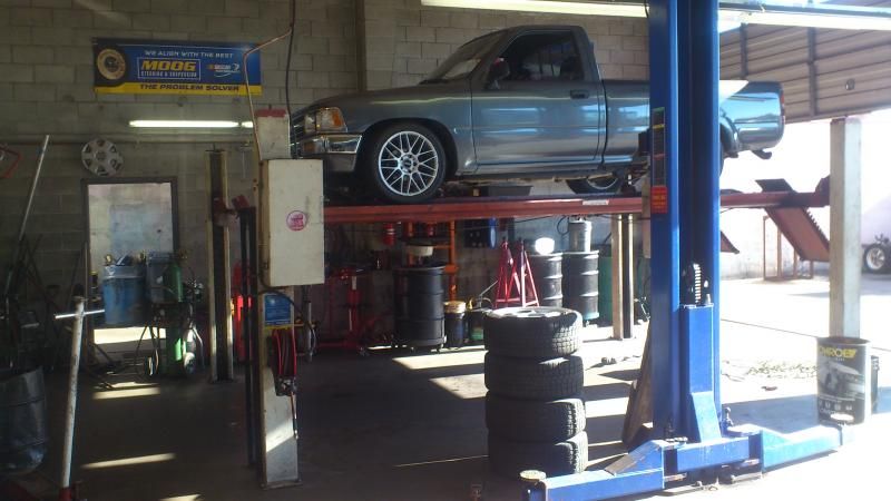

installing it at my work place

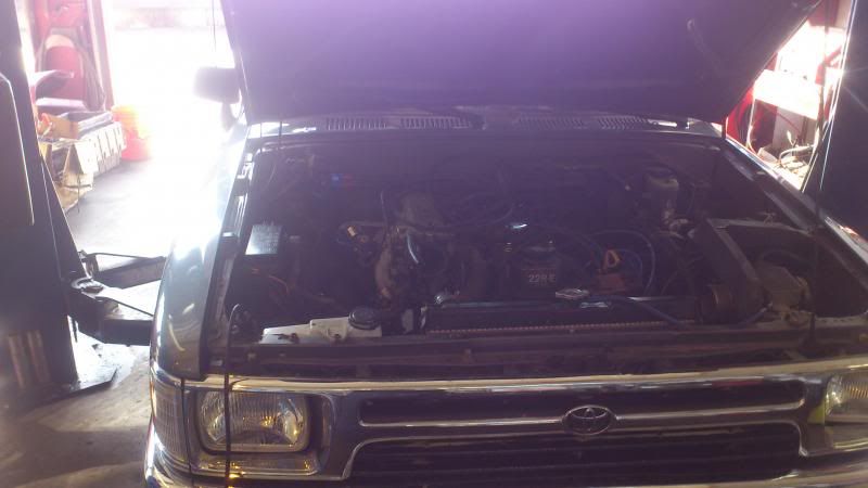

Well long over due for an up date I don't care to work on my truck in the heat because I rather drink a cold beer lol

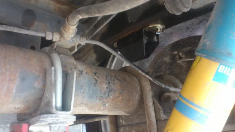

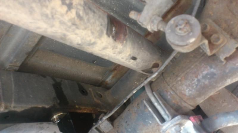

Any ways I have been trying some new stuff out in the truck and I removed my stock bump stops and in stall jeep ones so I could have more up word travel and then after that I had to fix some things
smash
won this off the snap on truck
getting placement ready

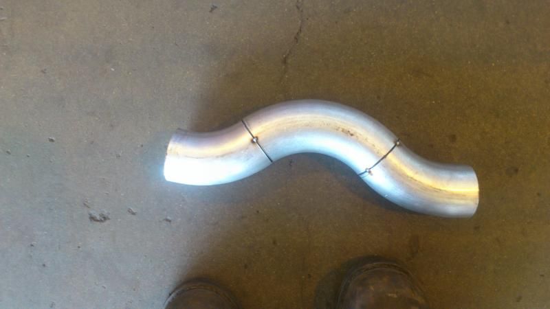

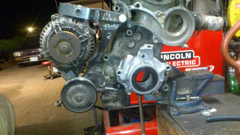

new alt relocation bracket
just have to trim it now and it's one step closer to rack and pinon woot woot

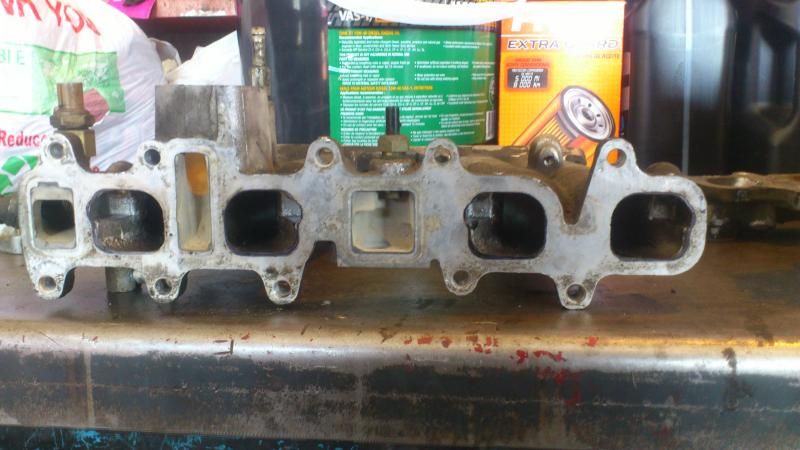

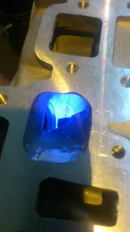

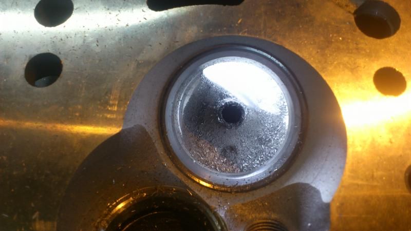

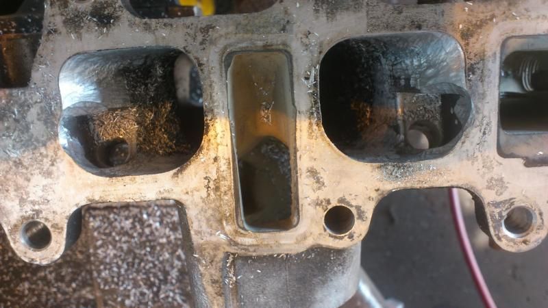

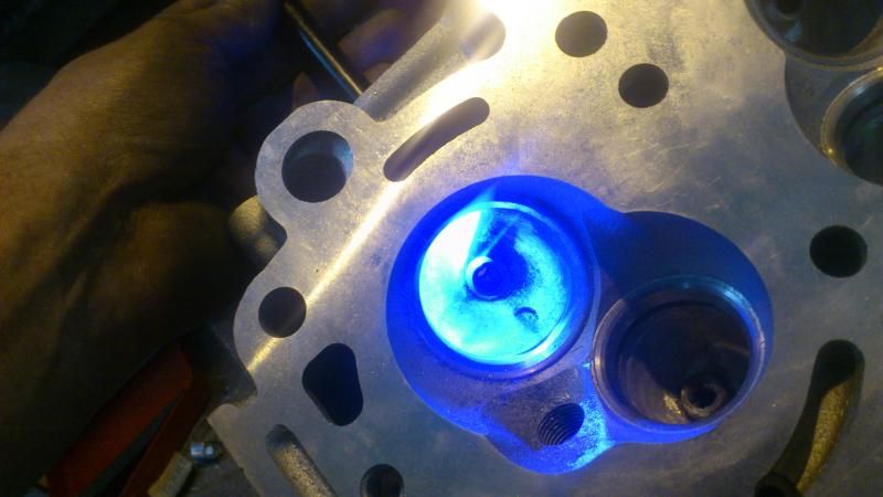

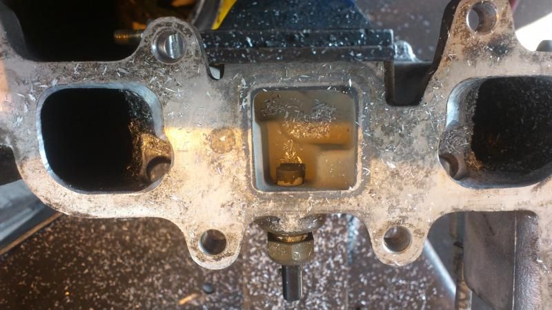

Well have been busy letting the shaving's fly

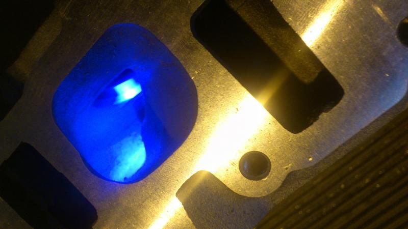

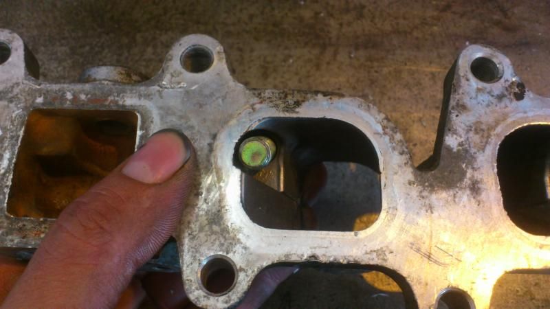

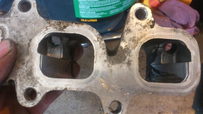

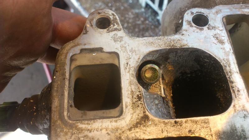

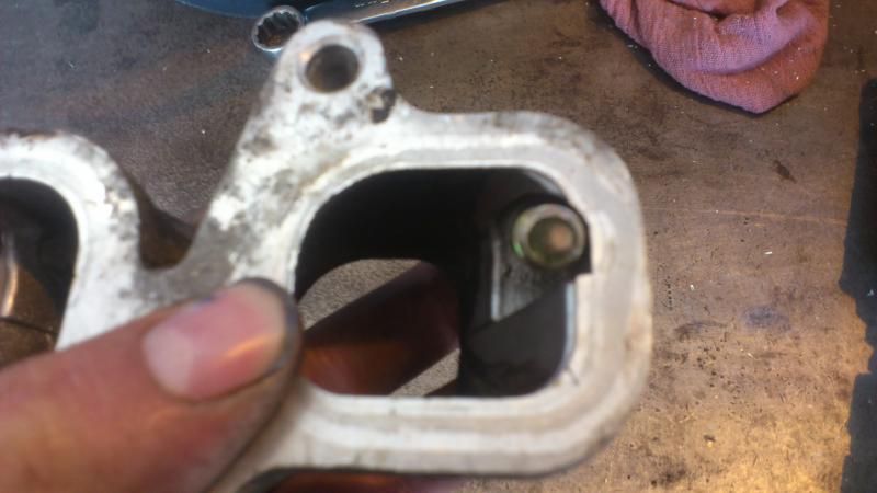

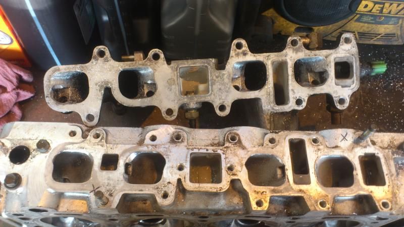

I gasket matched it and found there was alot of block age, mainly the injector but you will see this from the bolt I used as a guide line.
I am not sure why toyota did this but I fixed it
here is some pic's of what I have done so far
Nice eh but this only rough cut more to come

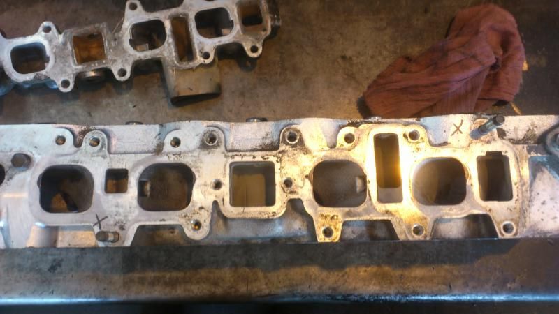

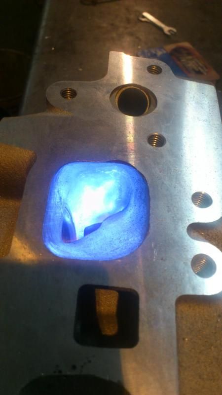

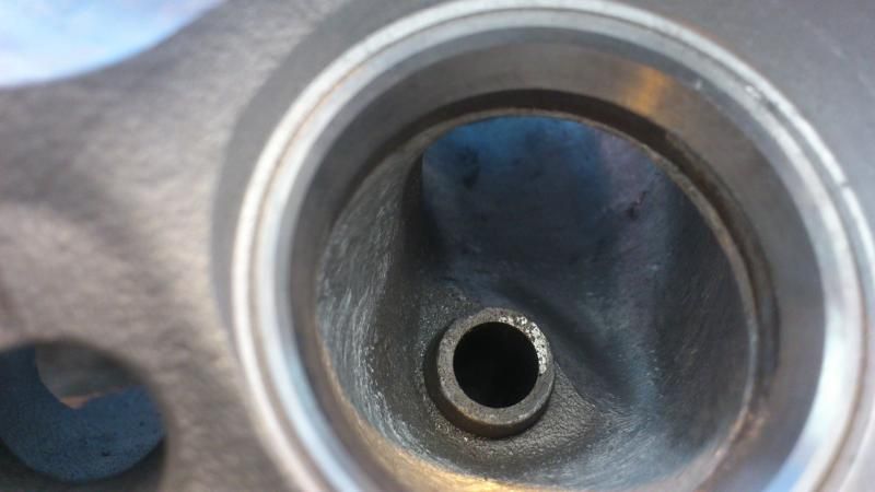

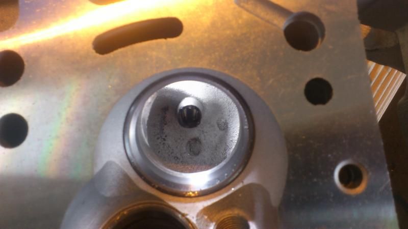

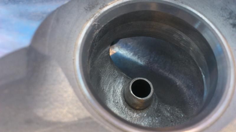

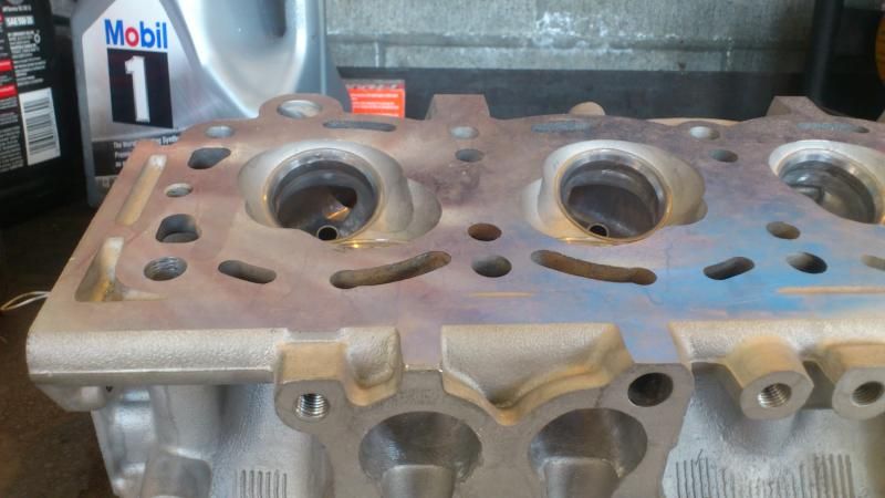

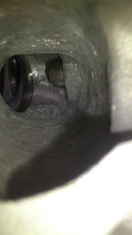

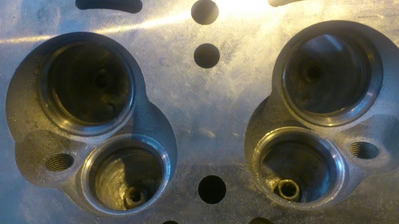

Well here are some pic's, I am far from done. I think i have taken just about 1/4 pound out of it
this is still a rough cut. I must say the 22re head is **** tell it is ported
ps photos are bad but I am working
