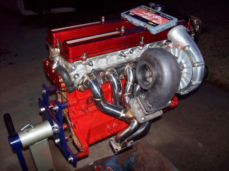

Just figured id post up some new pictures of the progress. The engine in the car is a mock up so I can dry fit parts and build the front facing intake manifold and exhaust manifold for the new turbo.

nice! did you get a whole new block, head, brake stuff and everything!?!?!?
that engine bay looks like it will look sweet...
i wonder what it would look like if you painted parts of your turbo that candy apple red... beautiful color.

xxxotiknightz said:
Looks nice. Did you have all the aluminum parts blasted or painted?
Titus
Everything was blasted. I'm actually going to be selling those valve covers, I got custom CNC ones coming that I designed to hold the 1J coil packs. I'm getting those Candy red also.
