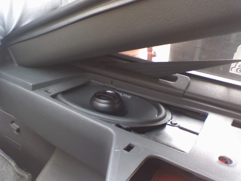

My old supra I fitted 5x7's in the stock boxes on the deck.

How'd you get them to fit? Just found out yesterday when installing my 6 1/2's in my 89 that my rear hatch speakers don't work on my 89, and I'd love something baller like that..
supra1008
May 2, 2007
1,179
Philadelphia
Heh. Pretty much took the speaker. Flipped it and centered it on the top of the stock enclosure. Made an outline of the speaker on the enclosure. Then took a dremel to it. Took a while cause I didn't have the right bit at the time. If had a good cut of wheel it wouldve been quicker and came out a lot better. It did stick out like 1/4-1/8" cause the enclosure width is just shy of the 5" or the speaker was a little wider than 5". I think there is more pics on my old supra thread.
