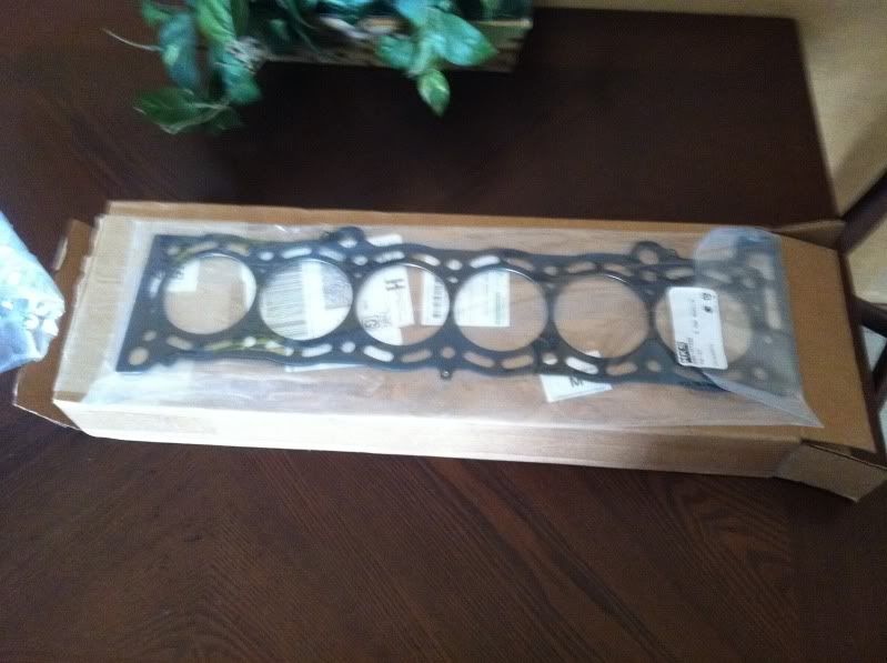

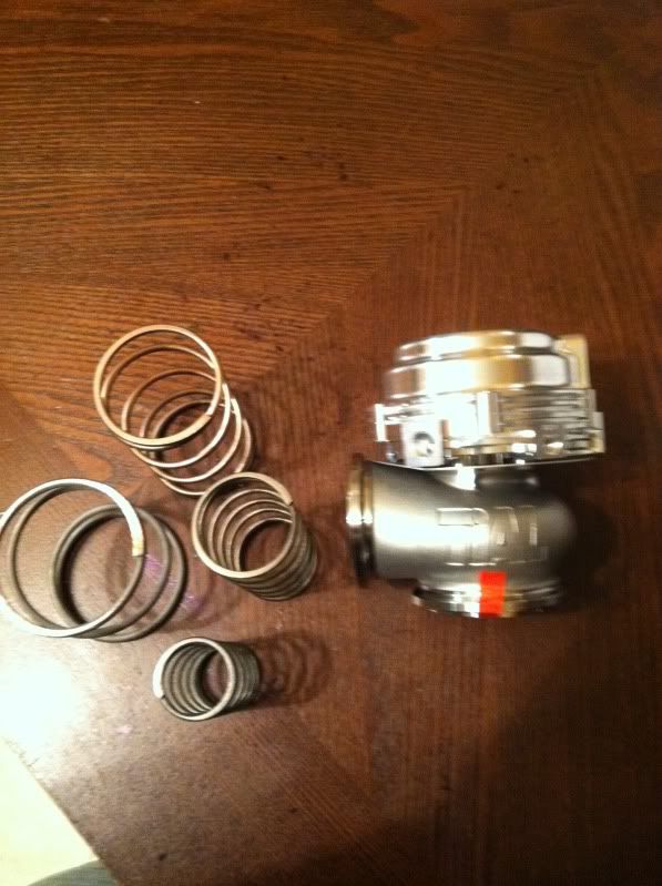

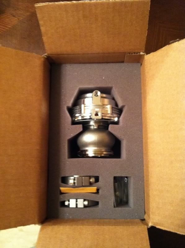

Ok lets do this again, last year I was supposed to dyno the supra but the night before the dyno I did a compression test and it had low compression of 75psi in one of the cylinders. So the dyno was cancled. I bought a used built block from one of the members on here. The block was built by L&R performance out of Santa Fe Springs, California. I also bought a hks 2.0mm stopper head gasket and the new design Tial MV-R 44mm wastegate for the setup. Hopfully things work out good this time so I can dyno the supra this year. Wish me luck. Here is the link to my last build thread..............

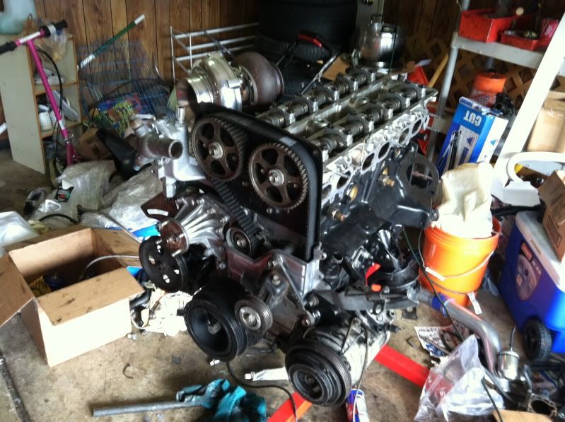

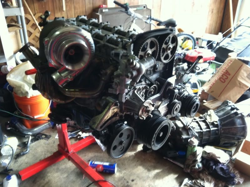

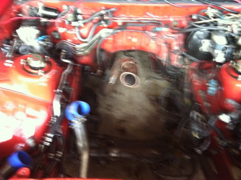

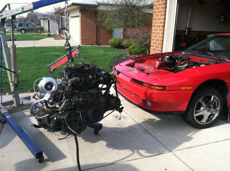

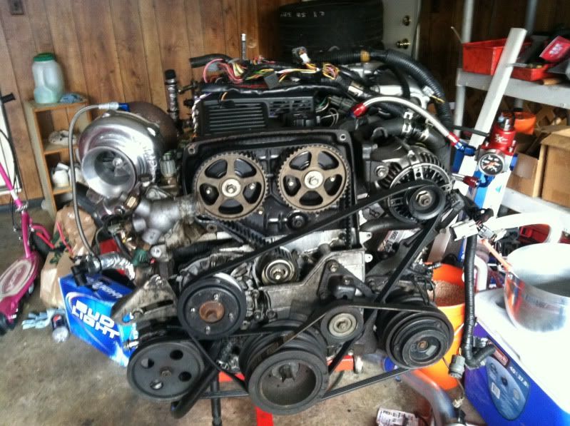

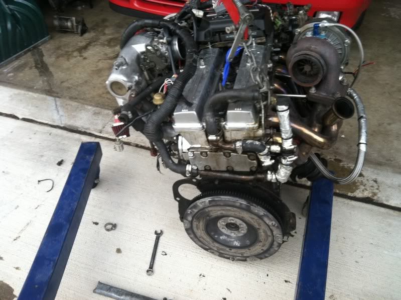

4/23/11.........Today was nice day in Michigan so I decided to start working on the supra. Pulled the motor out, separate trans from block and motor onto the engine stand.
More to come...........

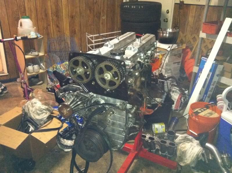

I will be working on the supra this coming weekend, trying to transfer everything from the stock block to the new built block. Clean out some stuff and parts getting powder coat.

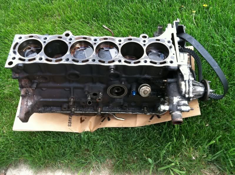

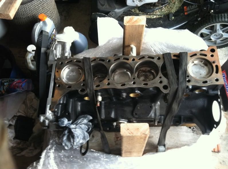

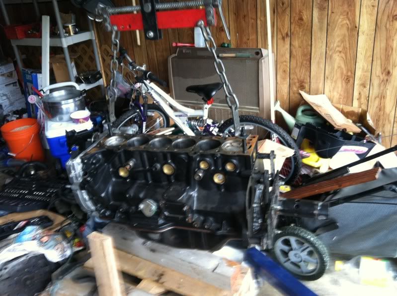

Update.....5/7/11
Got some work done today.

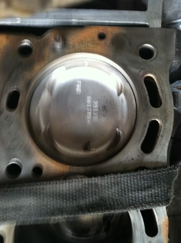

There goes the old block.
Built block lift off.
Getting there, but far from finish.
All the dirty parts are being clean and sand blast.

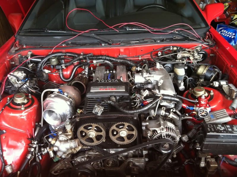

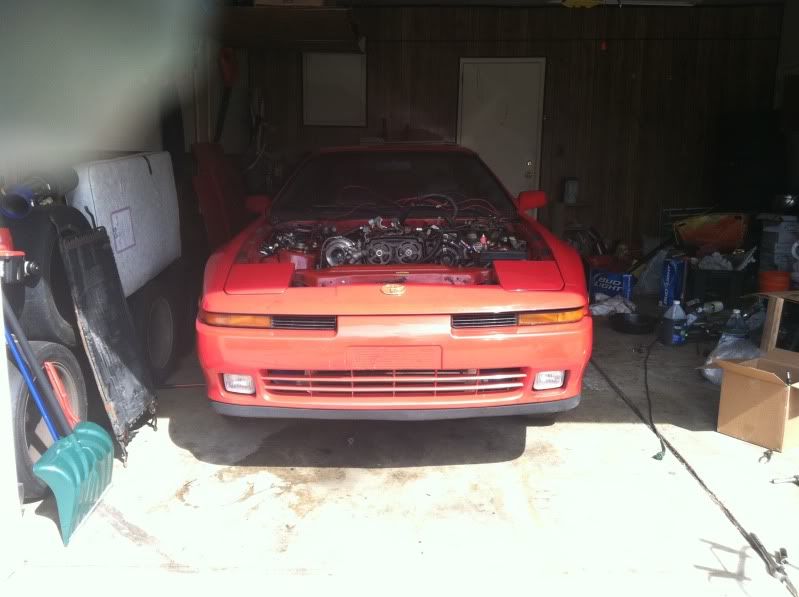

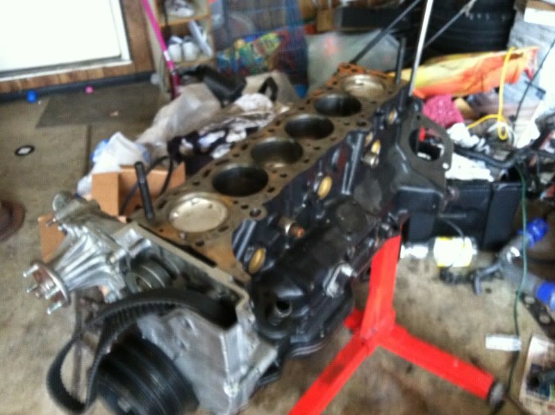

Update........5/21/11
Got some work done while the world was gonna end, but it didnt end so i got a little further than i expected.
Still waiting for the valve covers and intake manifold. It being powder coat.
Sorry, garage is freakin messy.
