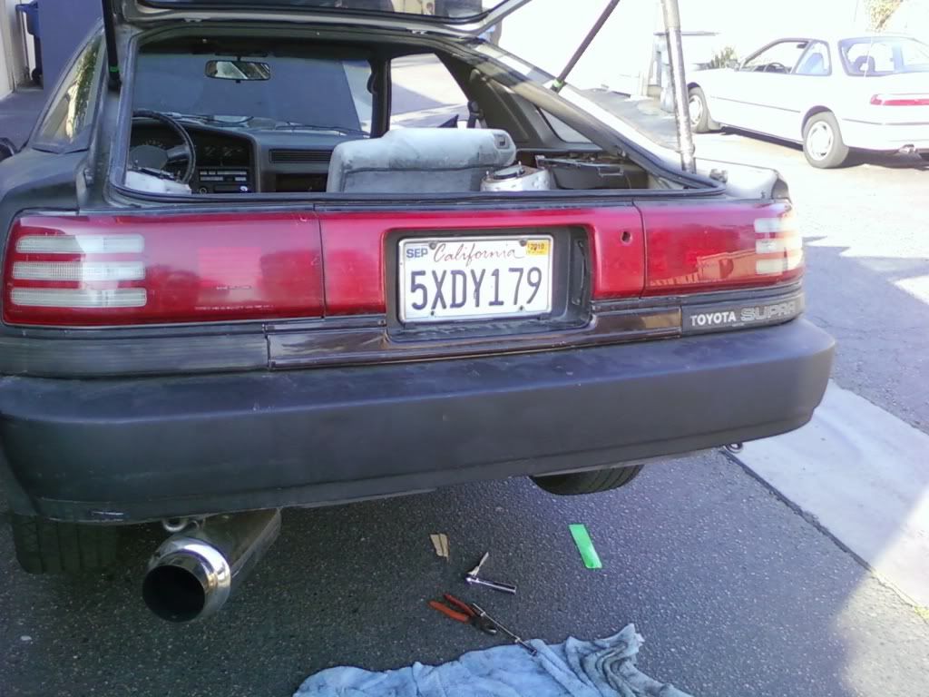

yea bolts right up I did it.

New to Supras huh? Yes, most items will change over from one year Mk3 to another. About the only thing I'm aware of that bears any significance is the electrical related bits, i.e. the brake light failure module.
nope, brake light failure box is only for the 3rd brake light (CHMSL), so if you don't change the spoiler you're good to go. You do need the 89+ bulb holders, but that should come with the taillights themselves
6,622
No kidding huh? Well I guess I learned something new today, thanks for the correction. :)
And what kind of cheapass ships taillights without the bulb holders? They're pretty much glued on anyway, right?
