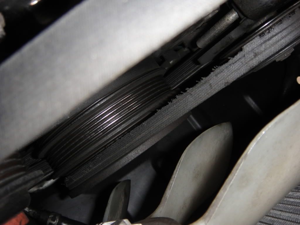

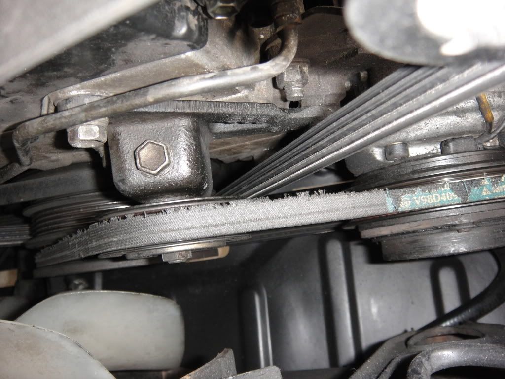

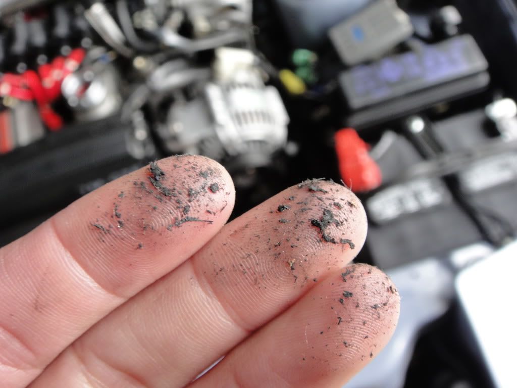

Ok... I discovered that the A/C belt is frayed... causing hellish squealing at start-up... uploading pics now, can overtightening of the top pulley cause this?... and I got my new steering rack
Since I don't have the tools right now I think I may have to drive to toyota asap and have them replace the belt and perhaps do a tuneup as well...
---------- Post added at 01:15 PM ---------- Previous post was at 01:09 PM ----------
pics:
the bits of belt my underpanel caught
