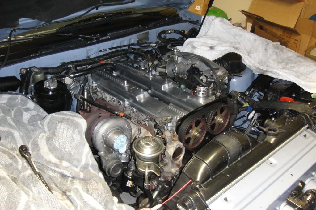

Ok... updates.. had a ton of help from SA Supra, thanks man!!! we got the head off today :D

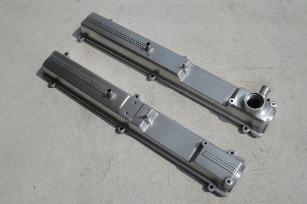

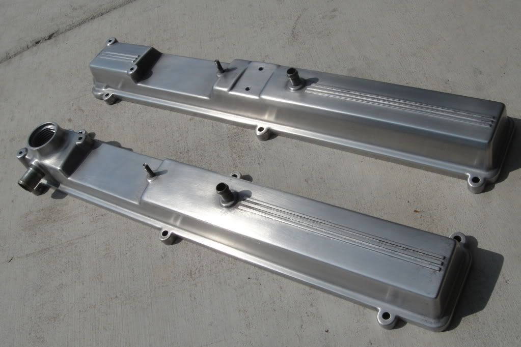

Old pics: I painted the Apex'i adapter and sanded the letters so they shine through the paint
And the valve covers after 80 grit

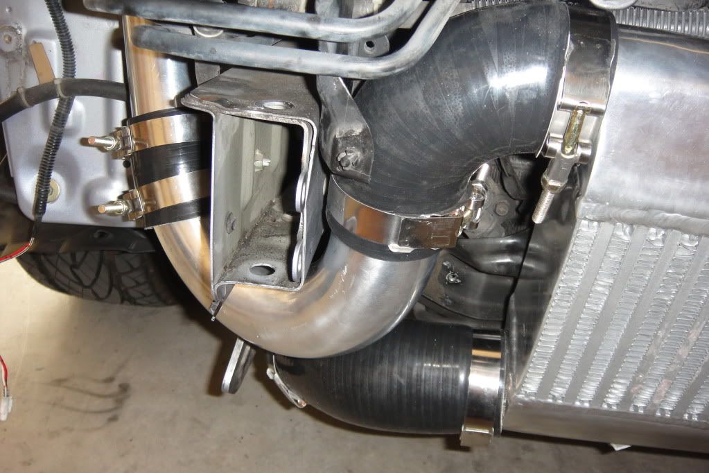

LoL thanks... thats not all :D was uploading pics... (btw that adapter got.... banged up... during my IC piping install >_< but it's not too noticeable so...)

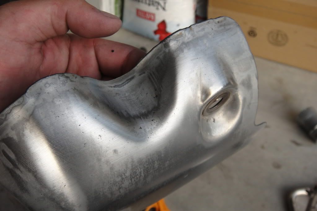

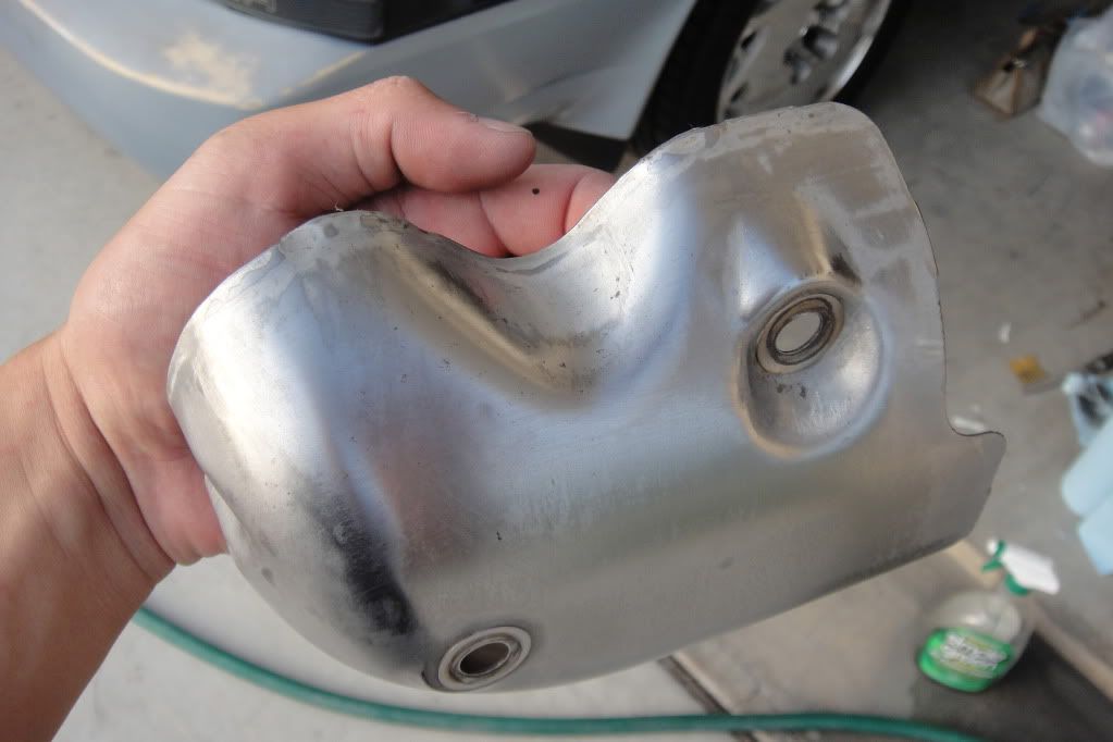

tried to polish the heat shield... but... the steel was different hardness due to HEAT LoL... it was like polishing my katanas... soft at some places and hard as hell at others

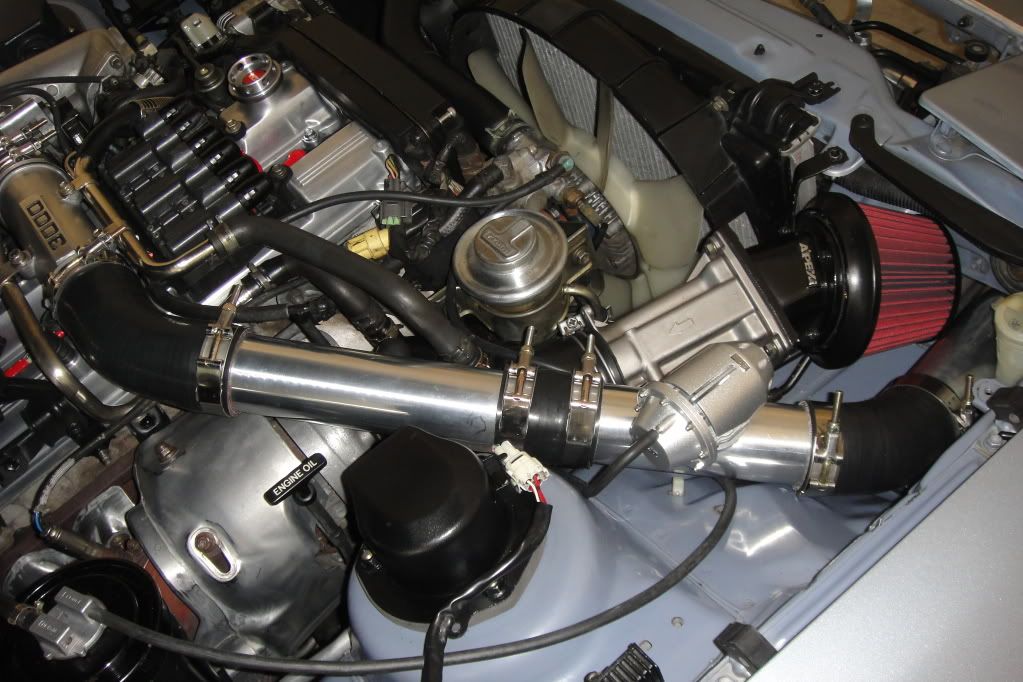

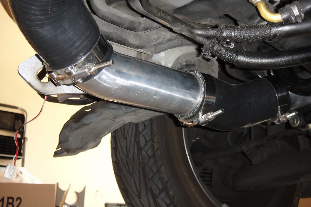

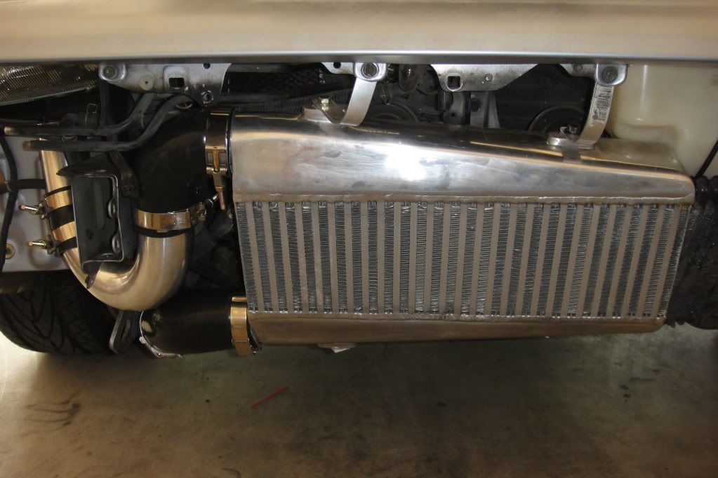

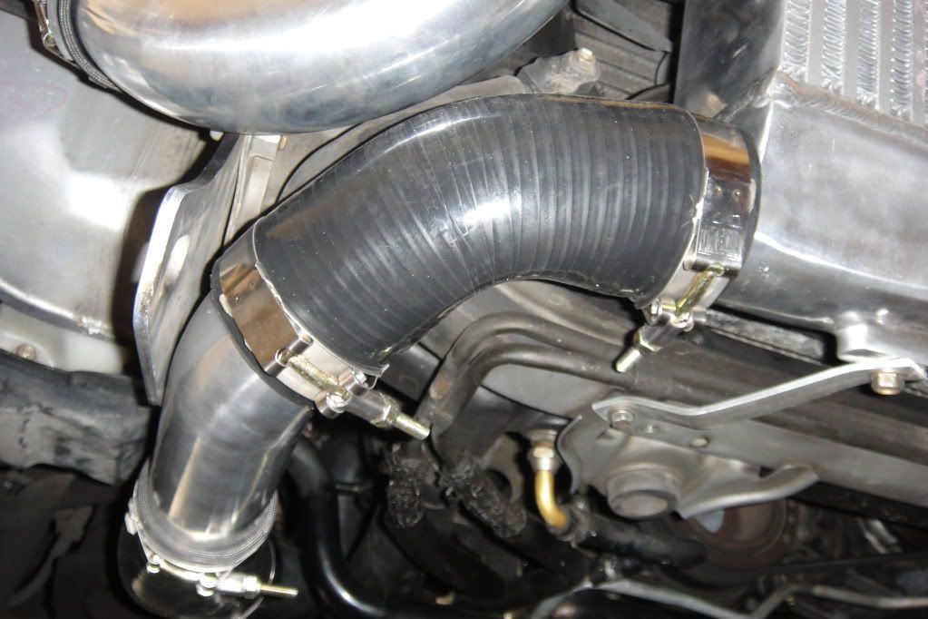

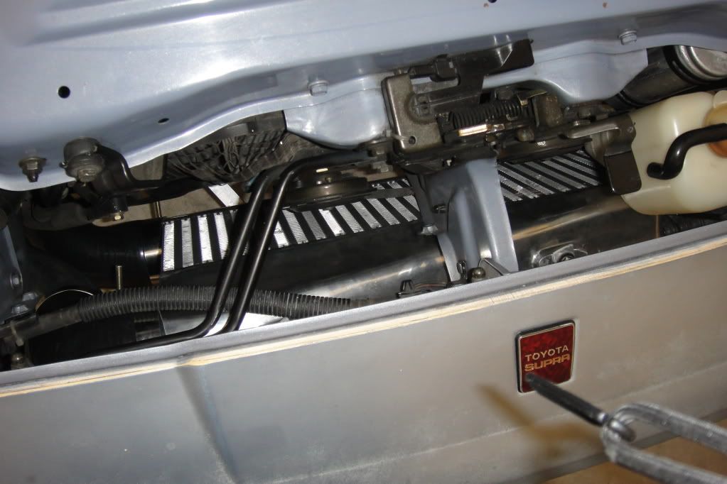

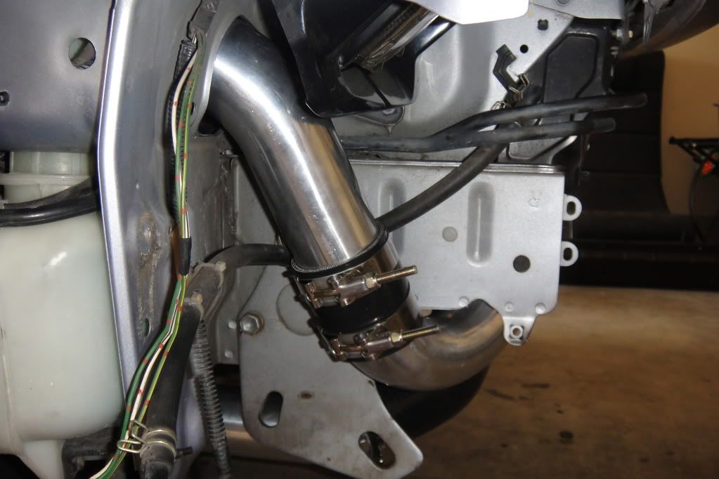

Finished my piping
hacksaw work... LoL
more custom fabbing with provided pipes
left the toyota badge off... =/

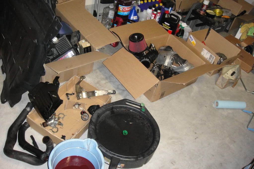

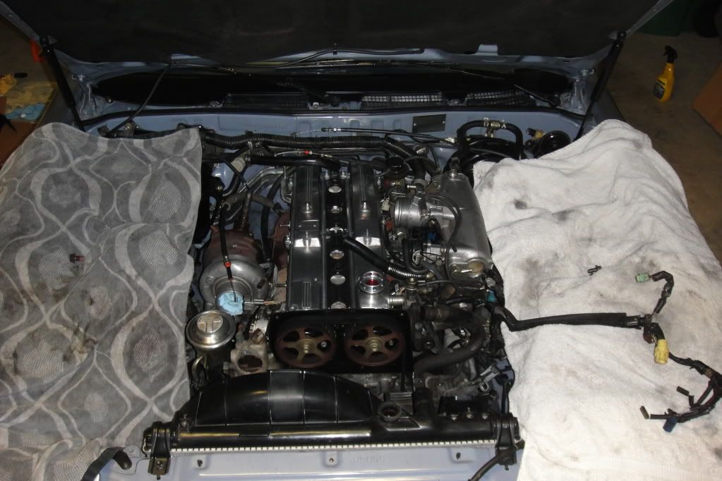

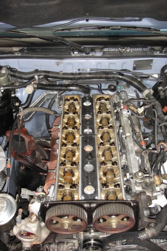

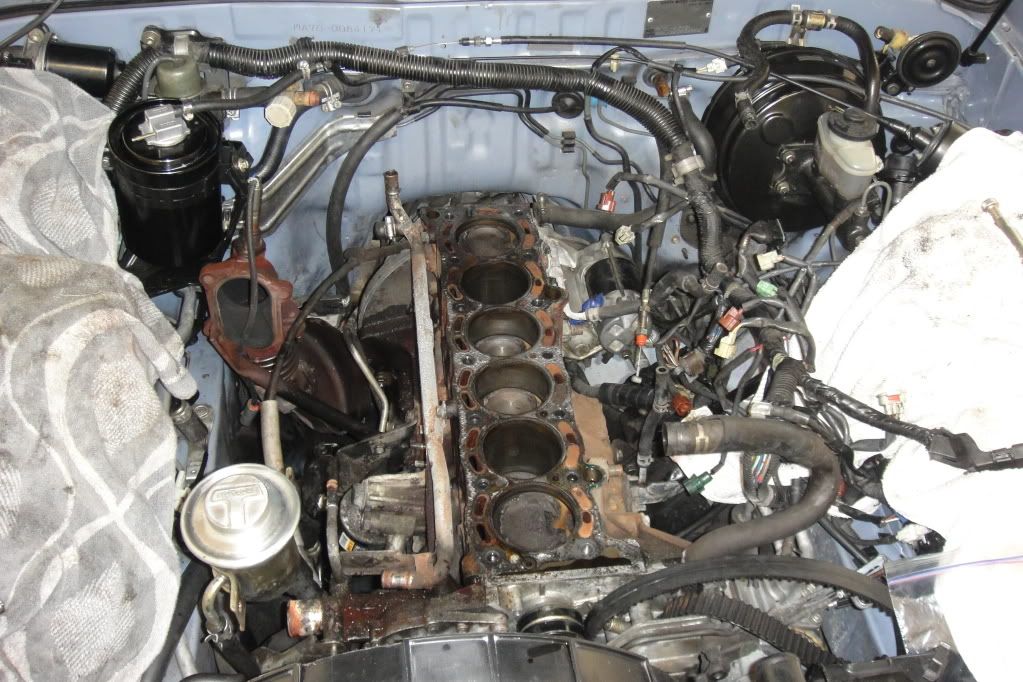

Starting to strip for HG job

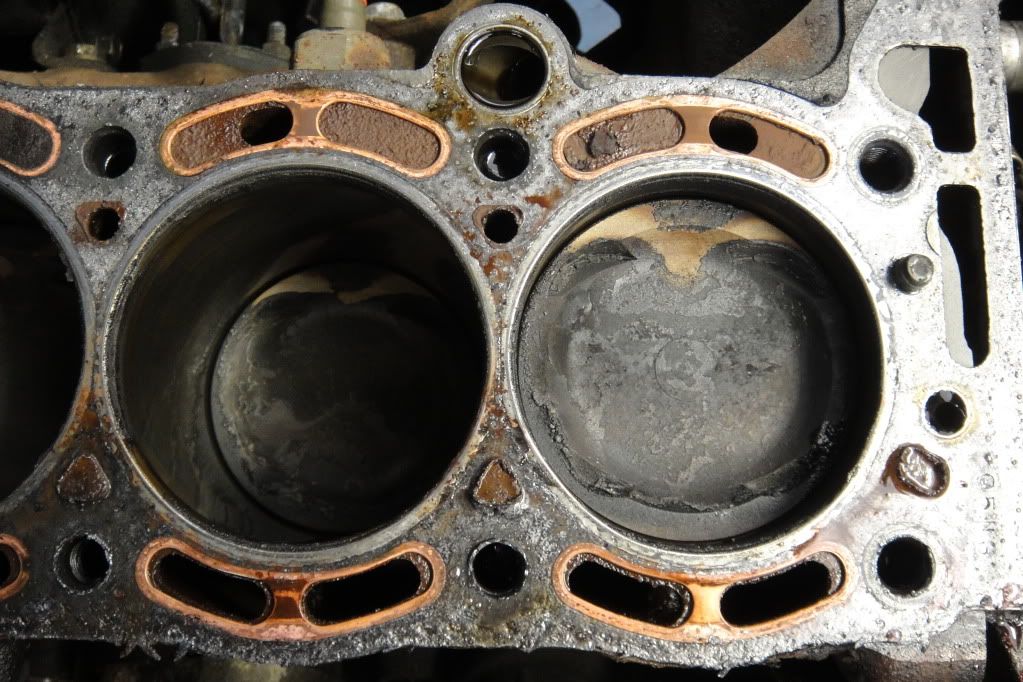

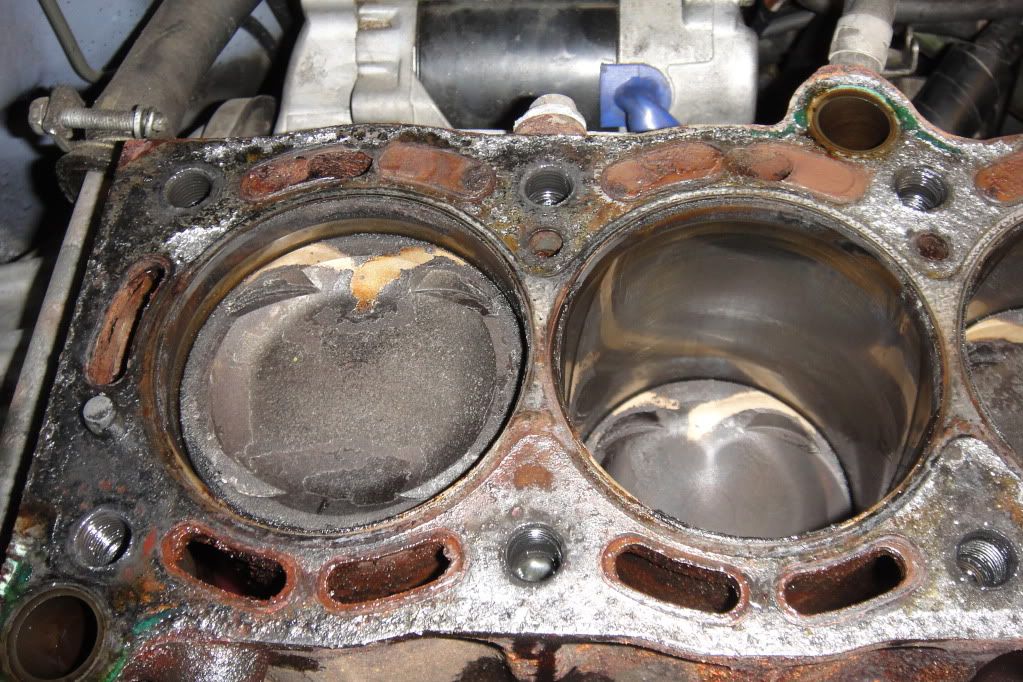

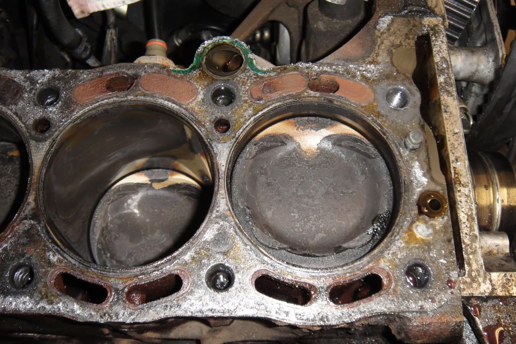

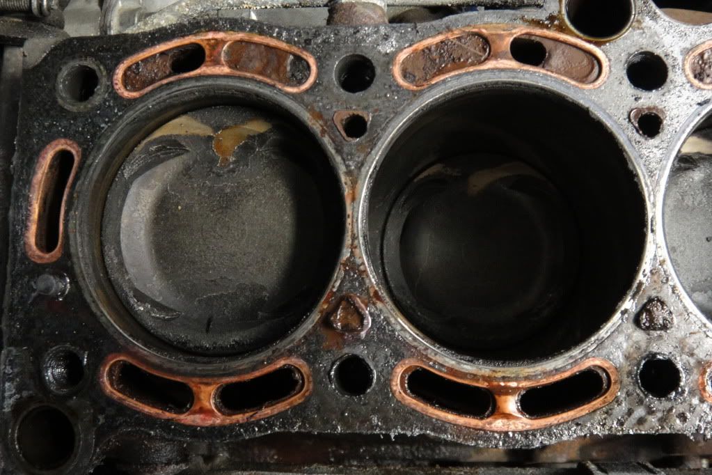

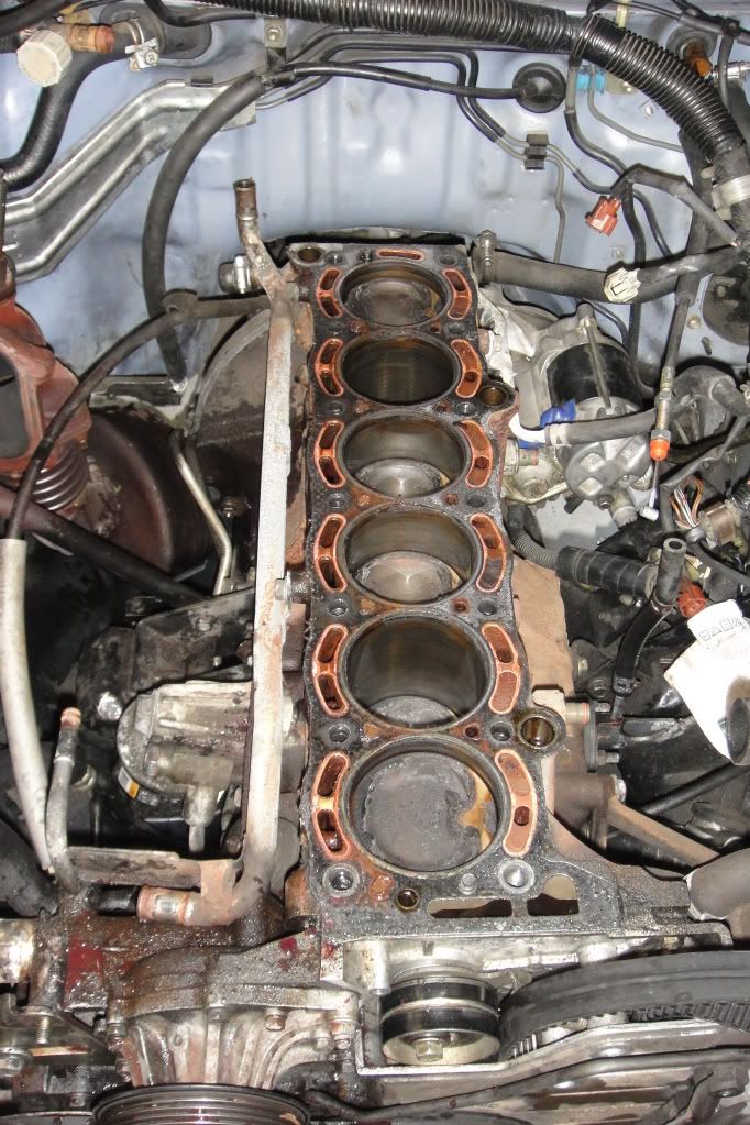

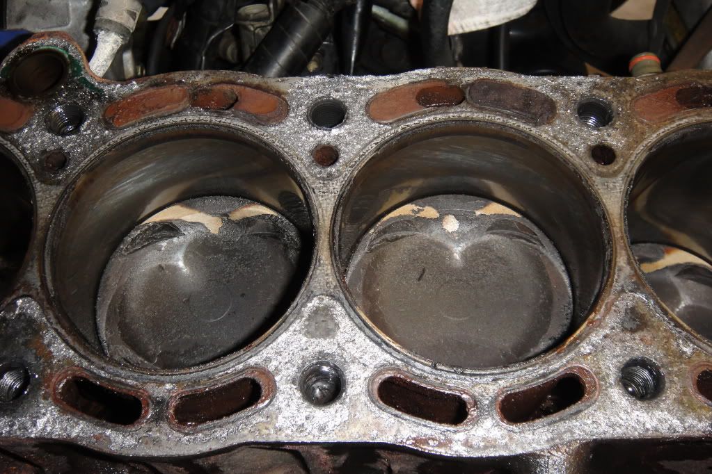

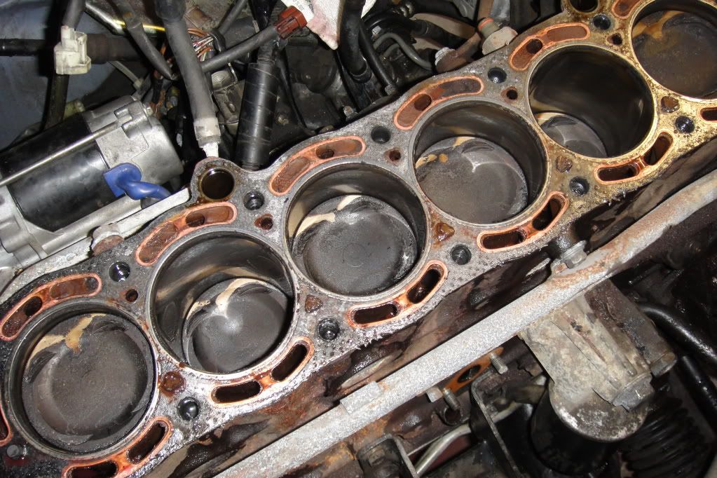

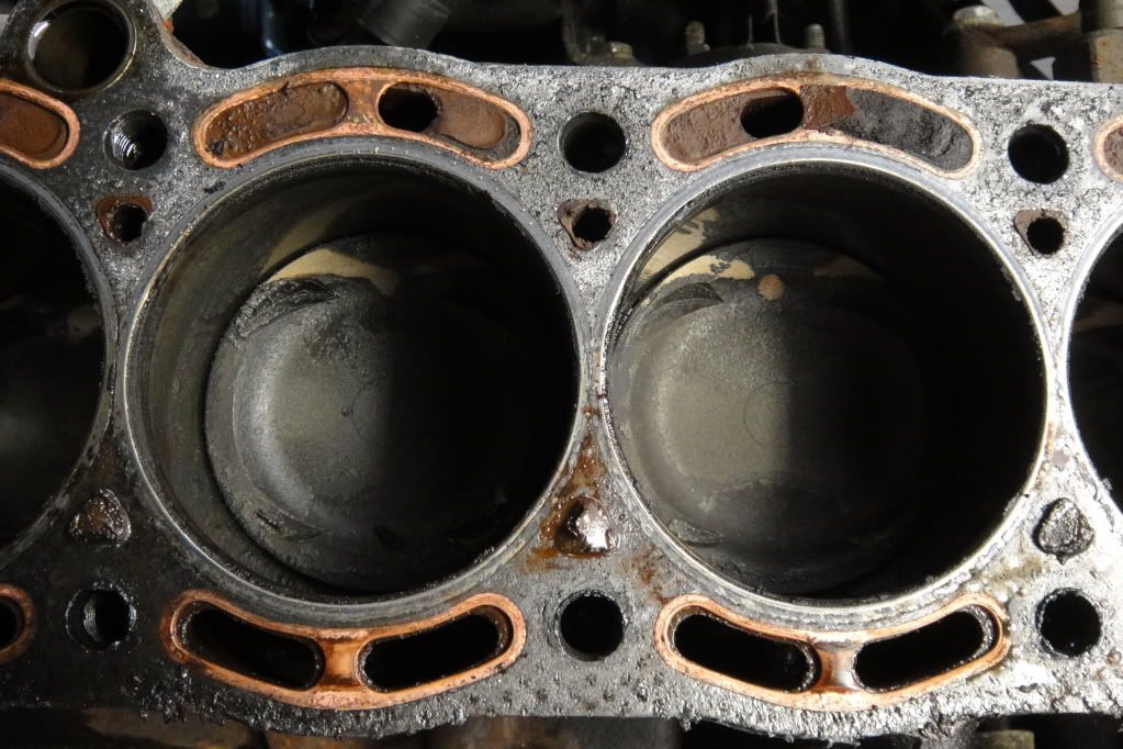

OK now for pics of the block after San Supra helped me pull the head
1 and 2
3 and 4
5 and 6

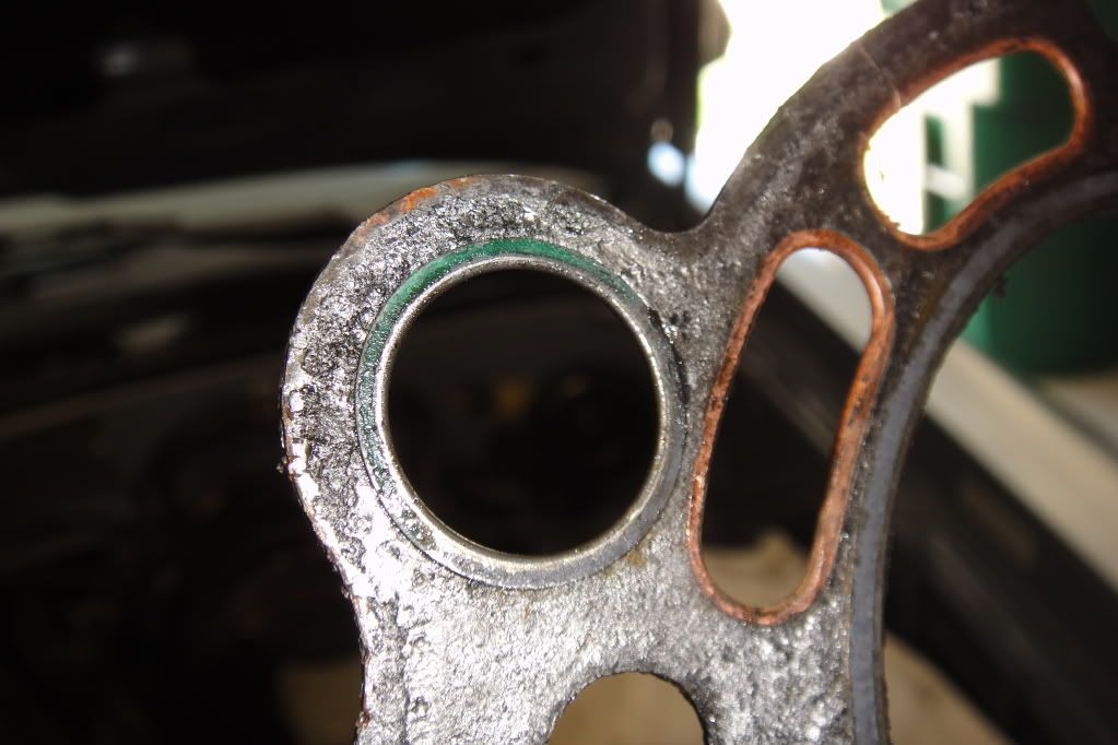

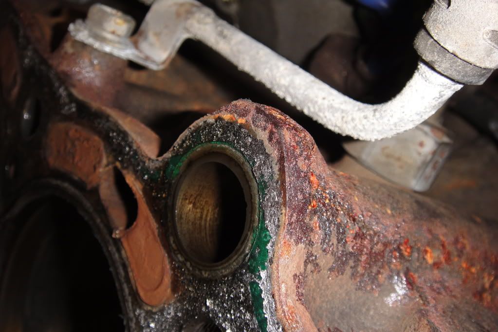

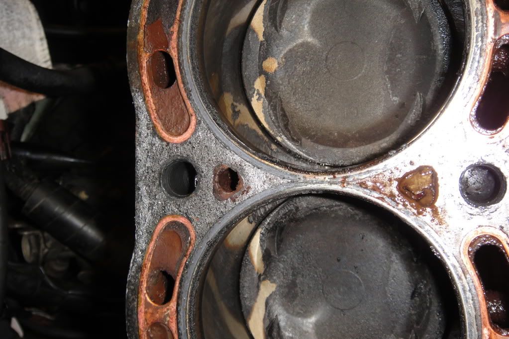

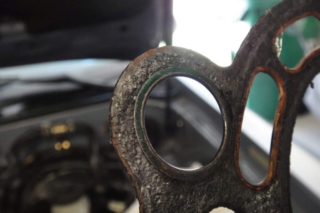

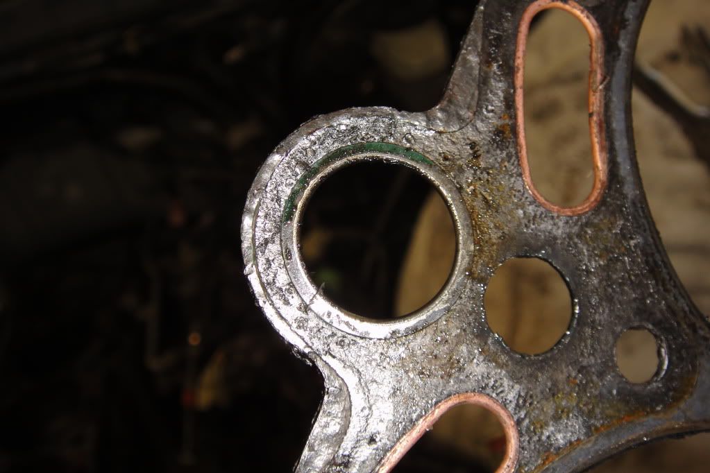

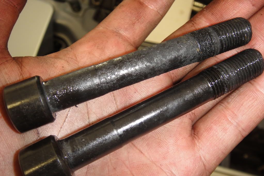

This is where bolt number 14 was... bolt 14 was corroded... not sure why, if anyone can see something we didn't please say so

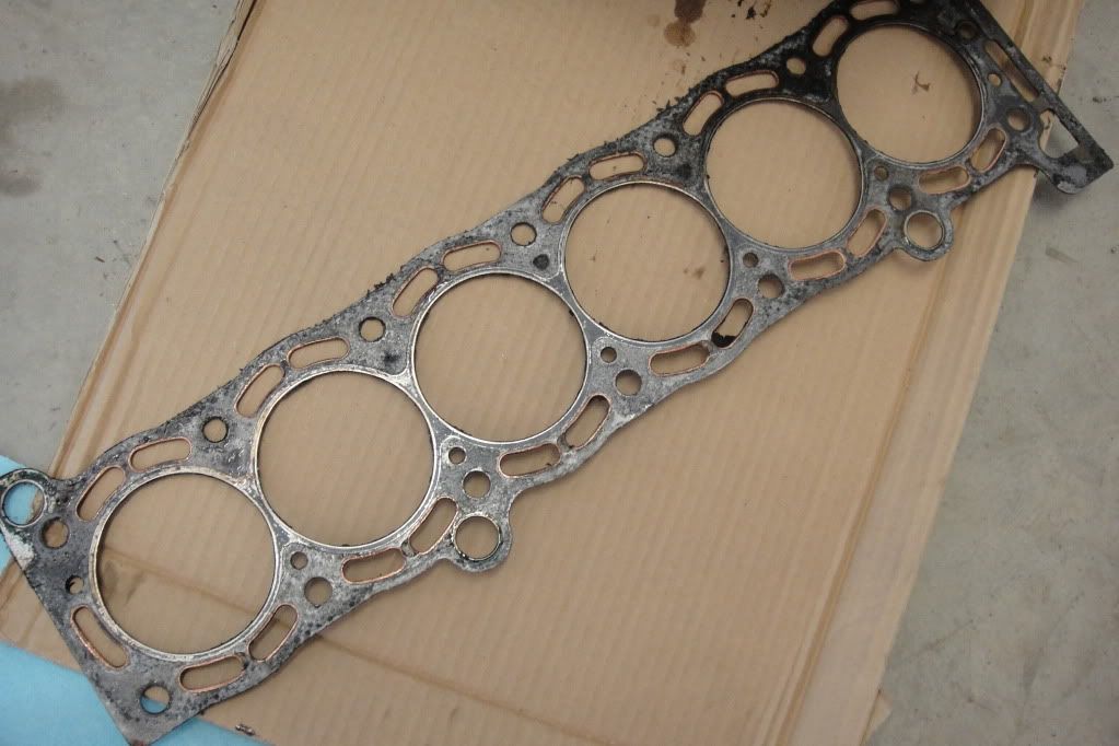

Top of HG

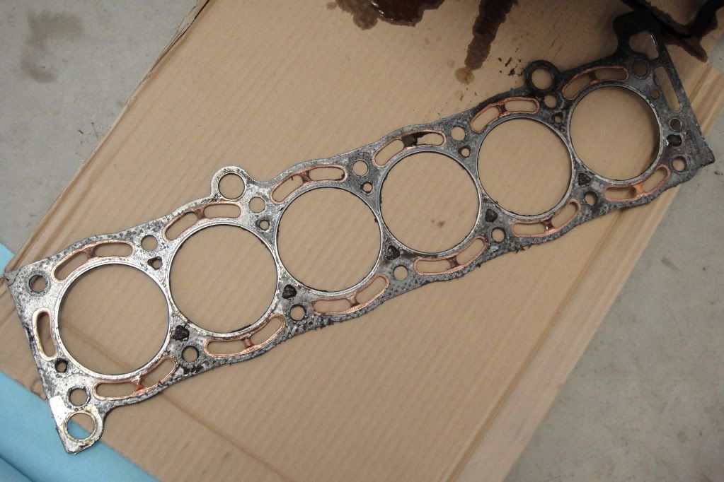

Bottom of HG
1 and 2 HG off
3 and 4 HG off
5 and 6 HG off
Bolt 14 with another one that was fine like all the others
where we think there may have been a leak allowing air into the coolant passages
Good seal
Potentially bad one??

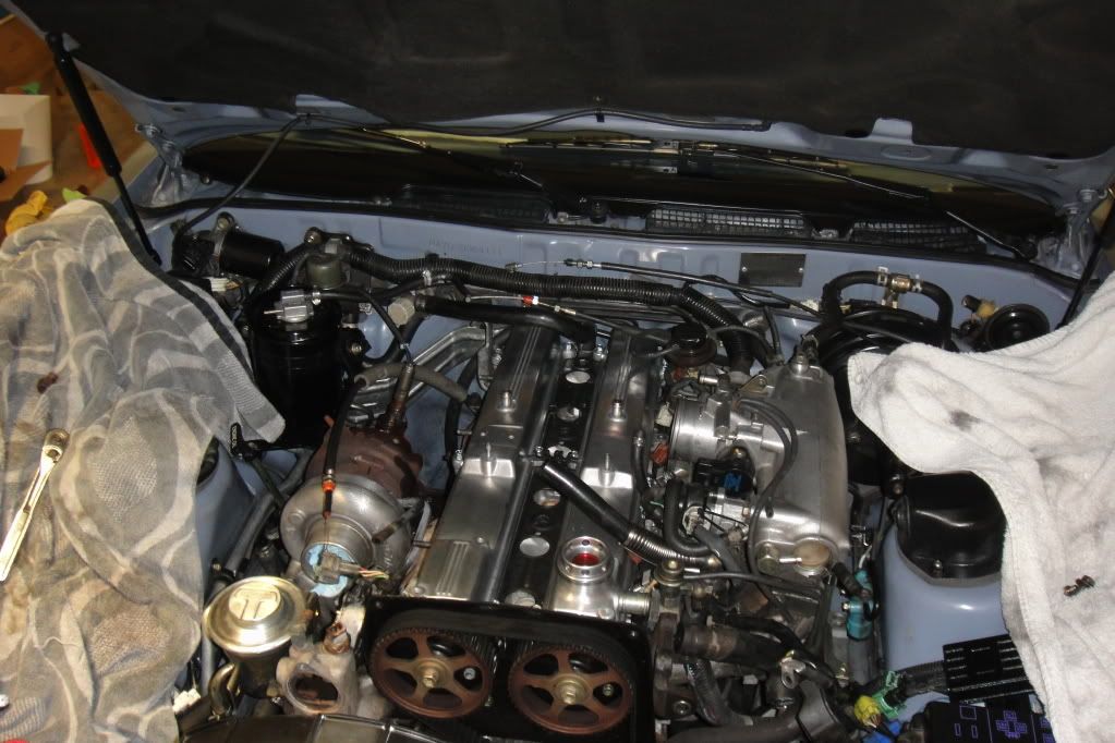

As she stands now
If anyone has feedback feel free to post... I now have the task of cleaning the bejeebers out of my engine parts and prepping for the installation of new OEM HG

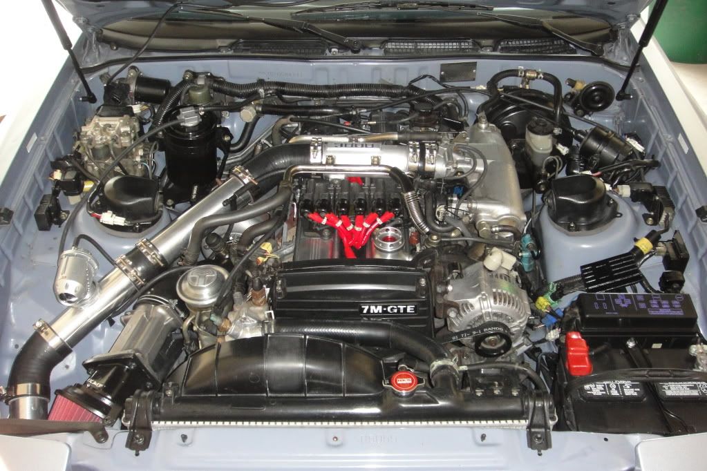

Yes and no... It wasn't the actual 7mgte kit. I got the spearco replica IC with the 2.5 inch universal piping kit. Also note that I took driftmotion's idea of cutting off the narrow end of the 3k pipe so I can run 2.5 all the way through (except the turbo at 2in...) LoL Boostcraver yeah... I mamaged to set it up so I could rotate the adapter so the logo shows... :D
