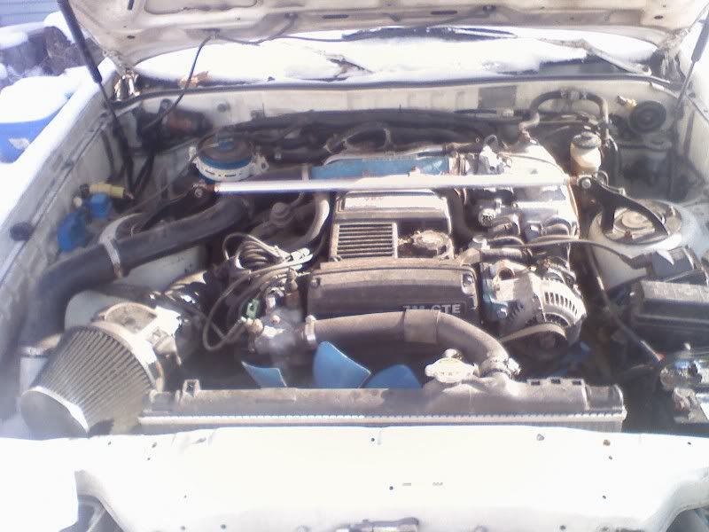

I just picked up an 87 N/A supra with a JDM 7MGTE swap complete running just fine with a R154 transmission
Now I do have some concerns, it still has the 7MGE wire harness. Wouldn't that cause some problem's?
I believe it has the 7MGE fuel pump will that cause a problem?
It still has the 7MGE MAF sensor, what will that do?
7MGE ECU is that a problem?
I also noticed it has a distributor instead of the coil pack is this hurting the 7MGTE?

ok so hes running a GTE on non turbo harness, ECU, Flap type Air flow meter, distributor, what injectors are they, does it have a timing retard device?

I don't know what injectors are in there yet. I'm going to check tomorrow.
There is no timing retard.
I'm worried that the GE ECU has me running lean so tomorrow I'm going to hook my a/f gauge and find out for sure
I was hoping that maybe someone had a similar setup
I'm hoping a piggy back could solve these problems?
I can take more pictures tomorrow.....Any specific angle's or close up's you want to see?

lol the more I think about it the more I was confused.....But the car so far has run fine and is pretty quick the guy ran a 14.1 he showed me the slip.........I'm going to find out if I'm running to lean today if so I'm going to get a piggy back not sure which one to go with yet...Get a bigger fuel pump, injector's, and going with individual coil packs...I also plan on getting a fuel cut defender and turning up the boost.

Yeah, the only way to tell if it really is a GTE is does the oil drain and oil feed for the turbo really exist in the block or is it tapped into the oil pressure sending unit and the oil pan

I guess everyone thought that you got ripped off or was scammed into recieving a NA/T because it's still using all the 7M-GE parts for some reason.
Reguardless, I would say that you should go ahead get a Innovate or AEM wideband to install in the car if you don't already have one laying around. If you're planning turning up the boost I'd change out the afm, injectors, ecu, throw in a Walbro, and get the GTE coilpack. All of which could be had relatively cheap for the 7M. I'm sure you'd be find with the stock afm for the gte and 440s (if your car doesn't already have them) or you could go ahead just upgrade to the 550/Lex AFM provided you have the proper fuel mods.

Ok just ran this by my bro. You are prob for sure running lean man and yes a piggy back like a neo will help you out. As for me I would change it all over to the correct set up. But that's just me man.

Take it easy, dude, throwing the attitude back won't get anyone anywhere around here. What you appear to have is a N/A->T, which could be many different types of bastard swap. You could have a 7MGE block with a turbo slapped on the side, thus retaining all the GE electronics, you could have a GTE block with all GE electronics. There are a few ways to tell, if you're interested I'll make a little list for ya to check/verify a few things to properly determine what you've got there. Since you're running on a GE system, I'll guess that you're probably running lean with no extra fuel control. We don't know if the pump has been upgraded, or if the fuel pressure regulator has been swapped for a GTE reg, or even the injectors.
Take pics of under the intake manifold. If there is just one knock sensor in the middle, could be an N/A block. If there are two knock sensors (one in front, one back near starter) then it could be a GTE block, or a GE block modified for two knock sensors. Take some pictures of the oil feed lines going to the turbo, the oil pressure sensor, and the oil dipstick location. Grab the part numbers off the injectors for us, too. Is there an oil cooler on it? And do a compression test, and let us know the numbers if you can. (this could tell us whether it's got N/A pistons or Turbo pistons)

Stay away from any fuel cut eliminating device. That's a quick way to kill your motor. Besides that, the GE ECU doesn't have a fuel cut like the turbo ECU does, which is bad in my opinion. The GTE electronics are much more sophisticated in this area, and for good reason. (run lean = boom)

Ok you guy's got me worried about what block I have so tomorrow I'm going find out for sure. I will take the pix and post them up. The did provide receipts but that doesn't mean that engine is in my car.....This is my second turbo supra but the first time I have seen a setup like this. I have an a/f gauge I didn't get to hook up yet but I will tomorrow or wednesday......I did check the injectors there GTE injectors and there is no tap into the oil pan and no external oil pump but I'm better safe then sorry
