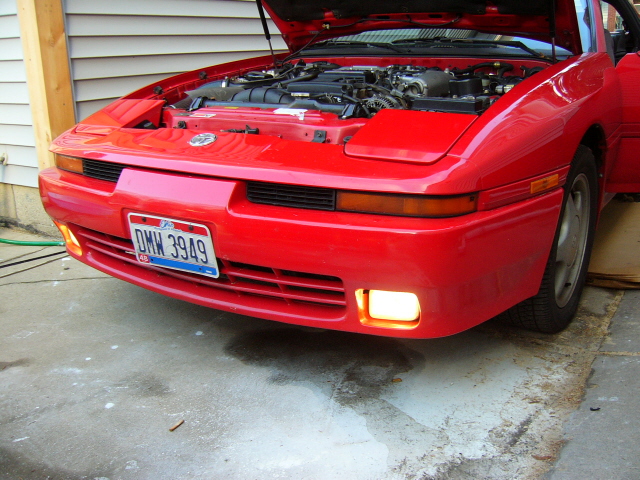

lilmartian09
Apr 1, 2010
87
El Paso, Texas, United States
Got them on. After doing the mod correctly this time it still did not turn on. Everything from inside the car was good. I was getting power to go to the fogs. BUT there was no power from the connector of the fogs. So what me n my brother n law did was hook it up to a switch I already had. Here is the end result. Thanks for everyones help in doing this.
