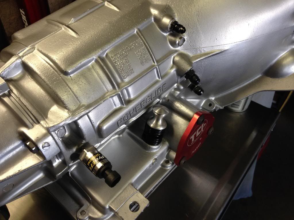

ProEFI setup mostly complete.

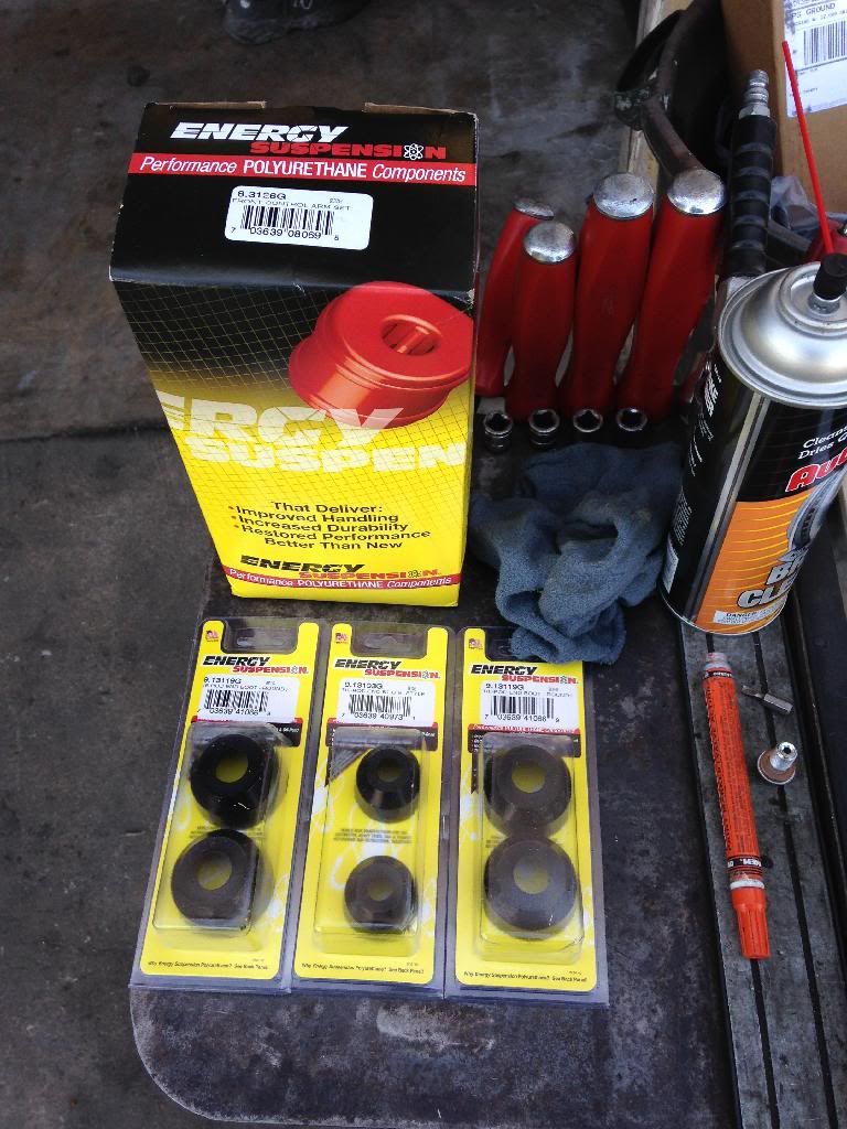

New bushings and boots to replace melted ones in the fire.
Drilled and tapped the tranny for line pressure and catch can for the vent

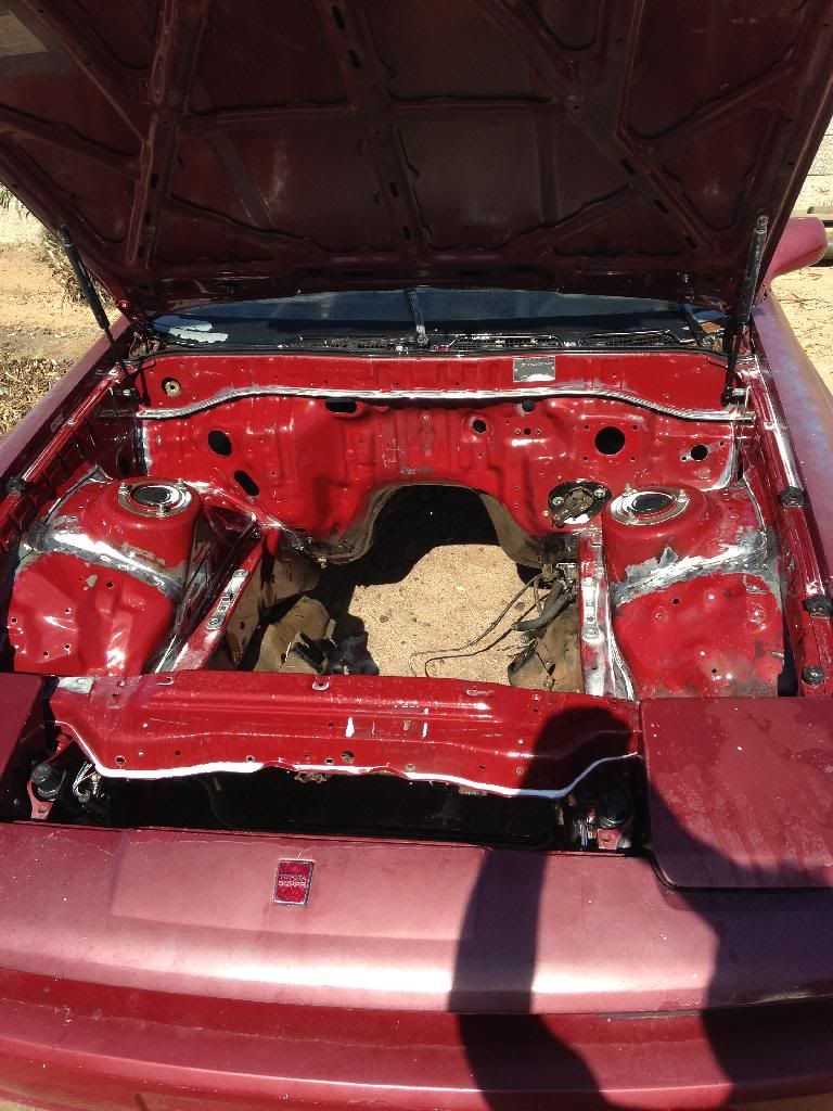

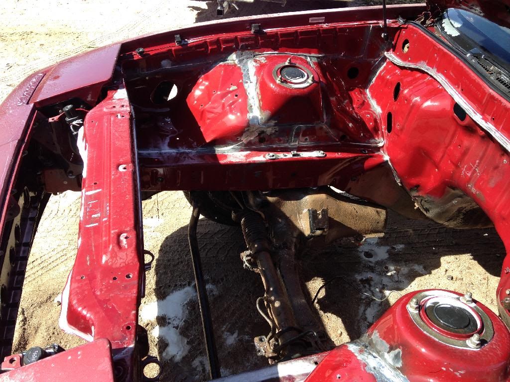

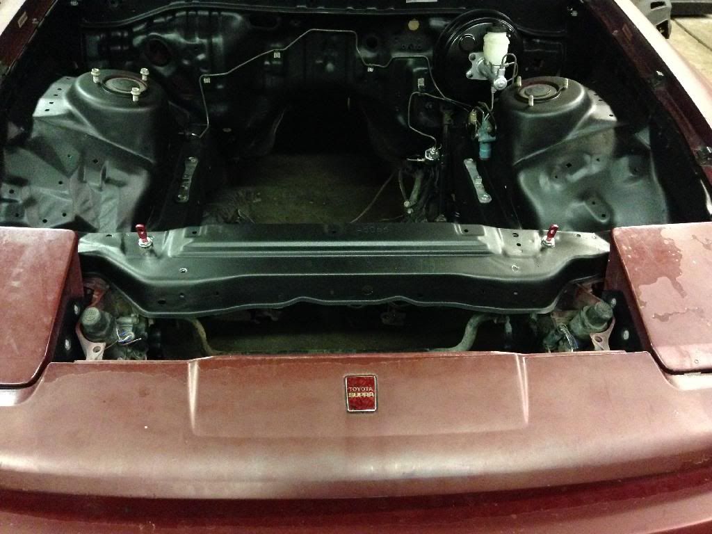

Finished removing seam sealer and wet sanded for primer

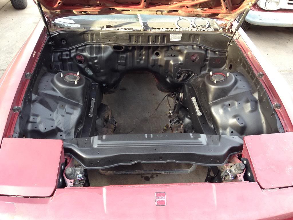

Why remove seam seals? Did u seam weld the front of the car? Also, I made this mistake when sending my car for paint; it's a good idea to jack up the car so the pillow ball mounts lower so u can paint that hard to reach hole....when u get coilovers it will be more visible and kind of an eye sore if there's a spot missed there. Thats one reason im repainting my bay as well

Cause it looks way better with nice Seams instead of globs of shit everywhere. I stitch welded the shock towers, and will do the rest/bolt holes when it's ready for paint.
And yes, I would have the car lifted up or something for the shock mount area. The spray right there was mainly from me masking it.

Pretty sure the hole car will be stripped to nothing but the shell and put on rotisserie to paint it lol.

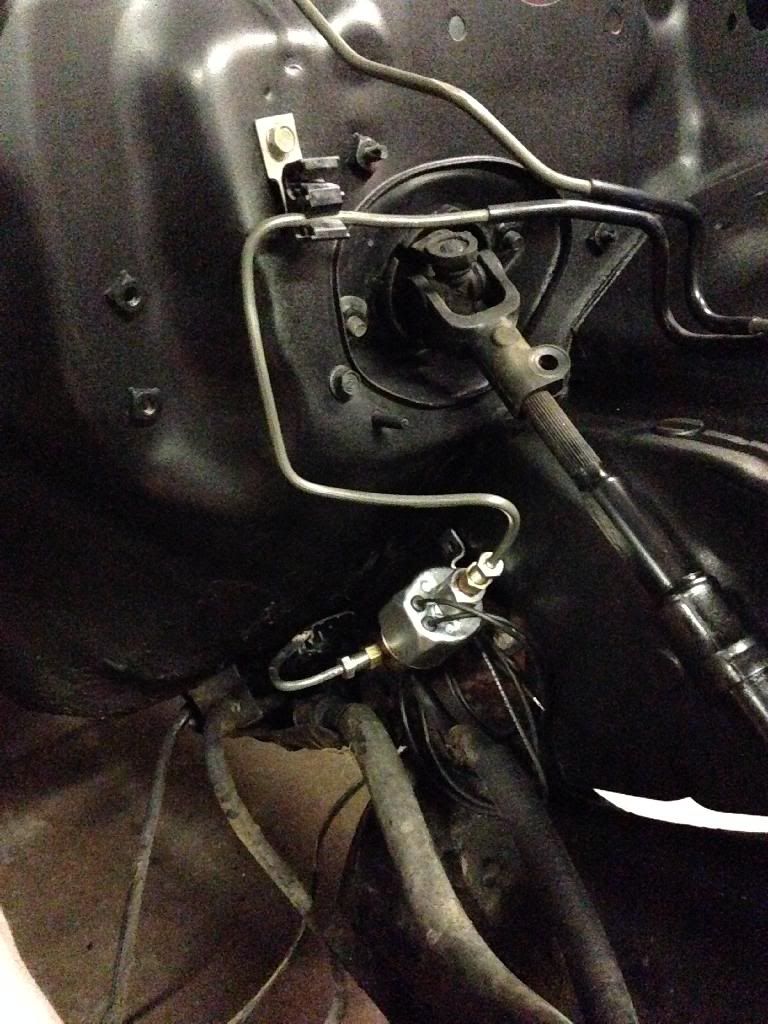

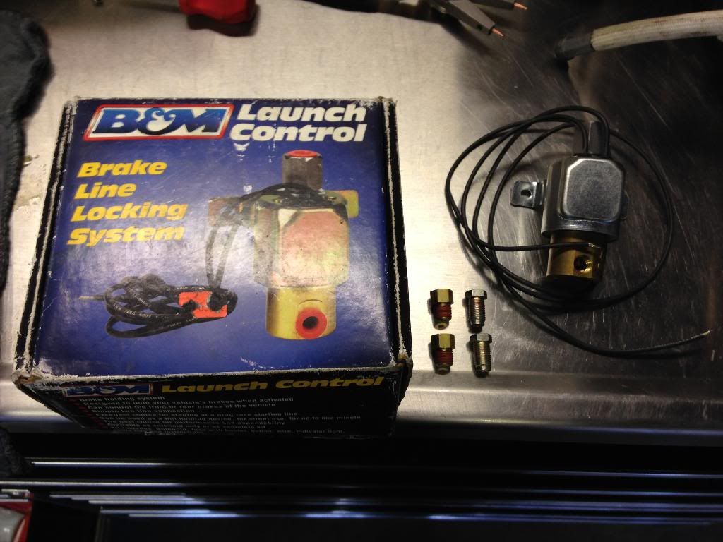

Finally installed some parts I've had for a couple years
Aero catch hood pins

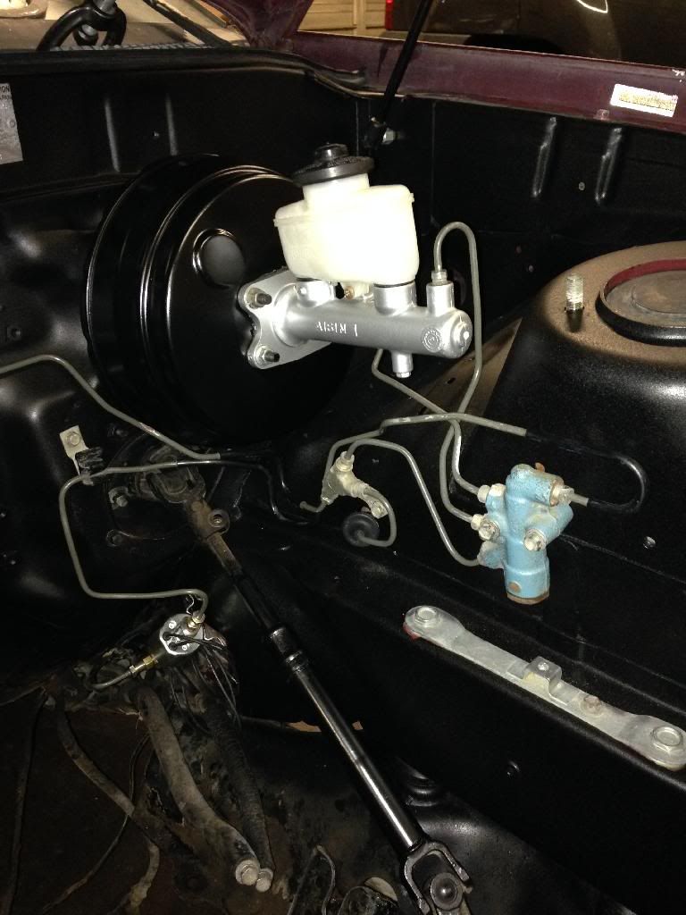

B&M line lock, new tube ends for the 3/8-24 I.F. Fittings
Removed the rear coupler, rebent and reflared the lines. Bolted into the factory bolt.
Rebuilt the master, and mounted all the lines back on.
