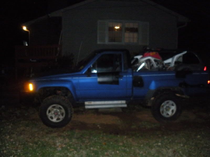

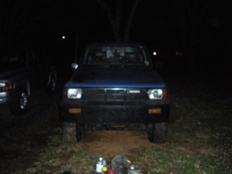

heres the truck, and yes that front bumper is going to go. sorry for the crappy night time pics, i just took them tonight before we left his house

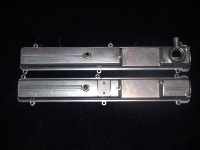

ceramic coated valve covers

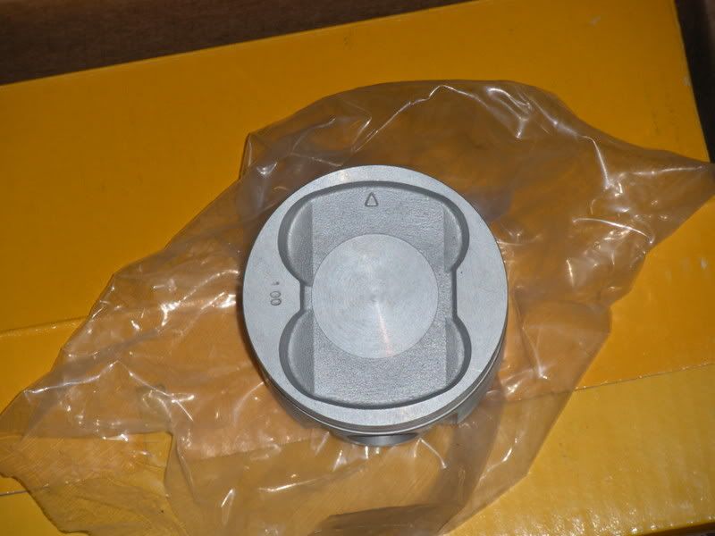

new .040" n/a pistons, doing that for a little more on the low end

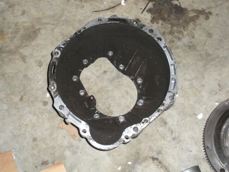

w58 bellhousing

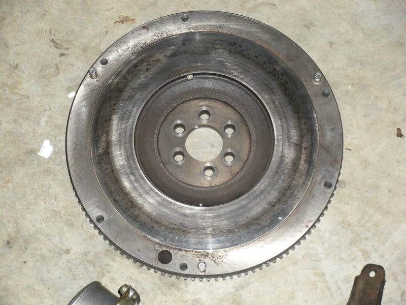

7mge flywheel

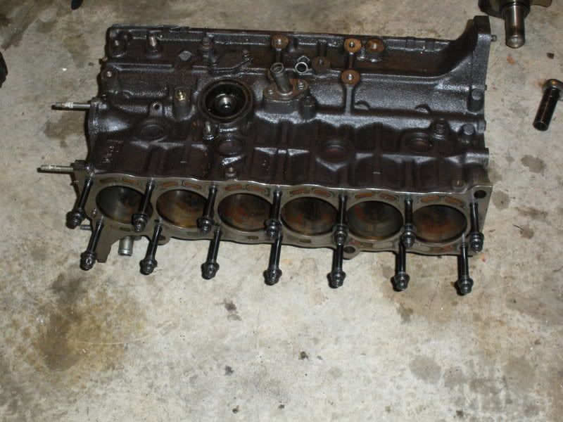

block out of 1990 turbo supra that is going to get machined for those pistons in the morning.

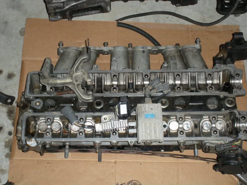

head that we are using, came off of block we're using

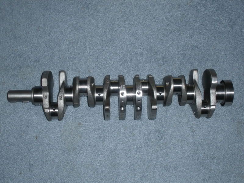

crank that has been turned .010"/.010" and balanced

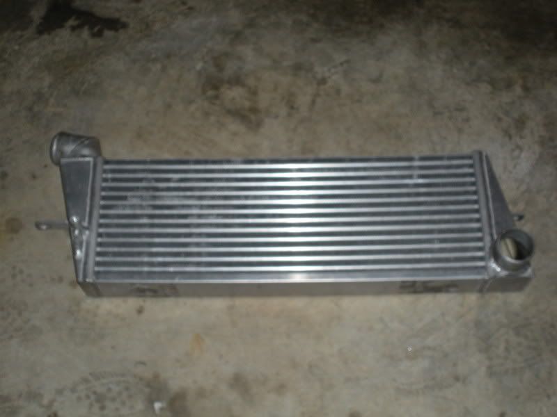

front mount ets intercooler, the previouse owner of my car cut off and turned the 90 thats supposed to come back across the top

we dropped the block off today to get bored and honed, also the flywheel to get surfaced and the cams to get polished up. they should be back next week so we can start putting it all together. still have to order a few parts but not many, still waiting on some stuff to arrive.

well we finally got the block back from the machine shop. it took a lot longer than it was supposed too. when imstalled the crank today and checked all of our oil clearances. we had a slight problem with the acl thrust washers we had purchased. they were .002 larger than a set of standard ndc thrust washers i had. we got rid of the acl bearings, the crank didnt want to turn with those installed. i also lapped all of the valve the vavle seats today and made sure they were seating properly.
oh yeah we also drilled the block to move the dipstick forward for the frontsump pan we're going to be using
