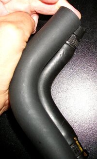

Which end did you end up cutting? I see there is a 30° and a 90° bend. I'm going to stop by O'Reillys to see how it compares to the original hose.

I went to O'Reillys and looked at the hose. Turns out it's flexible enough to work. About 1 3/4" needs to be cut off of the end that has the small bend in it.
It's made in China, so time will tell how long it lasts. It appears there is an inner and outer rubber tube of different type of rubber. Hopefully transmission fluid is compatible with the rubber that was designed for Honda's power steering fluid. Again, time will tell and I will keep my alternative hose design parts in case they are needed in the future. Here are some photos comparing the unstretched and stretched hose against the original Toyota hose.
