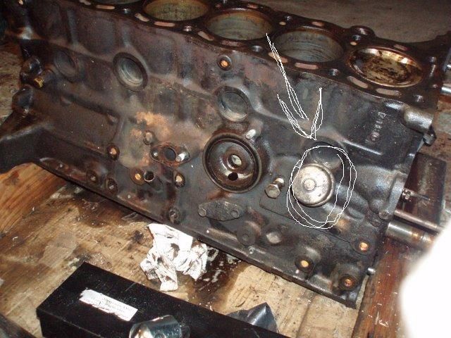

Dirgle;1945054 said:
Can you post a pic of this location?
Removed the stock sender and got a 1/8th npt to 1/8th bpt adapter for the autometer sender.
