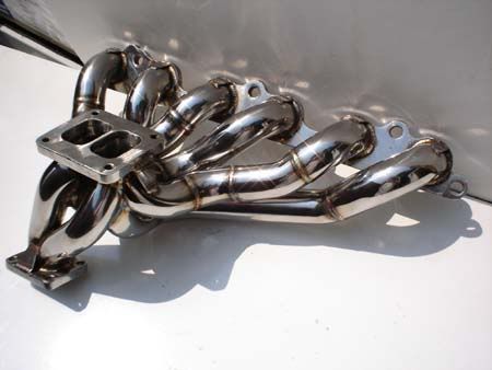

Found out today that the 6M Crankshaft I scored is ok to use in my build. Machine shop is polishing it and I pick it up tomorrow. Since I don't have a Donald Trump wallet or off shore account but do have 2 kids in college and this is my sons supra that was my daily driver for years, I want to take my time with this build. Not trying to build an engine that will smoke the tires down to the valve stems, but have a little more that stock turbo power. I have had this header
for 3 years, anticipating that some day, my engine will fail and when i resurrect it, I will use this header. Well that day is here. I have the wastegate designed for this header also, it's just not in this photo.

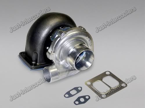

I have been looking at this turbo and know nothing about it.
T4 T04B Turbocharger
.60 A/R Compressor, 1.15A/R Turbine
3" Inlet & 2" Outlet
Its awfully cheap $$$$ and as the story goes you get what you pay for. Is this more turbo than the stock CT26? Anyone know anything about this turbo?
If I get this turbo and use it with the header i have, will I have to have bigger injectors, ECU remapped, and FP upgrade? For this build I am using stock rods with new pistons...(not forged), NPR pistons and rings. Block is +.20 over. Thanks for your help.

you should just rebuild your stock ct and go 57trim they pull pretty hard...thats what im going with...driftmootion sells them with a core change with your stock ct for $510 good price will last a long time too...plus looks stock so if your son has any trouble with ccops they wouldnt know cause it looks like the stock ct

as for the turbo.. its probably easier to go with an upgraded bolt on ct. you dont have to mess with getting a new manifold, wastegate, running oil lines and bypassing coolant lines, etc..

About the turbo ..... move on from the ct26 you already have a t4 manifold get a Master Power unit. If had known more when I first started I would not have gone through 2 upgraded ct26. They are prone to fail not because they aren’t built and balanced right but the actual shaft is to small for the upgraded wheel and compressor surge kills ..... 1 more time ..... kills upgraded ct26's. Get a X-s power turbo if your pockets are light they have been proven over the years to be pretty damn good for $350. Maybe 10 have failed over the last few years and they sell so many to the NA 2jz guys in Lexus Sc 300's and NA Supras. Mark gives offers a great warranty on his stuff.
