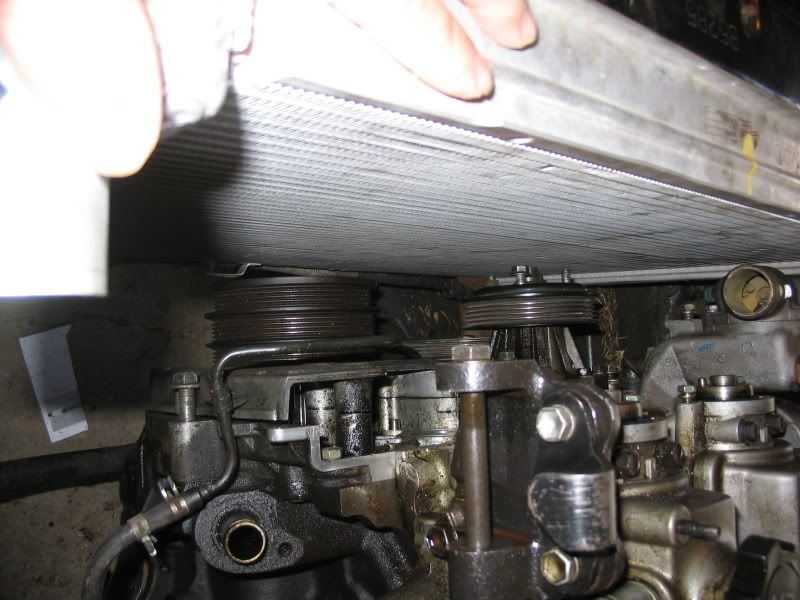

I've got my engine and radiator mounted into their final positions and as you can see I don't have much space up front, just over an inch up front at the crank.

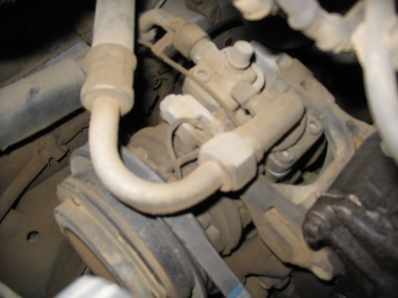

Here is the compressor from the 88 I got most of my 7M swap parts from. As you can see the clutch sticks out too much and will hit the rad.

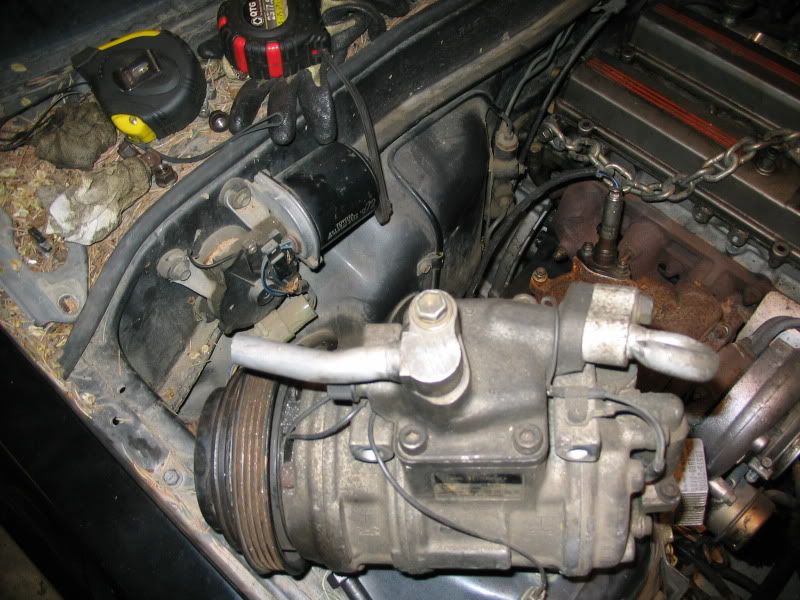

Here is the compressor on my 84 Celica.

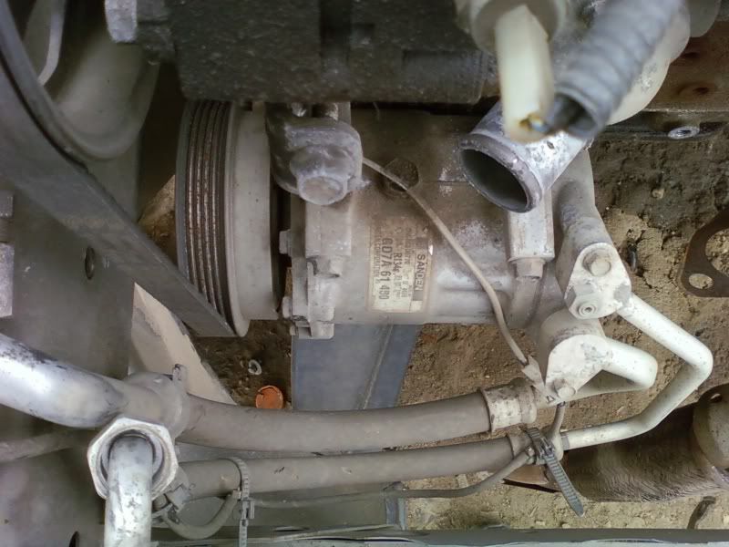

And I was near picknpull today, so I stopped in. I had a quick walk around and found this on a 2000 mazda 626

Or... is there any reason I couldn't use another pump like the Mazda one in the stock location, since it will clear the rad when used on the factory ac crank pulley? I think this is my preferred option if its feasible.
