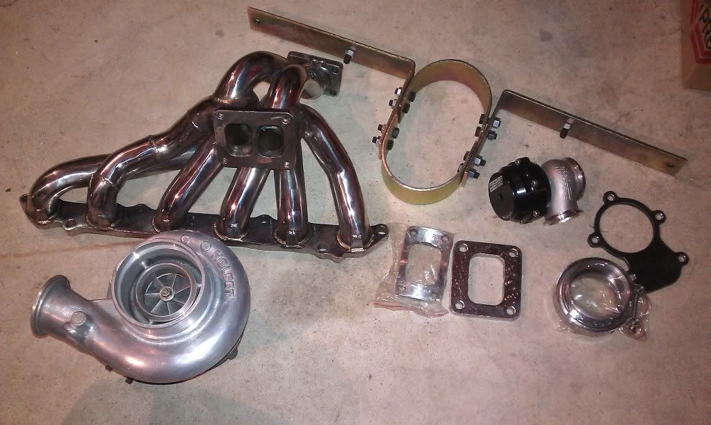

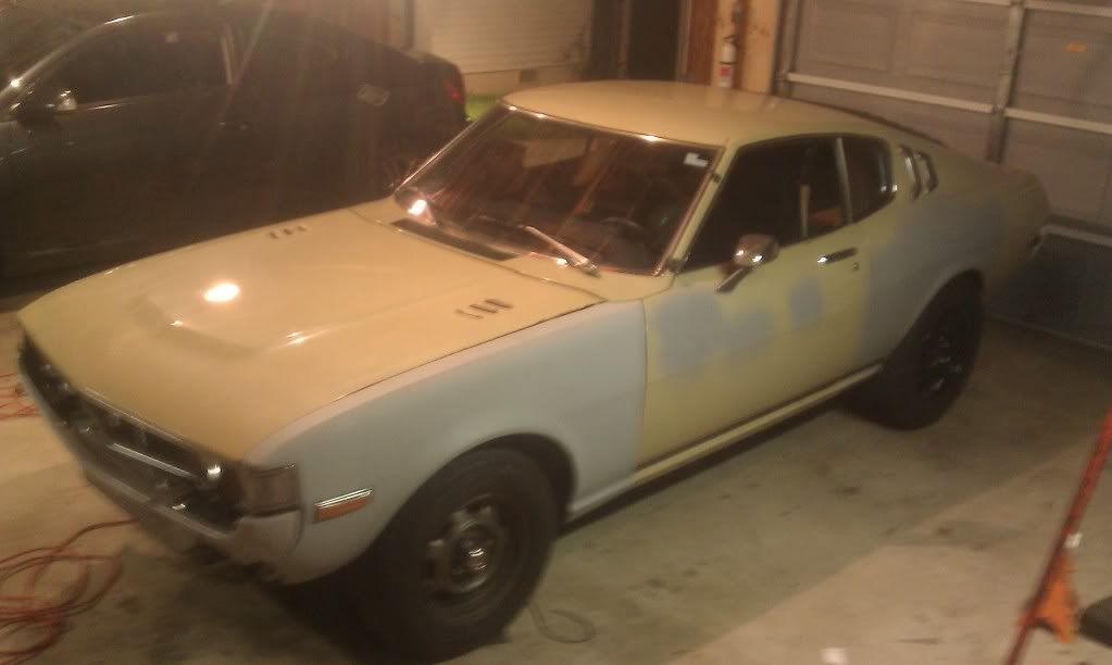

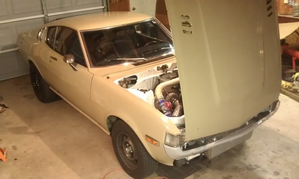

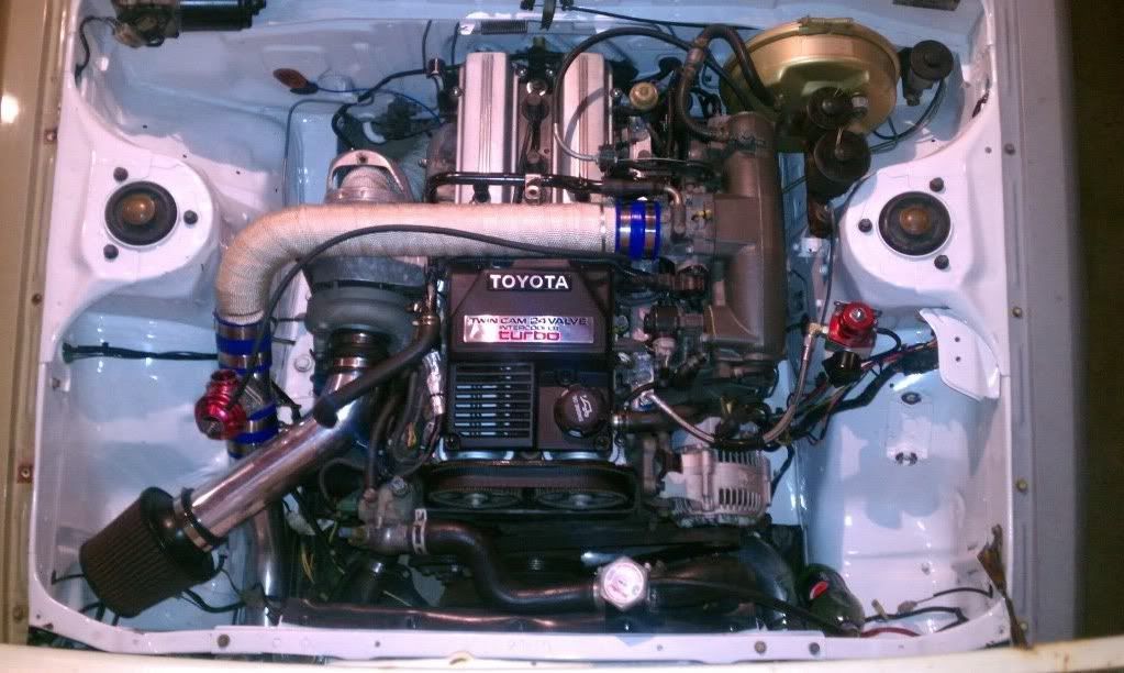

Thanks guys! here are some pics!

Not really a whole lot.
9:1 wiseco pistons
Mhg + arp studs
560cc Denso injectors
57 trim ct26@ 15 psi in the video, normally run about 17 psi on the street.
And running a self built and tuned megasquirt2
Up next....
