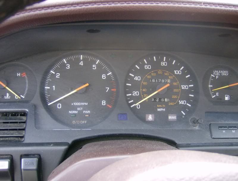

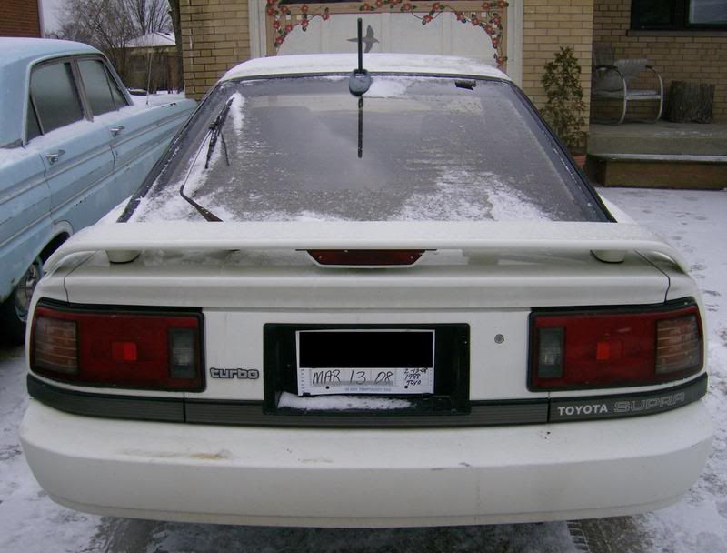

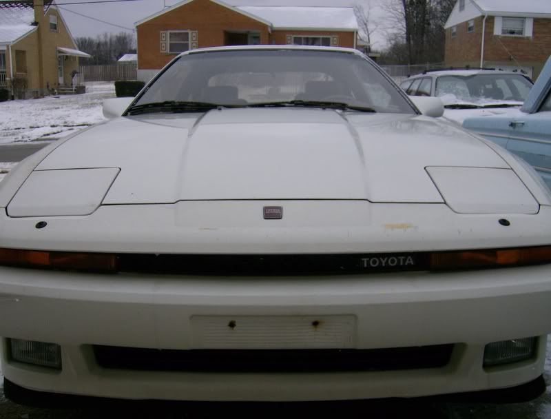

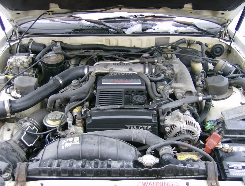

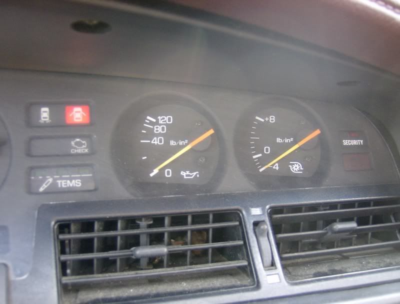

I wouldn't call this a complete rebuild, but I've just bought myself a '88 Supra Turbo Targa for $1500, very cheap but its been sitting for a year so it needs some work so it can be my everyday car, but I am going to add/replace some things to better things, I don't know completely what all those "things" are going to be but here are some pictures of how the car came to get started.

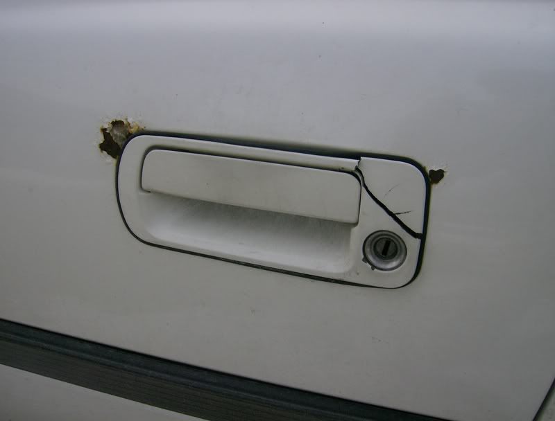

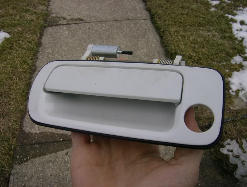

I have my first replacement body part! My driver side door handle that I will replace whenever I get a few minutes time. My old handle worked, its just cracked and nasty.

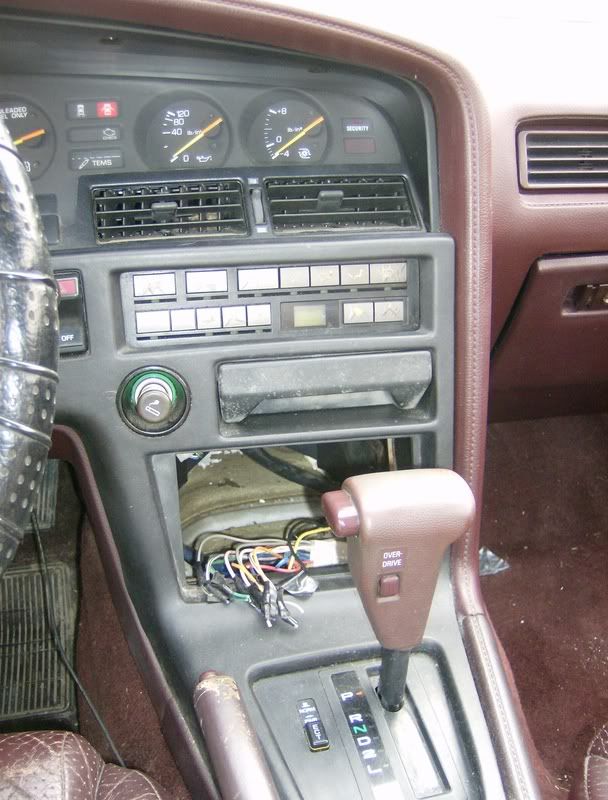

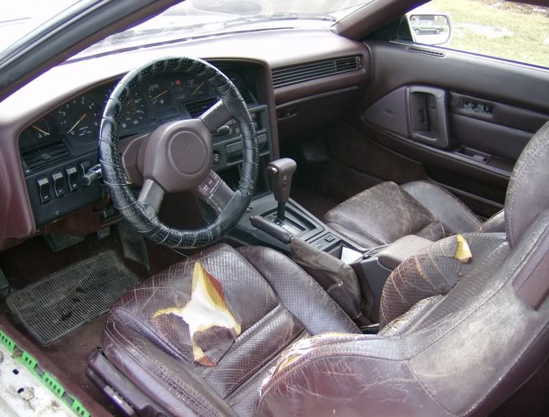

Well does it run? If so how well? We need some interior pictures. It appears you have a nice straight foundation to work with. Good luck!

It runs, and not to bad either, I had the upper radiator hose bust on me, but it did it as I was pulling into Auto Zone, it has great timing. I will put up some interior pictures in a day or two.
