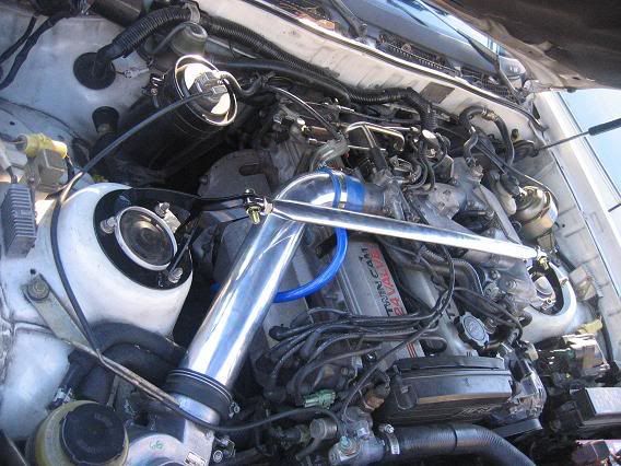

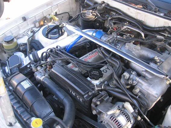

I just installed the pipe on today.. prob have pictures up tonight cause my dad took the camera.. but something doesnt seem right... it all fits perfectly but the part from the pipe to the MAF/AFM sensor... its the original piece i jus cutted it.. but it seems to be loose and i think some air is comin out of it.. is that ok? or sould i buy some sort of adaptor from the pipe to the AFM/MAF to make it tighter...
I don't think I follow.... if you have a leak after the the AFM the car will run, but it's not pretty, too much unexpected airflow at what's usually unpredictable intervals.

i bought a '92 - '95 Civic intake lyk y'all said... but i didnt hav to cut it or anything.. it was a perfect fit.. and i also put on a strut bar for looks haha...well here are some pics
