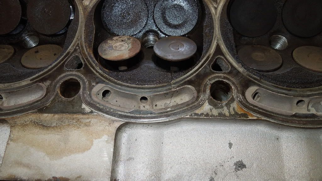

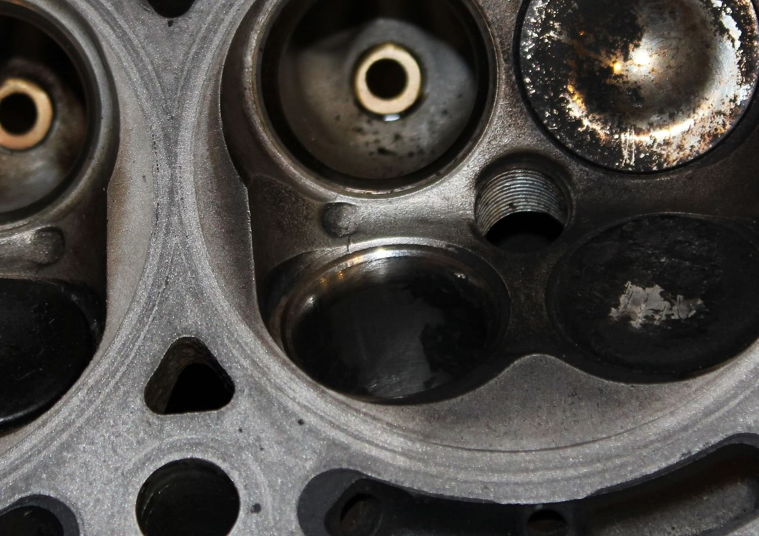

Caution regarding heads. Have them checked carefully for cracking. I went through three separate heads before I found one that was at least marginally suitable. Common locations for cracking are around the exhaust valve seats and into the water jacket.

I wonder if the heads are softer than JZ, as well as other castings. I think Quake on Supraforums mentioned the 7M heads need clamping help on the exhaust side.
That is very coincidental and correlates with his suggestions to fix it.
