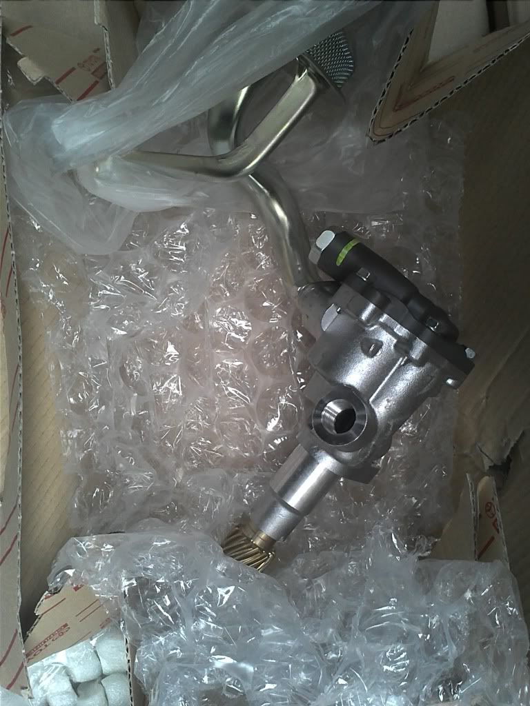

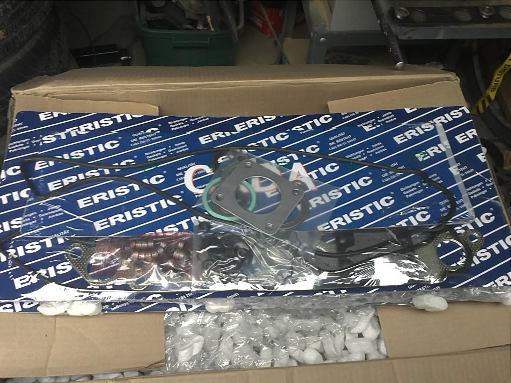

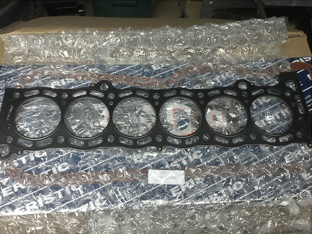

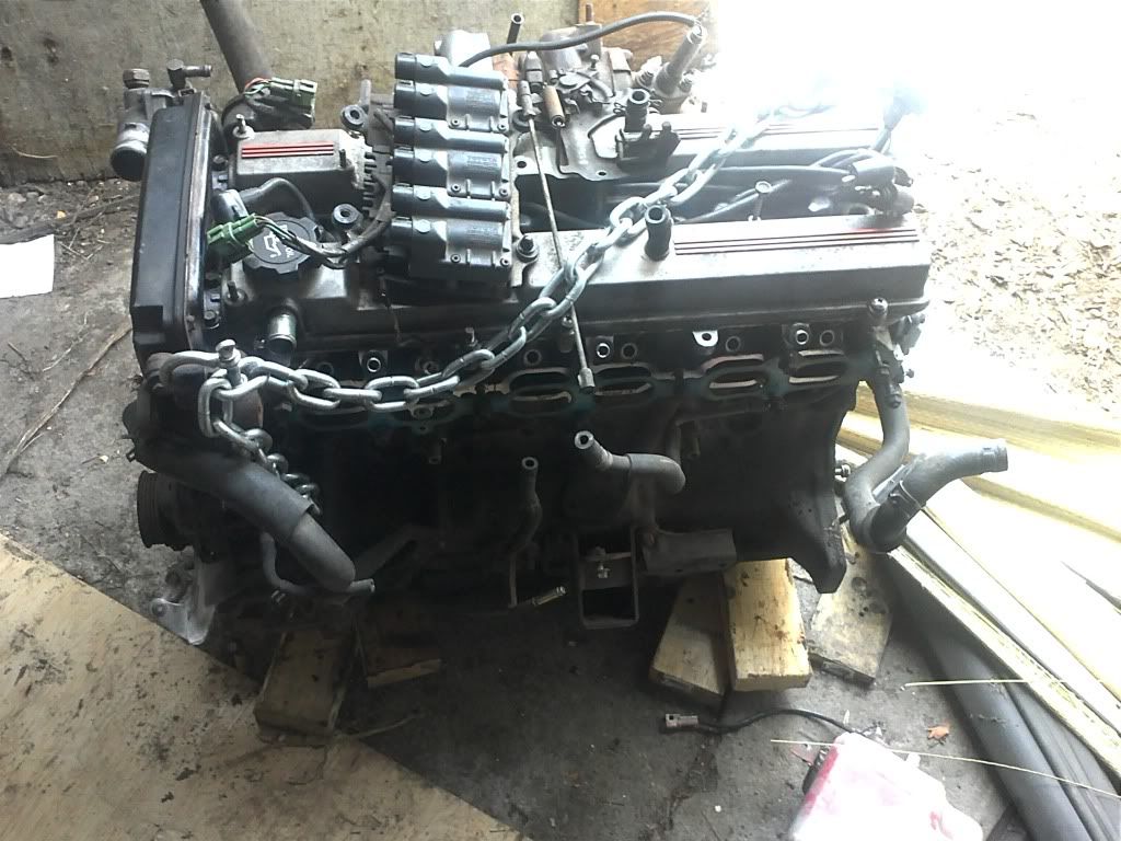

Parts in.
ARP head studs:
Titan 1.4mm MHG

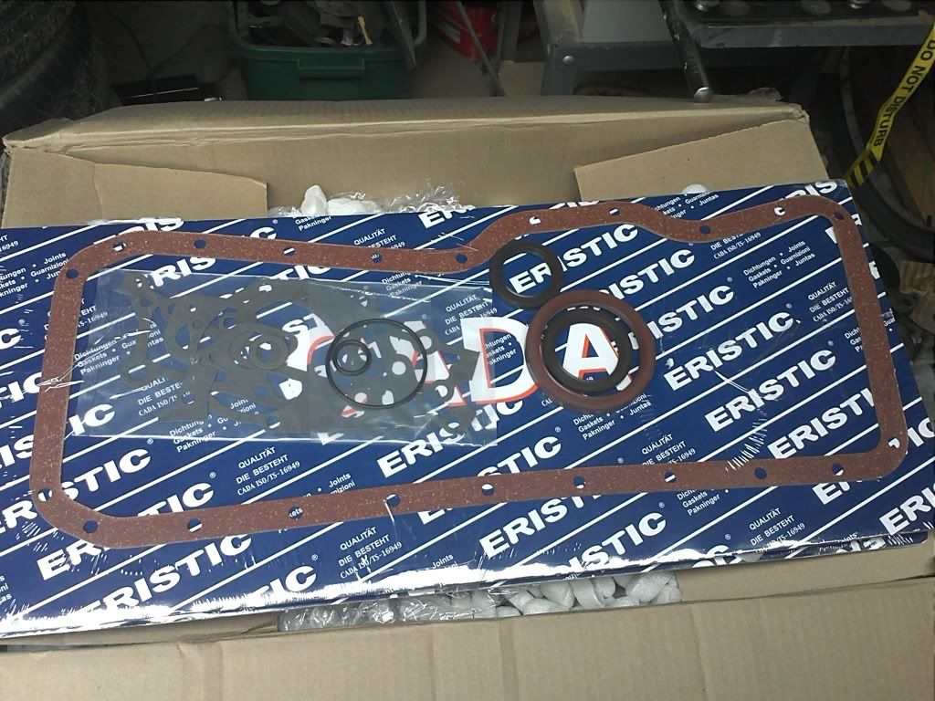

7M rebuild Gasket set
OEM Oil pump. Decided against the upgraded unit, but it was a close decision.

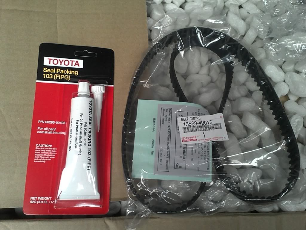

FIPG and new OEM timing belt. (Why not when you're in there, right?)

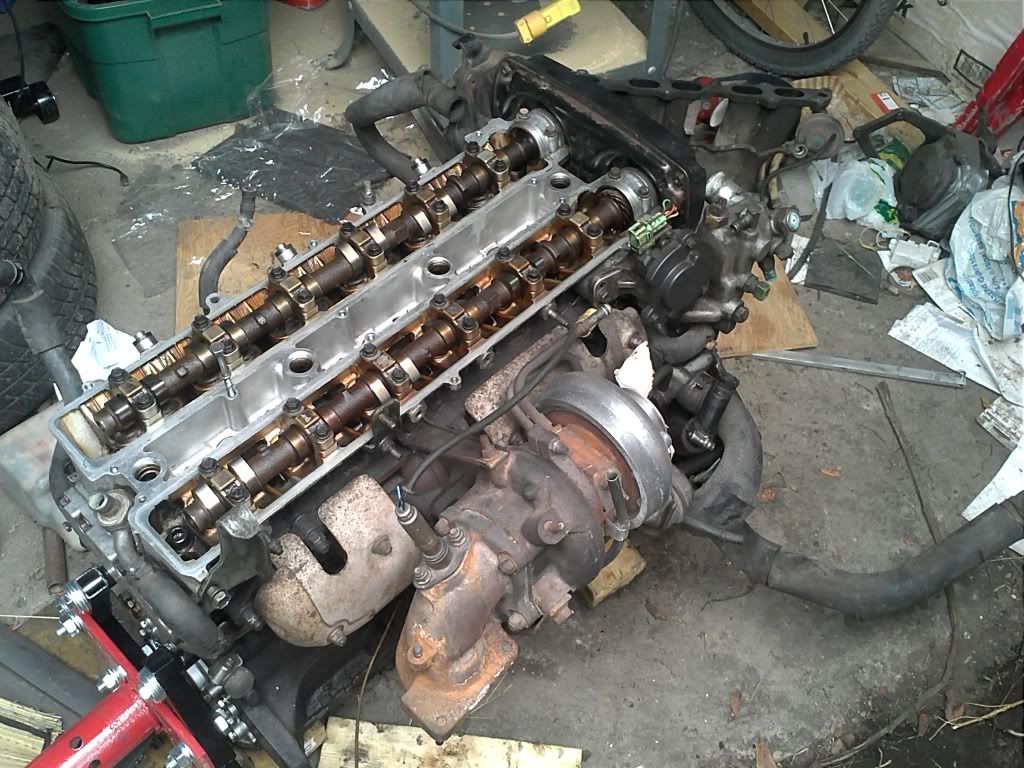

And of course the 7M-GTE that it's going to be installed in.
Still to come, new bearings and rings. The bearings when I get my polished crank and measure it, and I'll just order the rings at the same time. I've also going to get the DM upgraded oil pump line from a local member here, just because. Also the intake manifold that came with this motor was damaged, so I'll get another one of those, too. I'll also be getting ahold of some shims for the head, so that I can make adjustments after the valves are out. I guess I need new retainer clips and the like for those as well, but I don't expect those to be difficult to get, or expensive. I'm more concerned about a valve spring compressor tool, which I plan to rent.
I think that covers everything.

Few things: unless you're referring to some pump I've never heard of, upgraded oil pump is simply a few washers. You can make your pump an "upgraded" one for under $2.00.
You simply shim the relief spring so the internal pump relief is higher.
Valve retainers. I don't get why you'd need new ones. I'm lost. They are completely reusable unless I'm missing something.
Spring compressor tool: not many of the rental units work on our motors. The valve design doesn't leave much any room to grab onto the springs and I never found a rental that would even come close. I made a compressor tool out of pvc and steel bar. Cost nearly nothing and works ok. Still definitely a pain to do valve work.

Not the keeper, just the non-reusable snap rings.
I figured that it was something like that for the oil pump. I'll leave mine as-is.

Don't want to use a cork gasket.

@Harley: I'll do as the TSRM says, which is to use FIPG or silicone to seal the oil pan. Used silicone on the one that's in the car, and it didn't leak. (Only been a couple years, so I wouldn't expect it to.)

You just remove the offending rivet, some say it's been moved in later MHG's but I'd check anyway.
Easiest/safest way I found to remove it is a small pair of wire cutters just squash the small end then pull it though from the big side.
I've had very good success using 3bond 1207b for the pan
(tried a LOT of different things over the years the 3bond stuff is a little exe but works well)

The gasket kit from Driftmotion came with a tube of FIPG, so I'll use that for the pan. It also included a cork gasket, but since I despise cork gaskets, I won't use it. :p
