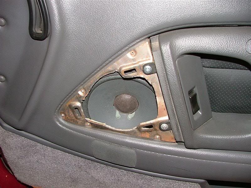

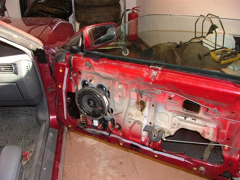

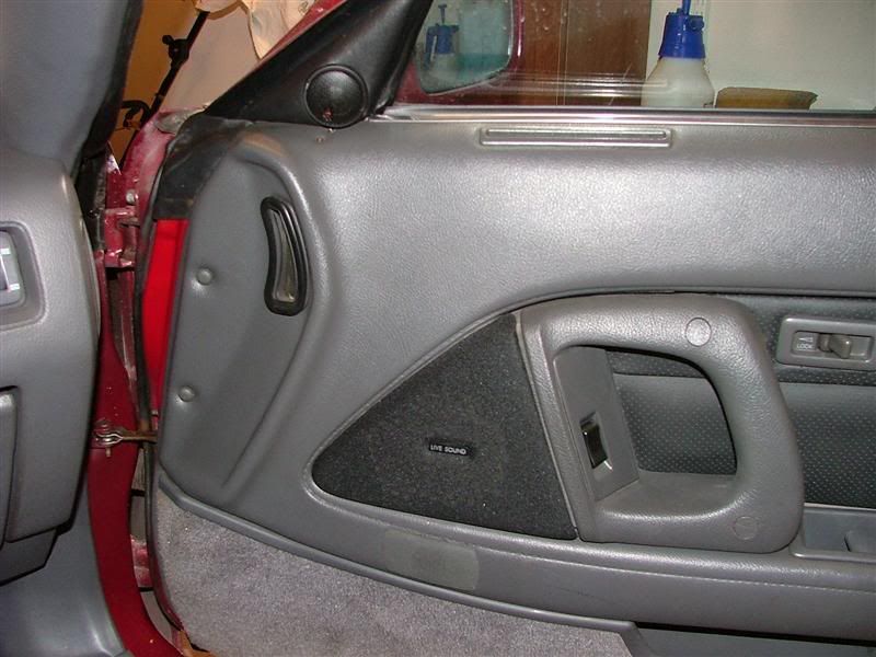

Okay, I just got my set of MB Quart 6.5" separates, and I'm going to make 'em fit these doors, for sure. I also got a set of Kicker SSMB6 6.5" subwoofers, which I may install instead, if I can get more than 0.3 ft^3 and the requisite mounting depth, and locate the components in kickpanels instead.
The plan is to make an enclosure for the speakers with as much air space as possible. It's easier to make the volume smaller than larger, after all.
The speaker face will sit facing the existing grille, and the little port grille for the factory 4" speakers. Maybe not ideal, but more than good enough. Maybe not if the door speakers were going to handle more than a couple hundred watts, but I'm personally not planning on more than 75W/channel for these.
Anyway, I figure that I can do this one of two ways. I can either make one set of enclosures, in place, so they don't come out, or I can make molds for them, in which case, I can make more than one set. I'll be working on these during April, so I would like to know if anyone else would like to have a set like this, if it's worth my while to make more than one set.
