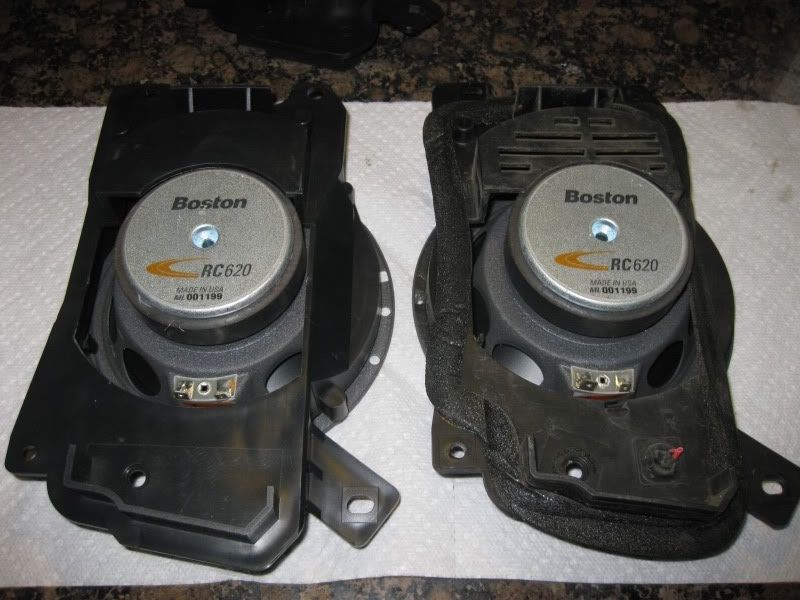

The factory pods and mine aren't much different. Open back, designed to use the door as the 'enclosure'.
Happy to say that after years of fighting to get more, I may actually have some in the next few weeks.. Time will tell
Fitment- the Boston's that you see are really good fitment.
Earlier year panels 'will' work, but you have to cut them open bigger and have to have the stamped backplate to rivet to it as well.
mine on top, stock on the bottom

They are technically the same door panels throughout all years. Once you compare, you can see that. The later years just have the stamped plate and larger grill. You can see on the 91+ panels that they just cut into the panels to create a larger opening, that's all - so grill fitment will be fine (same curves, etc). I'd really recommend seeing some 91+ ones first hand so you can get an idea of the modification. I'll try and get you a pic of the ones from my car though- that may be enough to see what I'm talking about.
