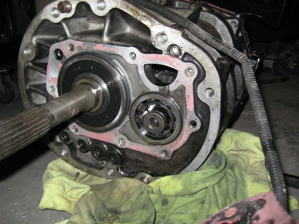

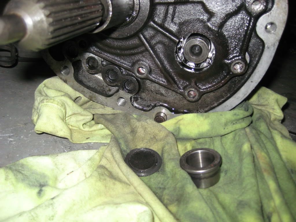

I had this same exact problem after having my transmission rebuilt.... then about a month later, the center race of the front countershaft bearing EXITED the transmission through the front of the case.
Turns out the rebuilder left the snap ring for the front bearing on the countershaft out. The bearing seems to be pressed on, but that snapring is required!
The countershaft was allowed to move forward when you let off the gas and it would pop out of 5th...
You may not have the same problem, but I had the exact same symptoms.... then it blew the hell up!

here is what happened eventually....

That's the coolest failure I've seen to date- Nice perfect little cutout.
