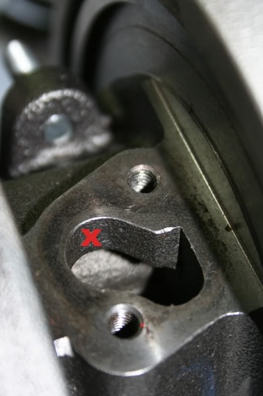

why or how the hell could the holes or port be so off if it's just a media blasted ct26? you think they used an aftermarket (non oem) housing and it's not built to spec?

Zambini - My apologies...this guy is getting my attention from a mod perspective. Will the oil drain line fit right on the hole in question?

Yes it certainly is dissapointing to send of something that fits well only to get it back out of alignment & made even worse by having to pay someone for the frustration.
My upgraded CT lasted less than a week so I know how you feel.:3d_frown:
Personally I would just extend the holes in the hard lines until it matches & sits square.
Its only a few mm & there is enough material there to do it.

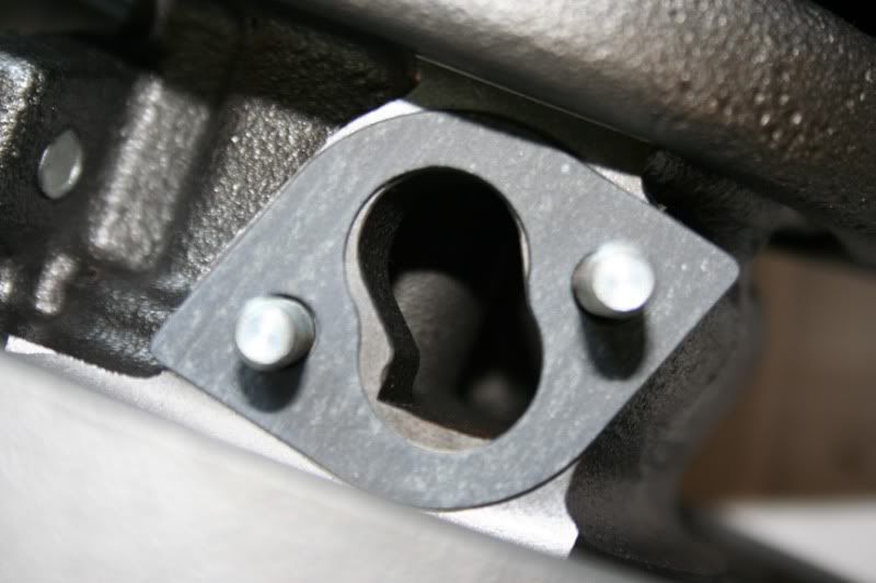

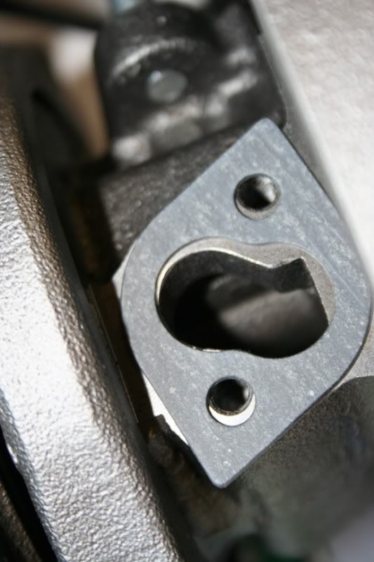

3p:
nope, the studs wont line up if the flange is rotated 180 degrees.
look at this:
this is the blockoff plate side with the studs still inserted. this is a toyota gasket that is specifically designed to follow the contour of the entire gasket surface. notice how it sits perfectly against the edges.
this is the coolant line side with the gasket sitting perfectly against the edges of the gasket surface, just as it sits in the other picture. what this tells me is that the actual port has been machined accurately, as it looks to sit inside the hole in the gasket pretty much the same way it does on the other (blockoff plate) side of the turbo... what ISNT right is where the holes for the studs have been drilled. theyre most definitely off center.
look at how close the stud hole closest to the camera is to the coolant port. it's not supposed to be there..
SO, my latest revelation here is that im looking at a manufacturer's defect in the housing, which as long as driftmotion doesnt machine their own housings, CLEARS THEIR NAME FROM BLAME. driftmotion's rebuild job is probably just fine, though the manufacturing of this housing is not.
im going to be calling aaron from dm shortly to ask him where this housing is from and what i can do about this.. just wanted to get these images online so that he can take a look at them.

That last pic may have solved the problem. Could it be a CT26 from a Landcruiser
check the lower left pic closely
Vehicle: Apply to TOYOTA LANDCRUISER
Engine Details: 1HD 4.2L
Turbo Model: EM-CT26
or from a - CT26 2.0L 3SGTE Celica
(haven't found a pic)

the stud holes still look more evenly spaced there.. theyre in the center of the area they are drilled into. my holes are offset. waiting on a call back...

well i have a housing off the gfs 88 and the water passage hole is more centered.. the stud on cold side .. the one closesest to the oil drain supply lookes to be about 4- 5 mm away from the water passage. and about the same on the other stud.. i will take apic later and post .. cam battersies dead .. charging now

well i owe it to driftmotion and everyone here to mention that the shop agreed that the housing was defective. they told me theyre sending me an entire new trubocharger assembly and im sending that one back to them... good riddance haha. so cheers to driftmotion for working with me through all of this shit.
