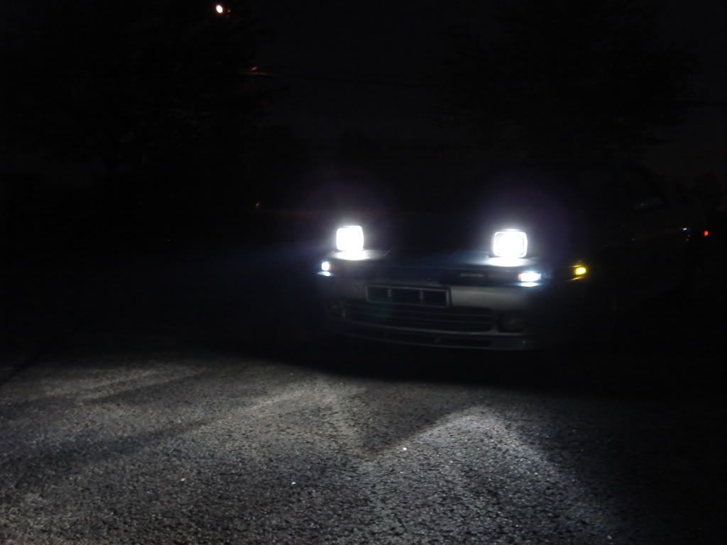

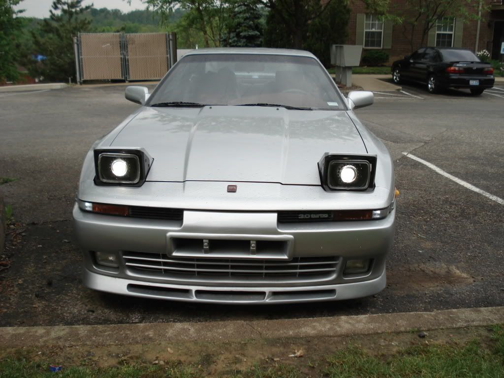

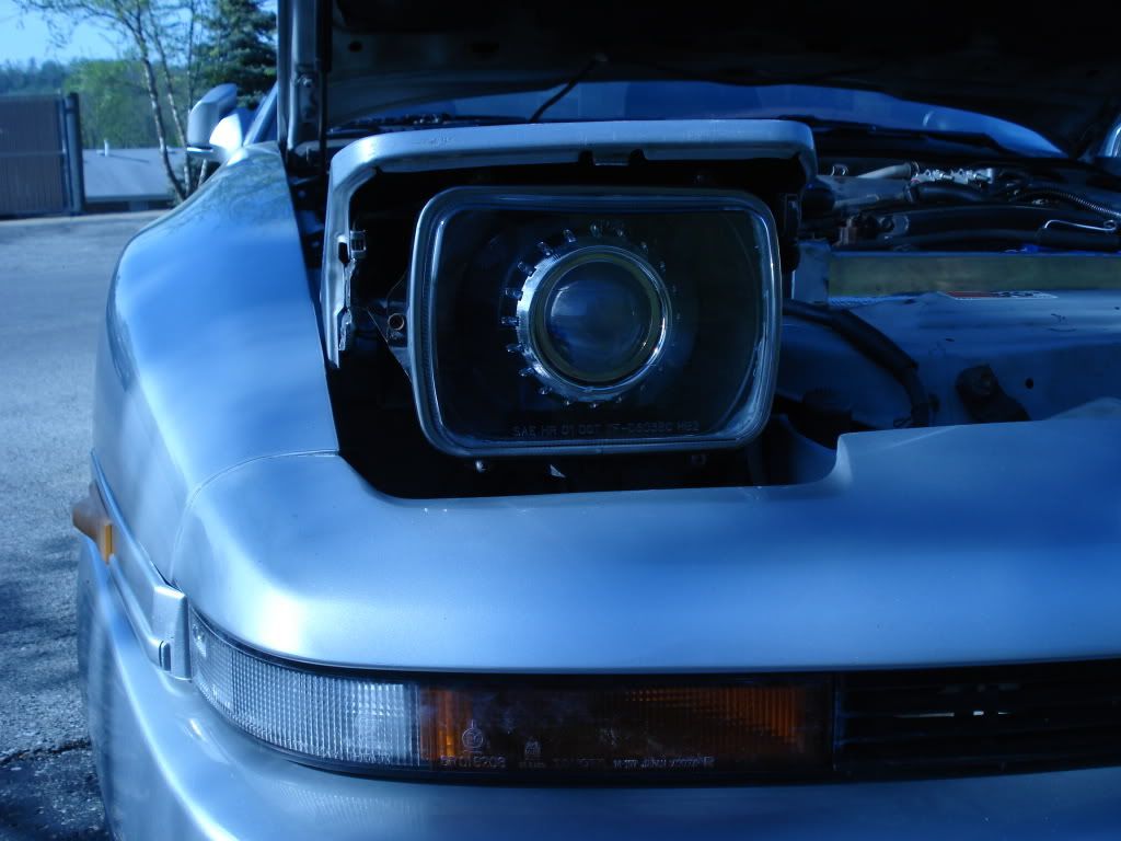

Well Got it done. I built my own Harness with 30 A Relay & Fuse using 12 AWG on all the +/- wire. Kinda over kill since 16 AWG would have worked. Since my A70 is a weekend worrier I just went with aftermarket HID KIT. I'll see how that works out & may go with an OEM ballast & Bulbs down the road. Here are some pics.
Still Need to Aim the Lights & Clean Up the wiring.
