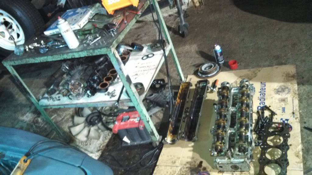

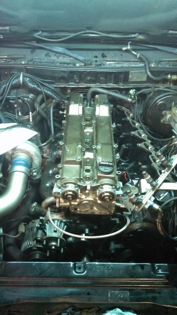

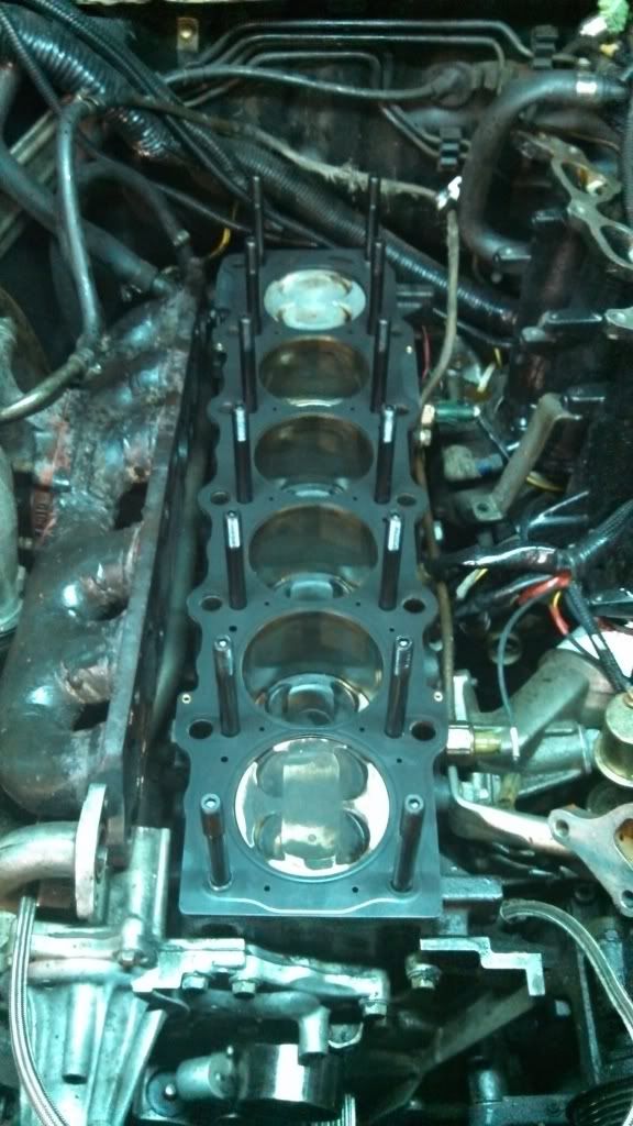

He sold it..to me :) it is now fully primed and has 57 trim ct26 with divorced downpipe bit recently overheated and ruined head gasket, this weekend it will be redone with Toyota 2jzgte head gasket and ARP headstuds

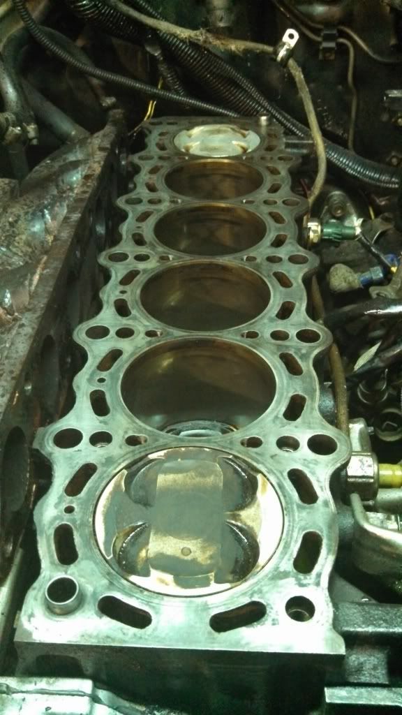

I love the feeling when you go from having the block exposed to having the head installed and torqued down. Now you just hope everything is right lol.

it is running that was a month ago it was very nerve racking because getting the head on straight over the studs alone was not easy i was standing in the engine bay
