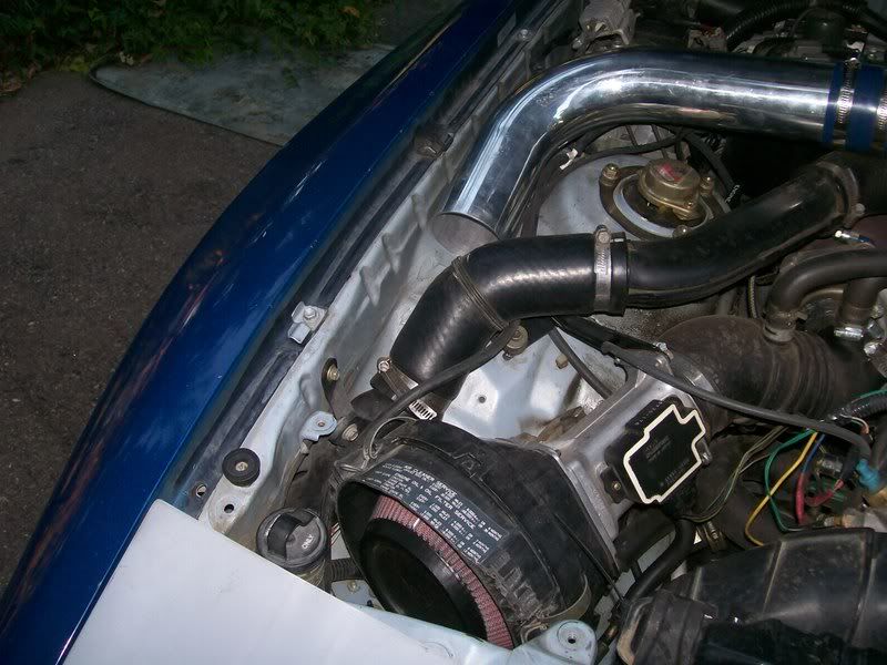

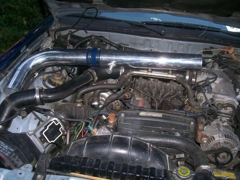

after driving it around for awhile the transmission went out so i ended up replacing it. while i was doing that I checked the condition of the turbo..... it was pretty much toast so I went ahead and adapted a t3/t4 60-1. here's some pics.

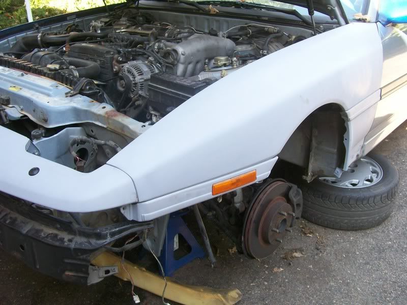

then after that I noticed my front suspension was shot, so i decided to rebuild it. New poly bushings and toikico's to replace this.

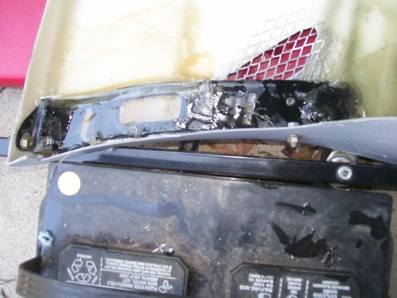

anyone have any ideas how this happened?
here's th fix.

nice turbo setup though!

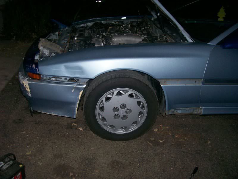

lol, it's a big pile of dent. I'm suprised you didn't notice, but then again you were standing on the nice side of the car most of the time.
and yeah, i ordered one off of e-bay for cheaper than I could get one out of the yard for. it should be here either late this week or early next week.
by the way, I'm looking for a passenger side fender also. I know you said there's no turbo supras @ pnp, but were there any at all with decent fenders last time you were there?

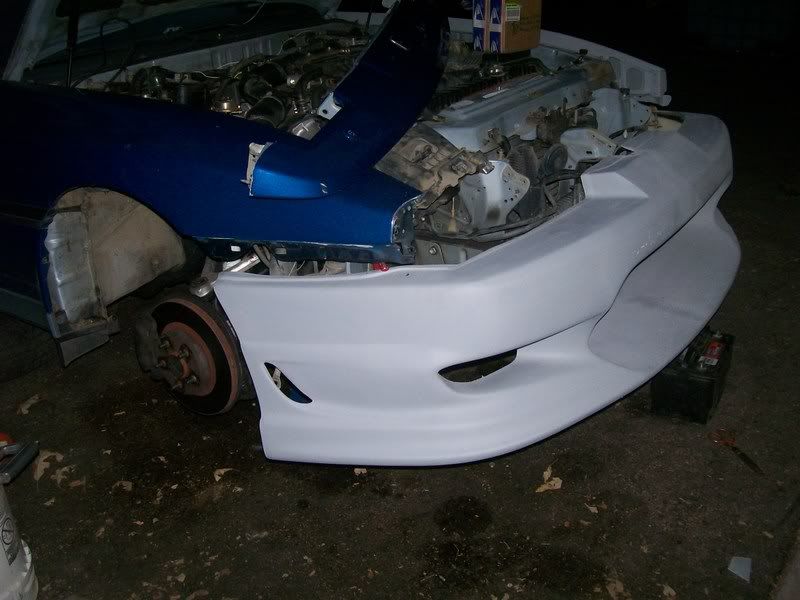

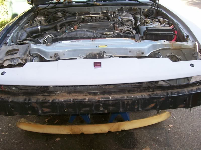

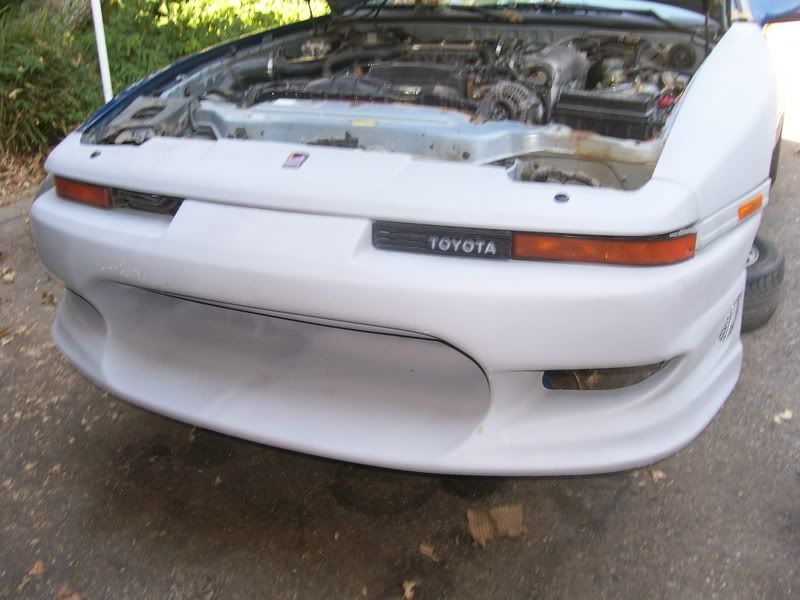

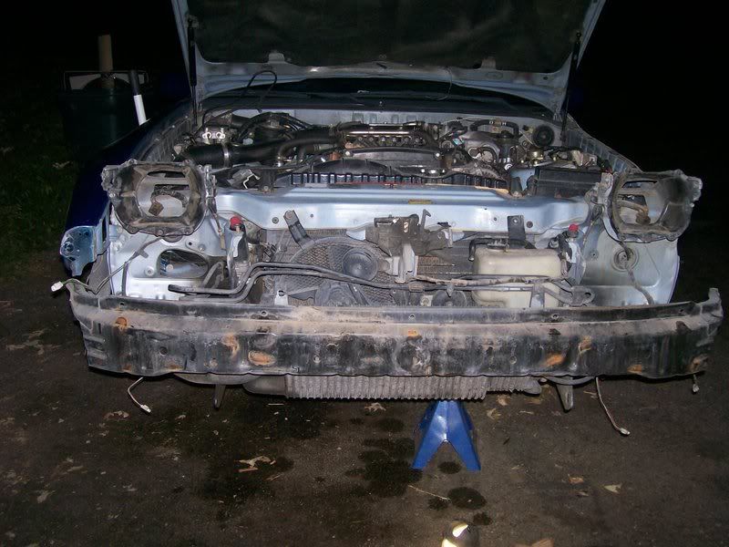

so here's a update, I got the front end worked out pretty good, still needs some finishing.

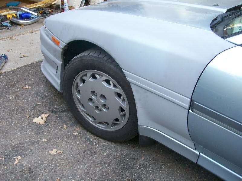

nice straight fender.

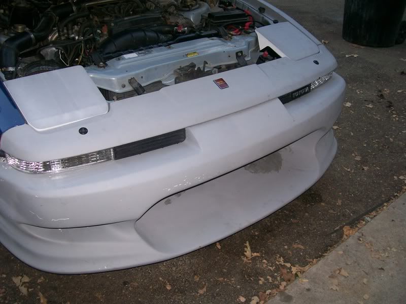

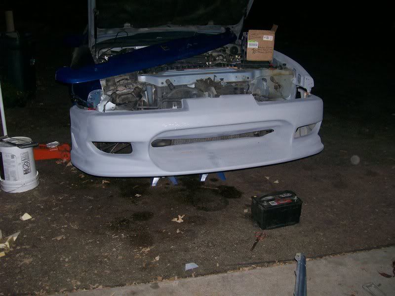

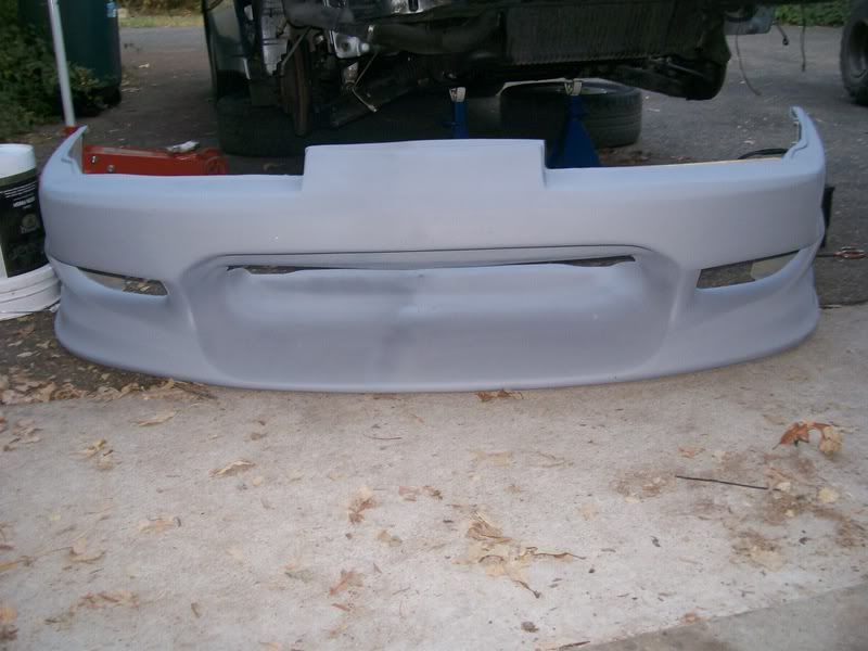

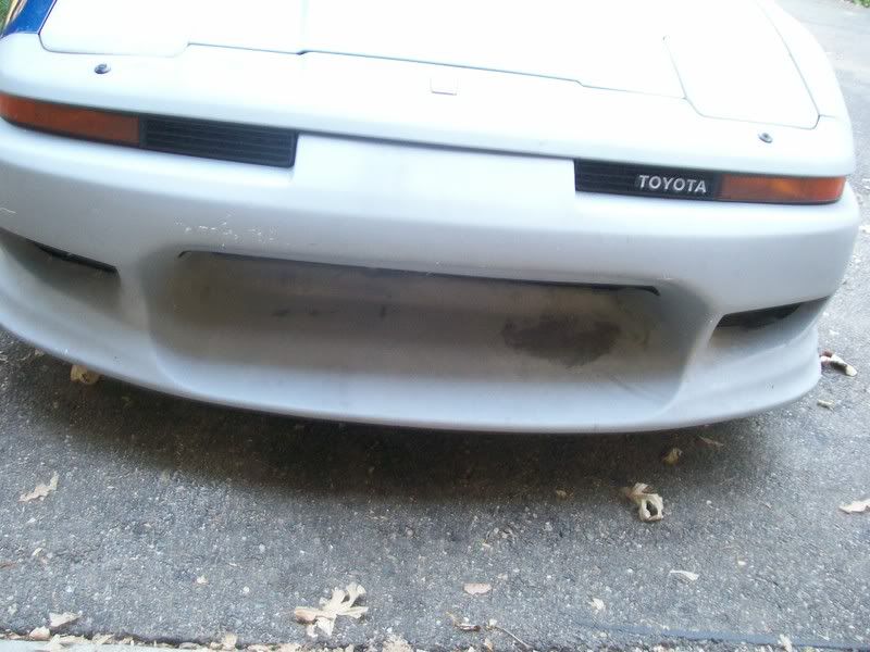

here's the front i decided to go with.

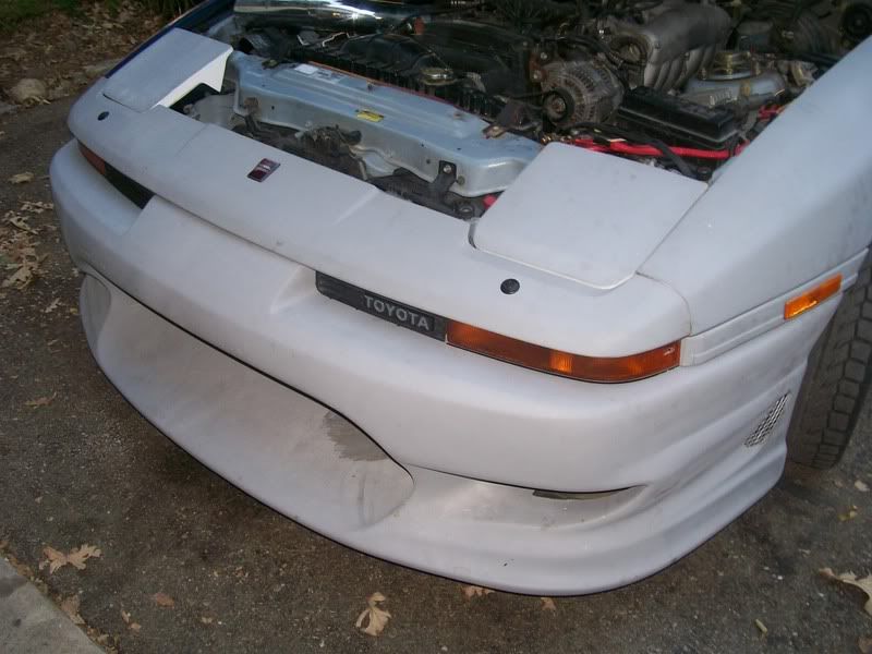

doing some test fitting

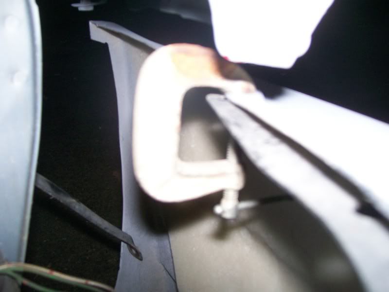

i used some wood working clamps with the pads taped over so it wouldn't be as likely to crack the bumper

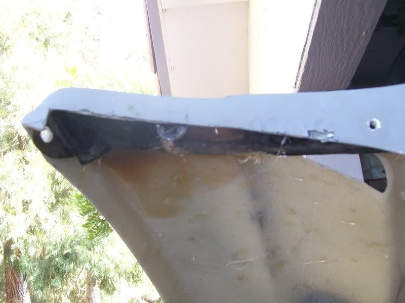

i ended up glassing in the factory bumper mounts to help mout this thing in the right place.
it worked out pretty well.

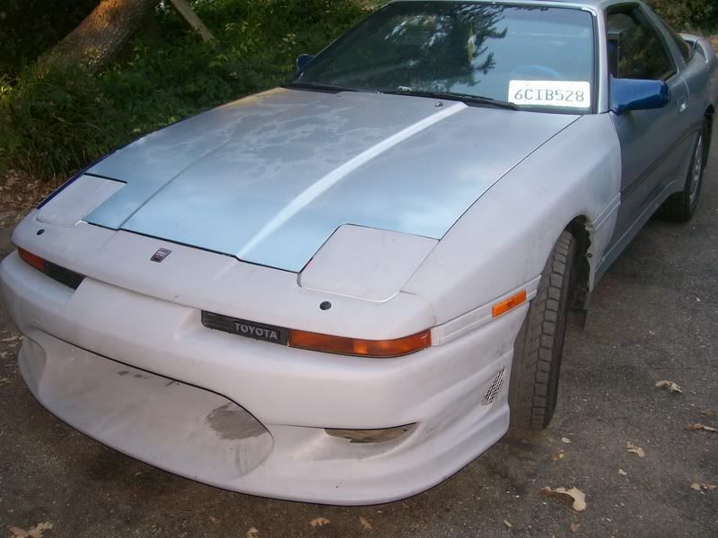

and here fina;;y back on te ground and re-assembled... kinda. it still needs some finish fitting
thanks for lookin

looks good so far, gl with your build.

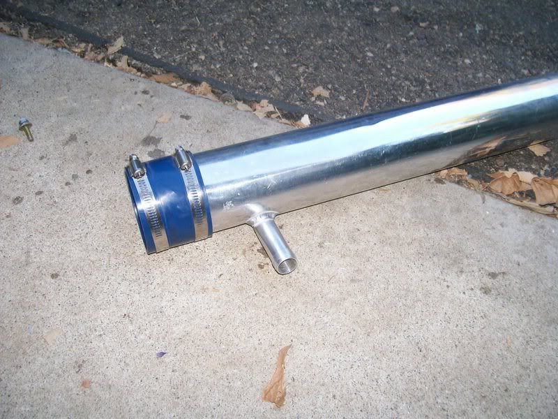

i would try and make the pipe follow like stock, just because it sets you up for a better angle into the fender.
nice bodykit... bumper is rather 'cat-fish' looking... but it'll feed a nice FMIC allll day.

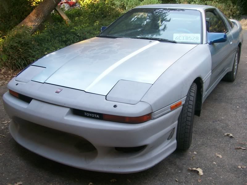

now that I've seen it in person I definately have to say it looks like it's gonna be pretty damn nice.
